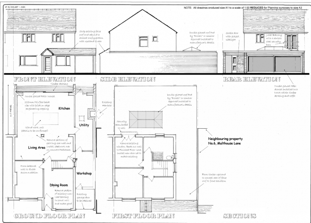

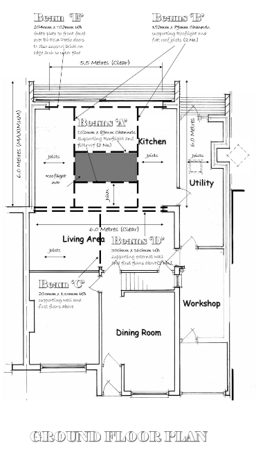

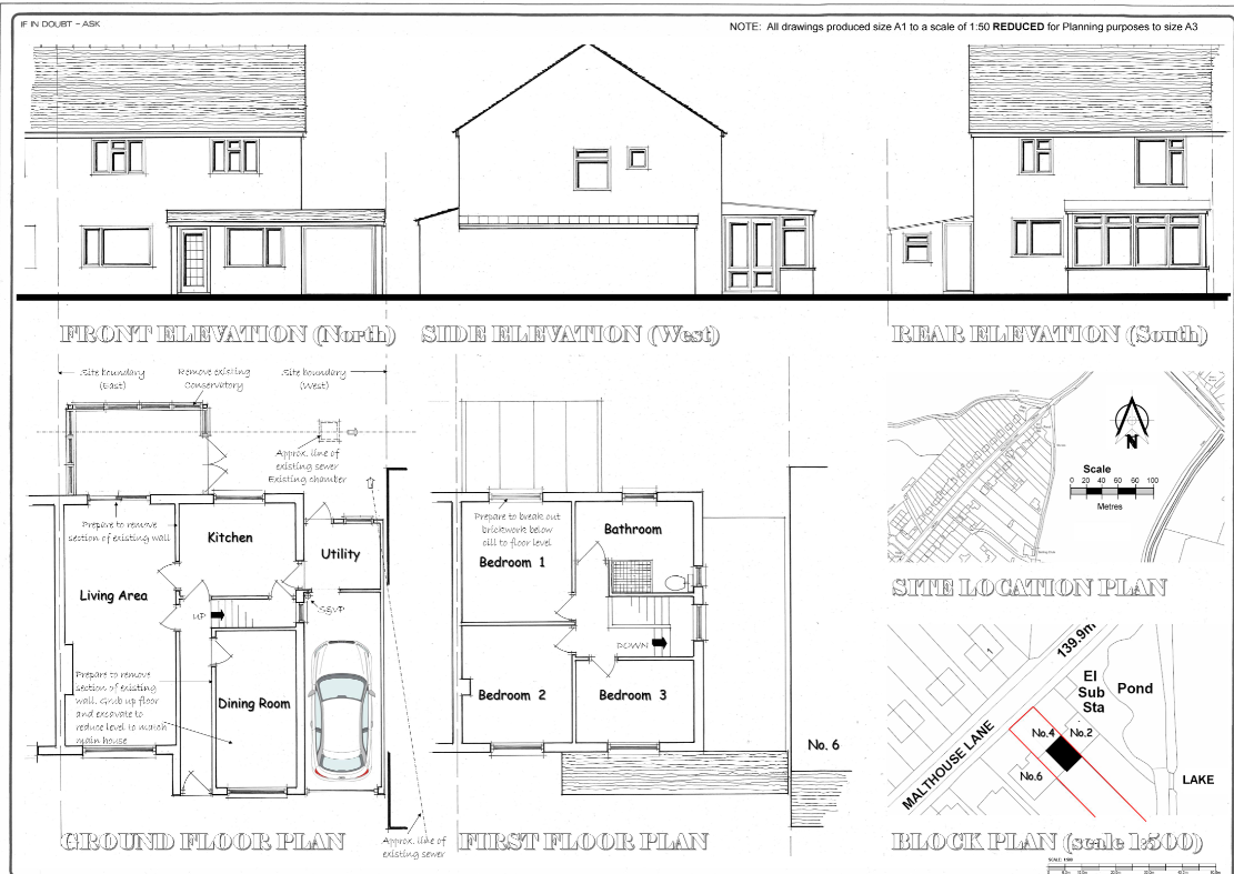

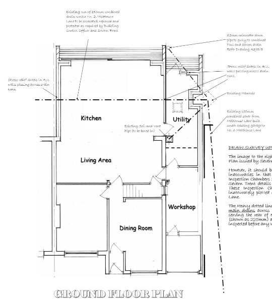

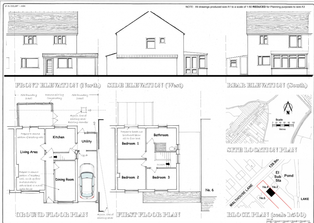

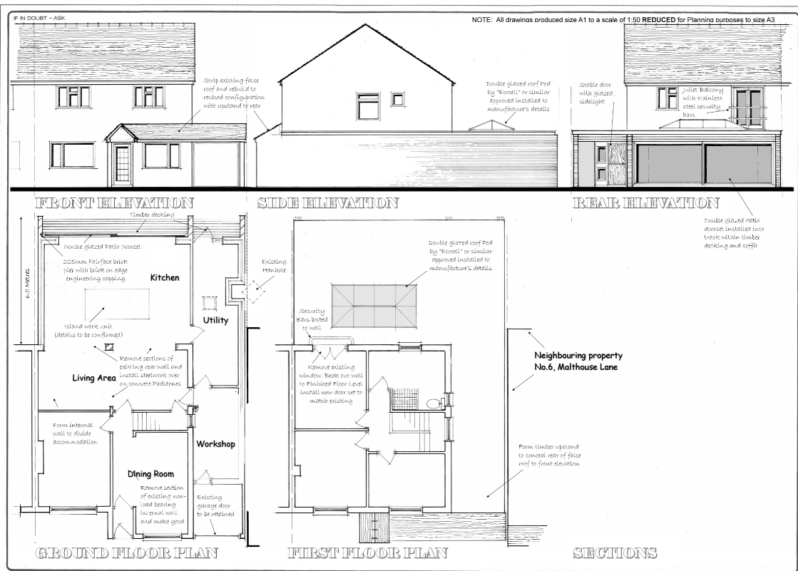

Below are some snippets of the approved plans, drainage and steel drawings. Our architect is fairly old school and does all of the drawings by hand which is pretty impressive when I spend my days looking through CAD.
