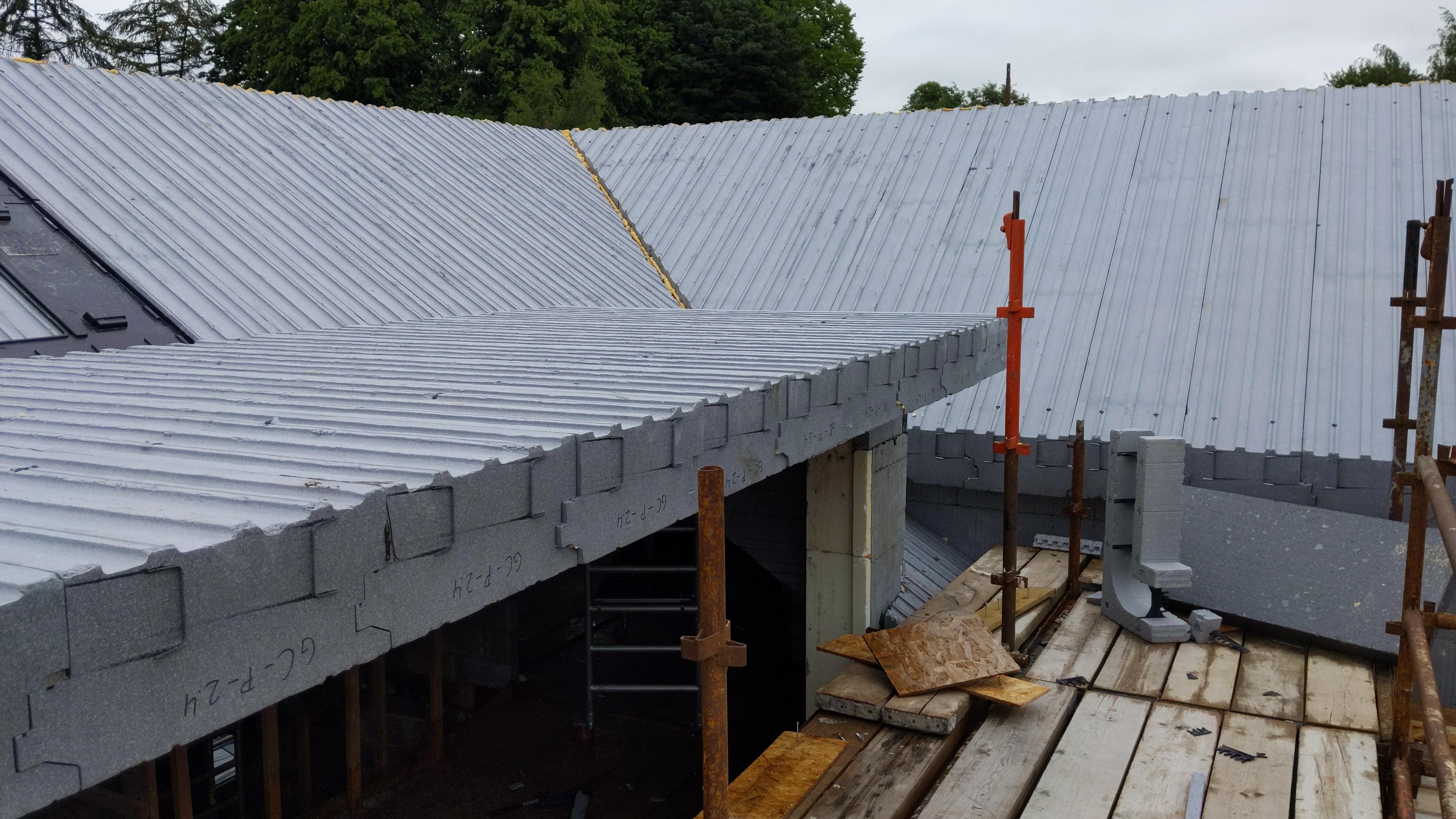

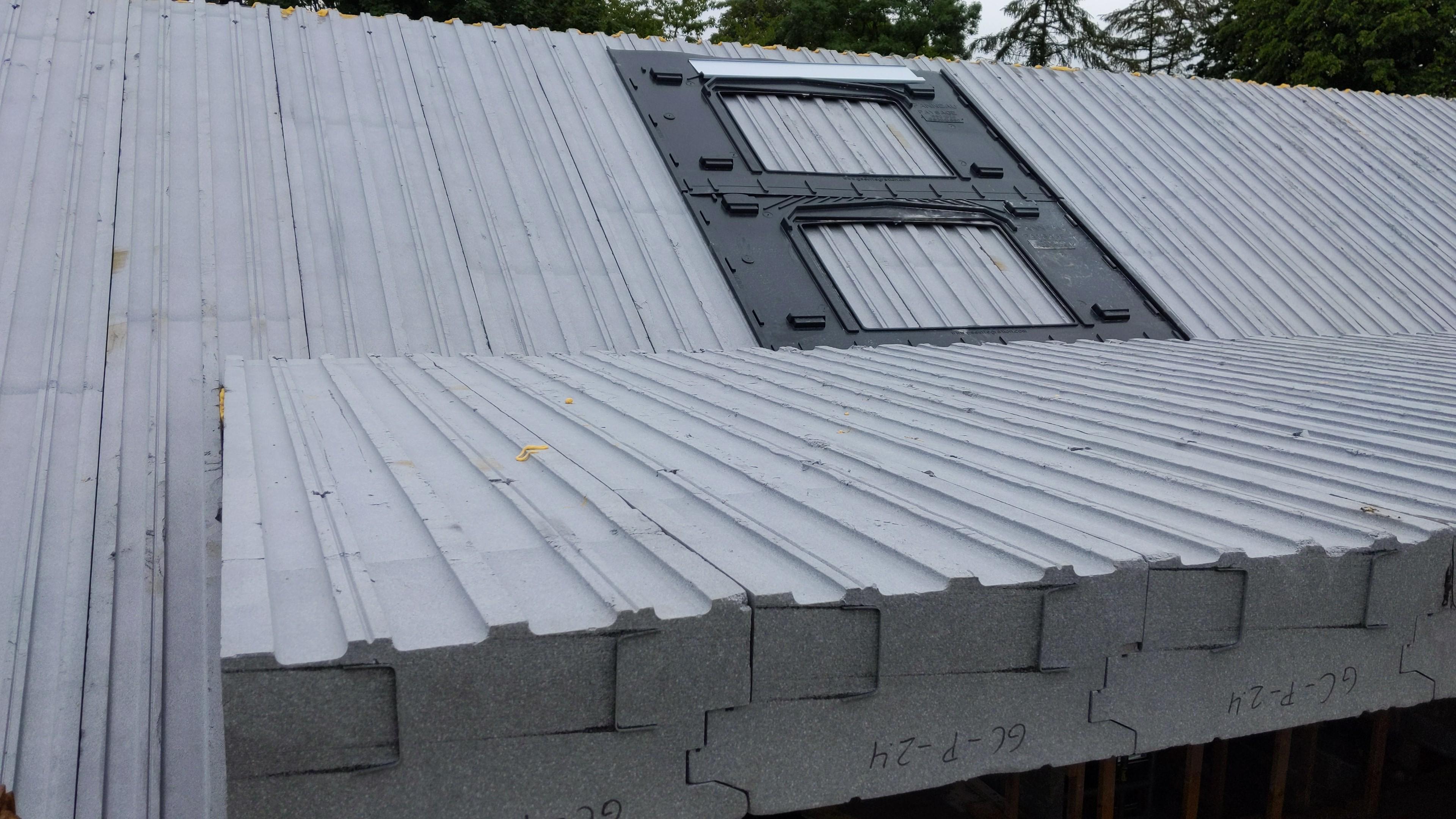

We have our thermohouse panels installed for the flat roof:

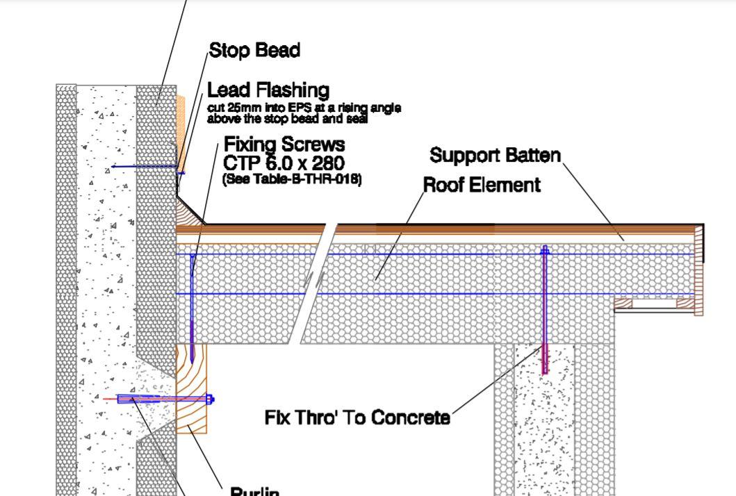

Here is their basic detail for a typical flat roof, but doesn't show how the void is ventilated:
I spoke to them and they recommend soffit ventilation to stop the batons/firring strips from rotting. We want a minimal detail with render right up to the 90mm drip flashing, so I'm not sure how to achieve this... if it's even needed?
