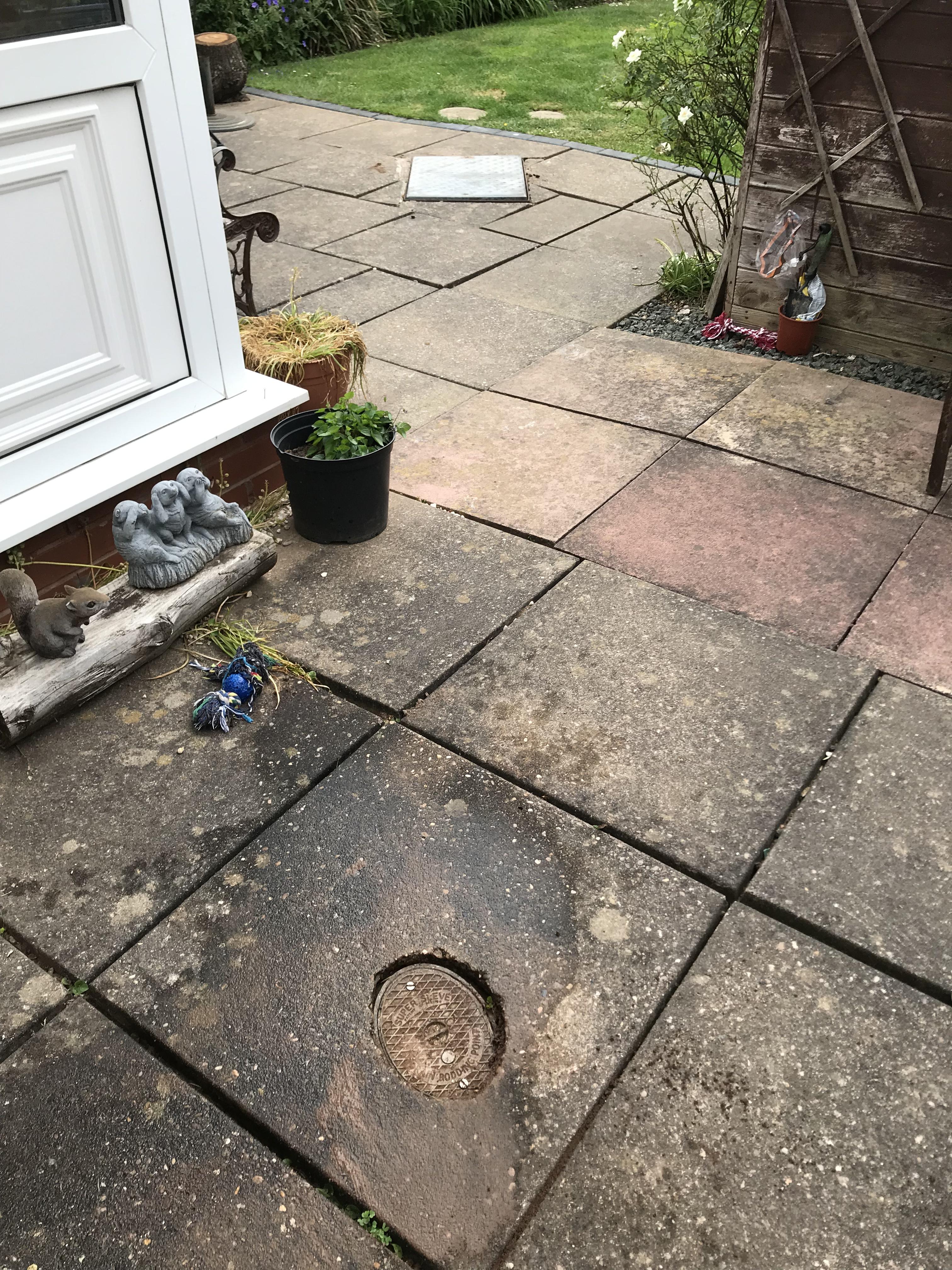

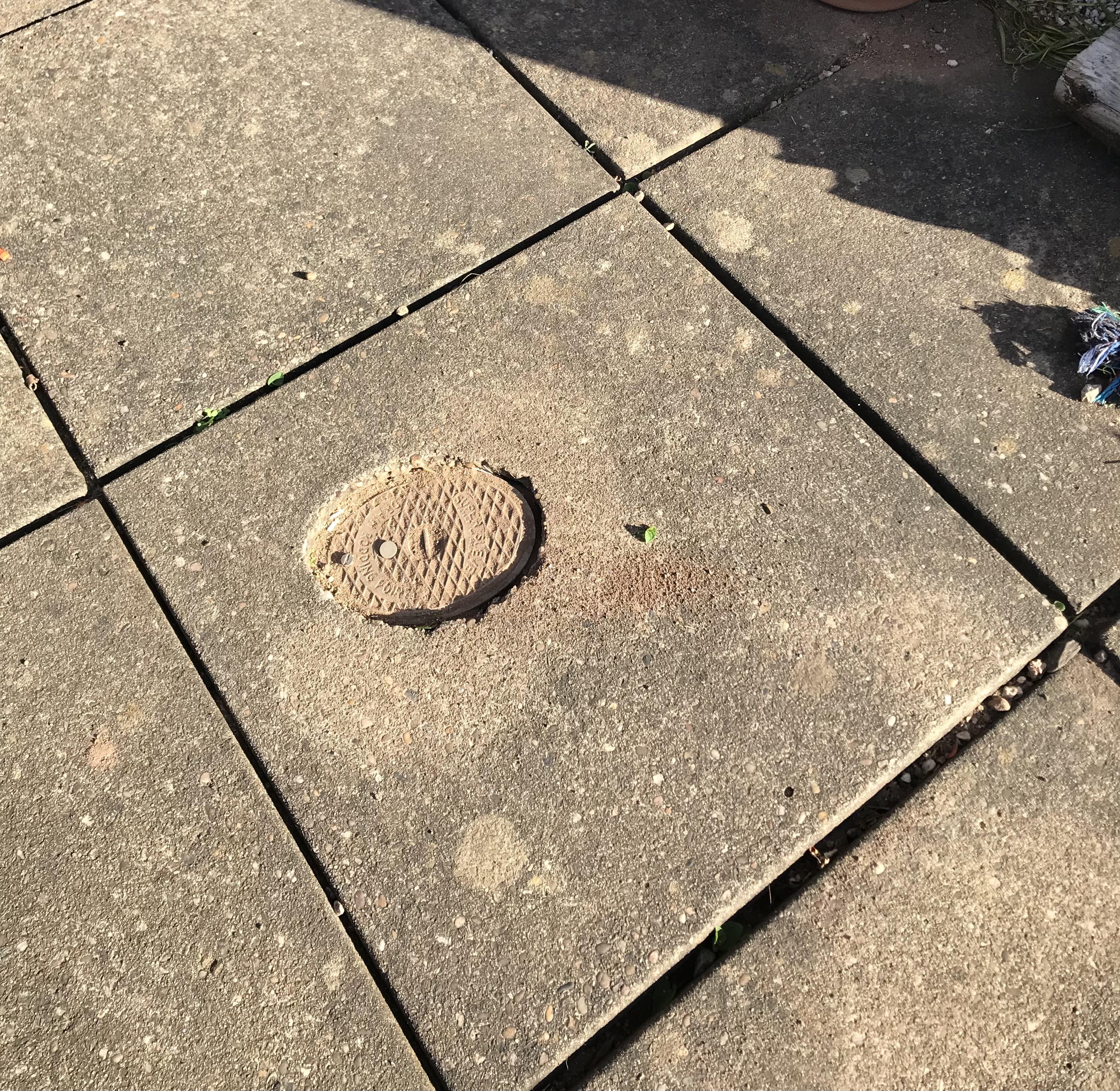

I have a rodding point in my patio, which is about to be relaid - see attached.
I want to run my washing machine and basin waste from the utility, no toilet waste, into a new outside waste gulley and connect to the rodding point by using a 45 (y piece) degree connector, keeping the rodding point accessible within the new patio.
Would this be a permitted practise?
Thanks in advance
Is it definitely a foul sewer rodding eye?
If it is, then that is fine.
If it's a surface water sewer then no, not allowed.
George, thanks.
Am still trying to work that one out!
There is a foul sewer manhole several meters away, which receives our foul waste.
Have tried a hose down the rodding point, but water does not flow into the manhole chamber.
Am trusting the council or a drainage specialist would be able to advise?
i reckon that is a surface water rodding point, still seems an odd location tho
