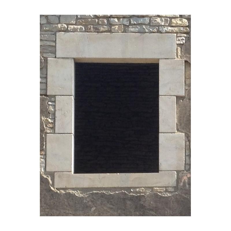

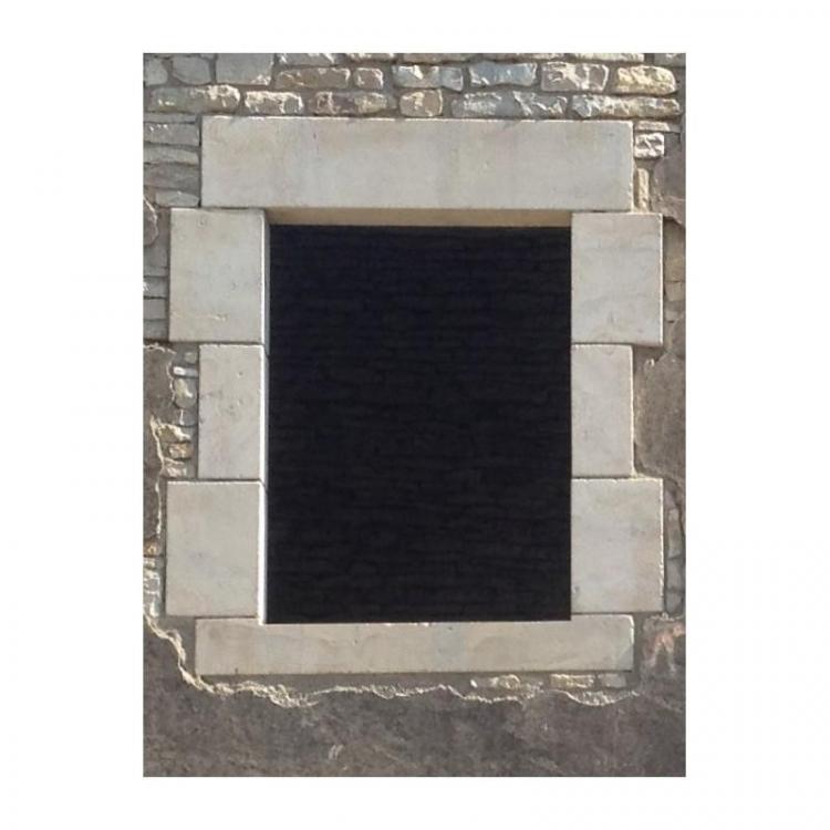

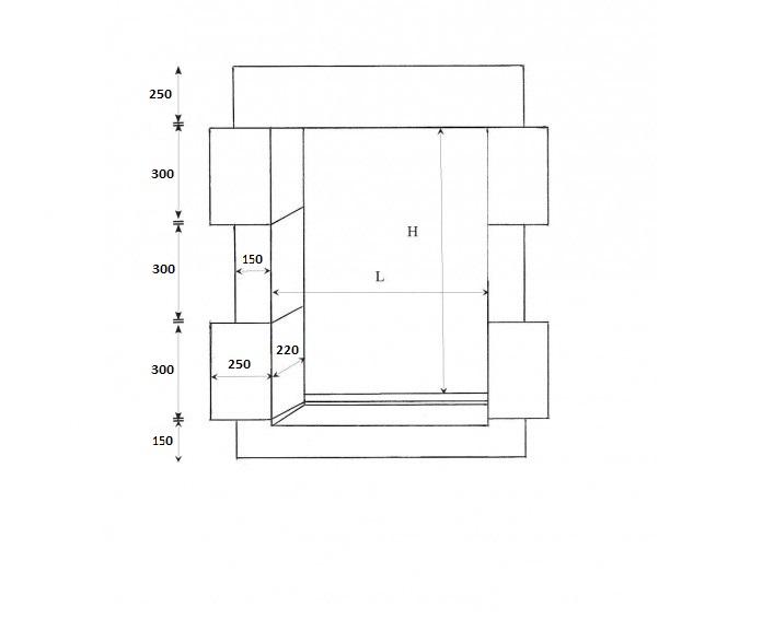

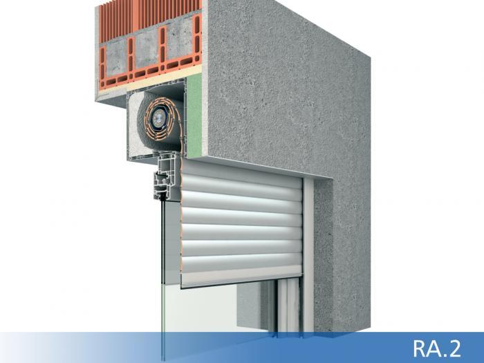

I am taking on the project to help them out and to make a change, right now I am in the process of ordering the stone window surrounding set so it's ready for next week. I've talked thing out with my parent and we are looking to integrate the security roller shutter in the tight space behind the stone head of the window set so that box doesn't appear ugly. we are also planning to put a tilt & turn aluminium window in the two opening and put in a lintel above the 180 x 180mm shutter box. I was thinking of replacing the timber lintel to a steel beam with 200mm end bearing on each side.

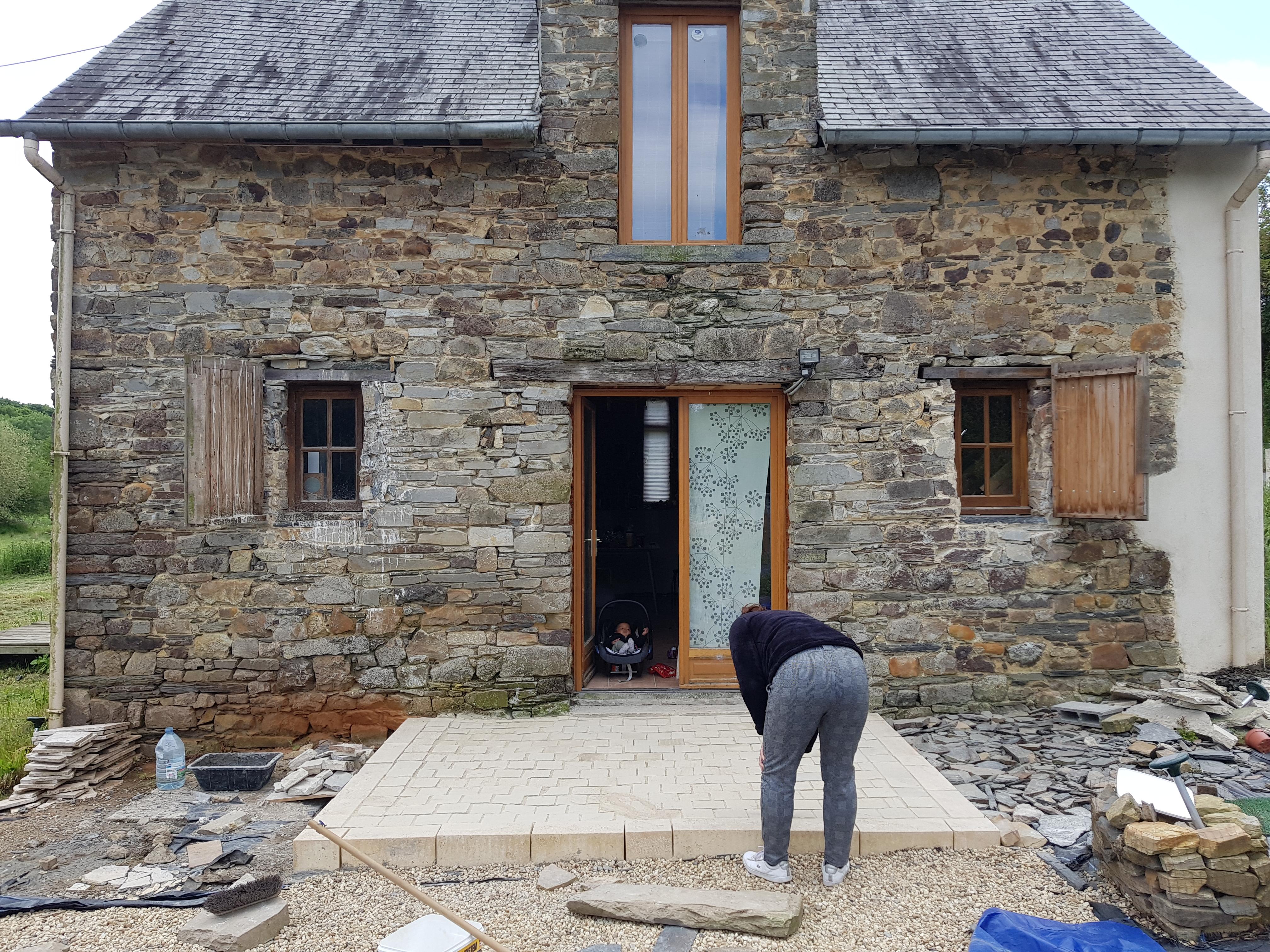

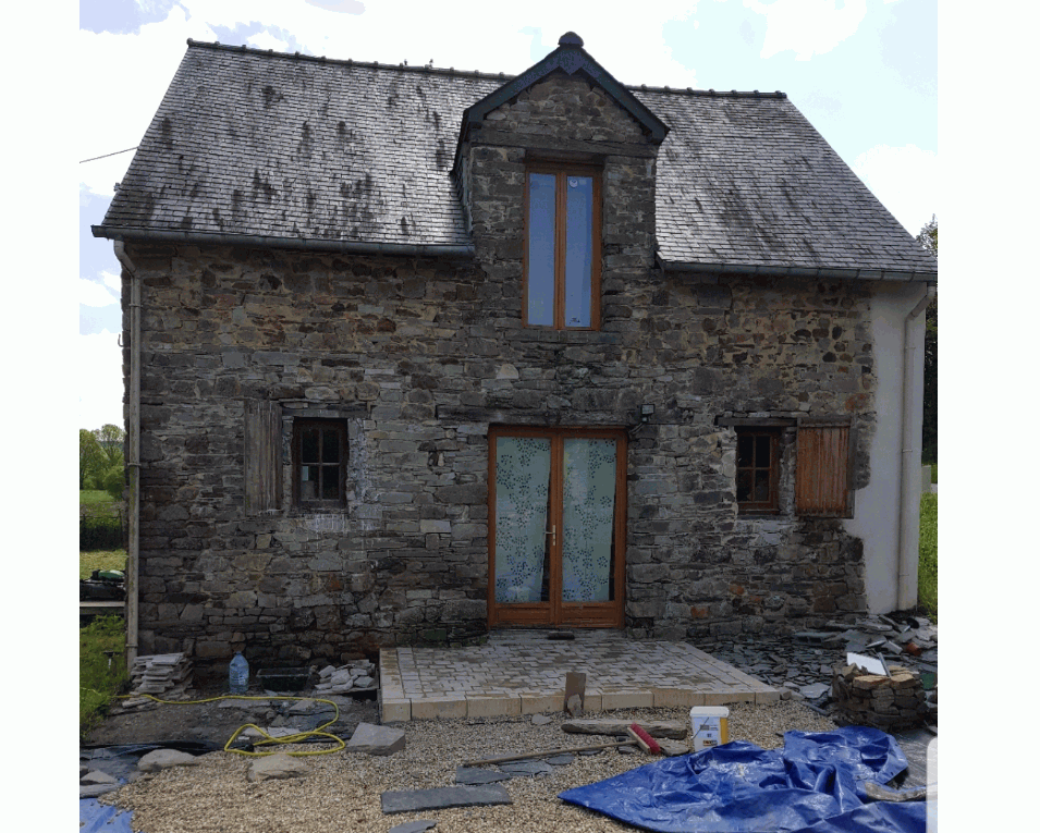

Masonry height: 2m above, has roof load and floor joist bearing (2 storey)
I will leave photos of the natural window surrounding set plan and a few photos of the 2-storey house.
