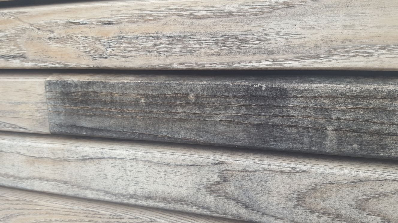

here's a close-up image, which indicates to me the problem is specific to the board as you can clearly see one board worse than the other -

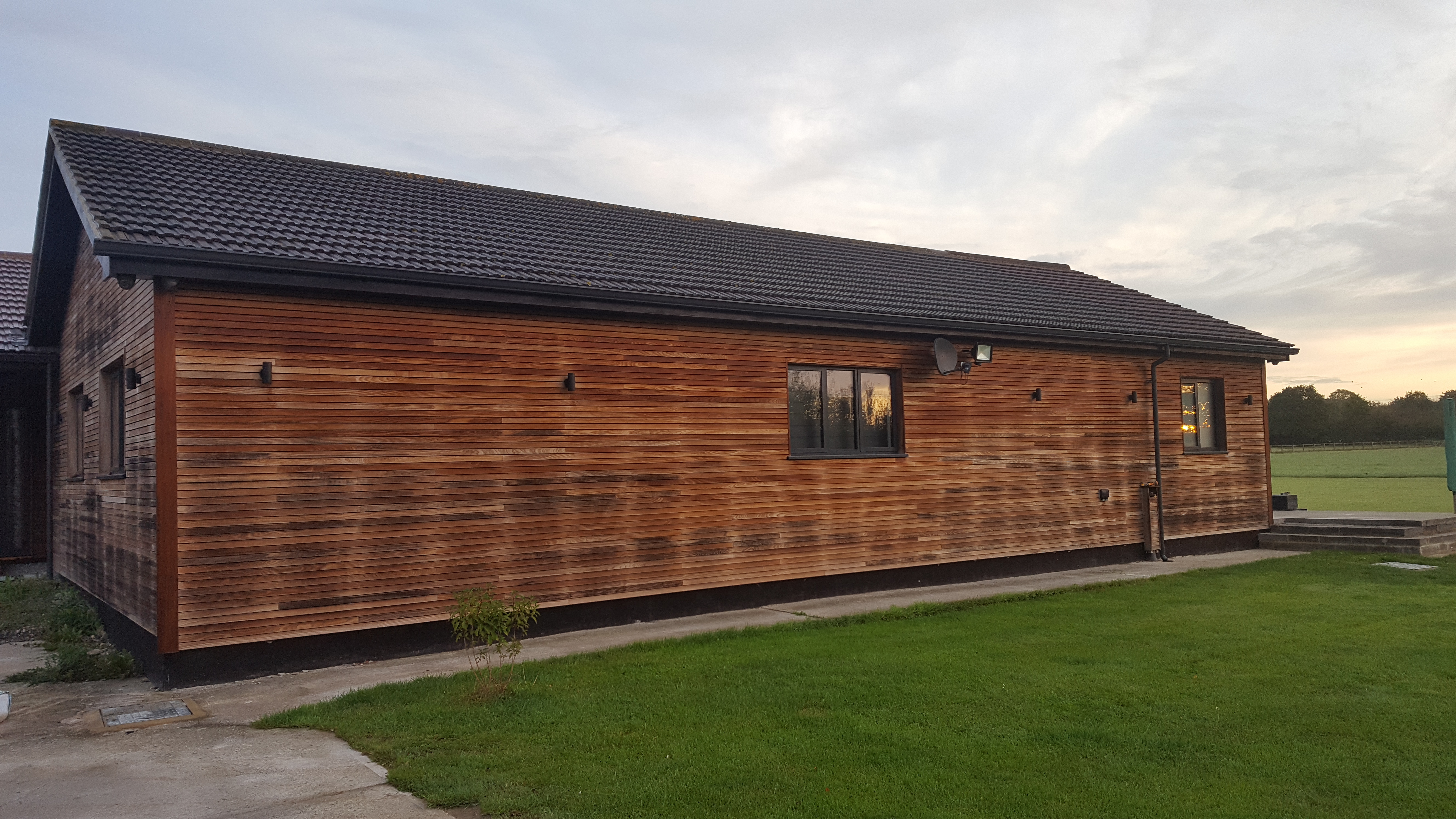

The image shows the west elevation but the worst is the south elevation (to the right of the image). It's a problem 360 deg around the house. see below image of south elevation. This was taken a while ago. It's now a whole load worse -

This is an image showing the problem. Doesn't look like the images on their web site, does it? Also, in some areas there is growth but to specific strips of wood only, which logically tells me that some of the wood is resistant and some is not -

At significant expense (£34k just for materials) I have installed a product called Thermoash otherwise known as Hotwood; it's ash that has been treated under pressure to give it Class 1 durability. The product is sold as being virtually indestructible (maintenance free, resistant to rot, cracking, warping, etc). It's basically a form of real wood rainscreen. It sits on plastic clips fixed to battens 25mm from the building wall surface (the building is wrapped in a special version of Tyvek) and it is supposed to add to the thermal efficiency, etc, of the building. After a year since installation I'm seeing mould appear on it and also a difference between the battens. The manufacturer (Carpentier from Belgium) blamed me saying the installation was incorrect but that's simply not the case and after I showed them the installation was good they since refused to accept any responsibility. Then they told me to clean it regularly; what happened to 'maintenance free' ? I'm now left with a horrible looking rain screen. Does anyone have any experience with this problem and how to fix it?
