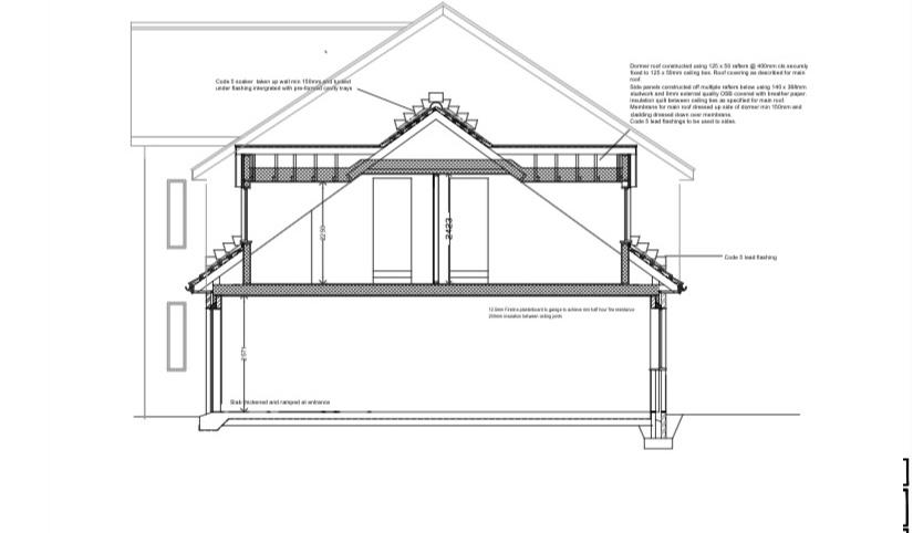

I think that I will just be better off keeping the garage outside of the thermal envelope, leaving out the insulation in the floor and screed layer. That way i could always add it in and put UFH coils in the screed at a later date. On a plus side, I also get a bit more head space in the garage from the insulation and screed that was planned for the floor. I’ll still be insulating all of the walls and ceiling though
I will also be having a log burner at the other end of the house so I was contemplating whether or not the UFH for just the garage could be connected to this but I don’t think it could due to its distance from the garage (13m). if I could this would be perfect as I’d only want the garage heated in winter when the log burner is lit. However I really can’t see any feasibility in getting this to work due to the above.
@JohnMo and @Conor the floor will have 200mm of insulation on top of a raft foundation with UFH in 50-70mm of screed. The walls will likely be 200mm full fill mineral wool batts. I agree that it’s going to cost a lot to heat but I don’t want to regret not doing it especially as I may find an alternative way to heat it (if funds allow, such as solar thermal). Like Conor said, it could potentially be converted at a later date to habitable space so I want to make sure that I make wise decisions rather than regret in action. The ceiling of the garage will be very well insulated and plan was to keep it separate (other than the foundations). I know it will never be as warm as the rest of the house, nor does it need to be. I have at least two cars that are used daily and will likely bring a bit of heat to the garage once parked.
I have a large attached garage in my plans and I will be looking to lay my best in the new year. I have toyed with the idea of leaving it unheated however it will negatively affect the heating of the house as above the garage are two walk in wardrobes from two of the master bedrooms. I’m still trying to decide whether or not to lay under floor heating pipes in the screed to match the rest of the house. Are there any UFH manifolds that you can safely switch off a loop long term? i’m not even sure how I would feed it heat yet but I will have solar PV but I wouldn’t be adverse to fitting solar thermal later on down the line on the south facing roof of the dormer. what are peoples opinions on my options? And would you add the pipes in anyway - even with them potentially never being used? I’d guard to look back and not fitted a few hundred quid worth of pipe that could have been really useful. roof space isn’t an issue, I should have plenty even for the tallest of cars.

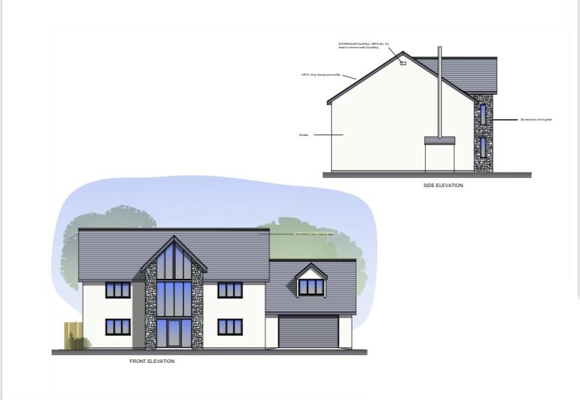

@joe90 I’ve probably not explained it as well I’d hoped, essentially I’m looking for full fill to stop the air movement, make it easier to build and more cost effective. My issue isn’t that I could pass building regs with 150mm cavity of full filled mineral wool batt insulation. The issue I have is that if I built it to this spec it would mean that I couldn’t get a structural warranty through NHBC due to them not allowing full fill insulation on fair faced masonry in an area of very severe driven rain. Im trying to work out how I should compromise, whether that means changing my plans and use another form of insulation or slightly change my plans in that part of the building to a different cavity setup. This will be my first self build so it’s all a learning curve to me. could the block work behind the stone be wrapped in a membrane like timber frames are done? That way it wouldn’t be classed as fair face masonry as there’s a water barrier (I presume)
@Redoctober no I hadn’t seen that before that is interesting! I can’t imaging it works with mineral wool batts but it could be a good compromise on that part of the house! @joe90 thanks for the tip👍 @Redbeard I’d considered it but I think that MWB would be cheaper. I’m now thinking that the part of the house where the glass gable is located can’t be full fill so it will probably be easier to treat this an extension and give it a larger cavity (maybe an extra 50mm) than the rest of the house to maintain the same levels of insulation but allow for a cavity of 50mm. Does this sound logical or am I missing something?

Thanks for the reply Joe, are you also in an area of very severe driven rain? And did you get a structural warranty? Currently feeling that I’m out of my depth with the wall makeup and floor insulations. I had planned on getting an insulated raft however I’m now going to go for a standard raft with insulation and screen on top. This is purely down to not being able to find anyone willing (or reasonably priced) to do it.
Im soon to be starting my new house build. It is going to block, cavity, block design with a 150mm cavity space. hoping to use a 150mm mineral wool batt full fill, my house design will be rendered however I have two columns faced in natural stone that I believe would count as ‘fair faced’, does this mean that I can’t use 150mm mineral wool batts? If the natural stone will count as fair faced is there anyway to make it not fair faced with a stone facad over the top? I have yet to get the foundation and structural designs finalised so can make adjustments if necessary to allow for a bigger cavity, I really want to use full fill Mineral wool batts due to cost, ease of build and air tightness. I live in an area of very severe driven rain so I’m looking at ways to do it that won’t affect potential warranties later on down the line. Home will be as airtight as I can make it with underfloor heating and MVHR.
