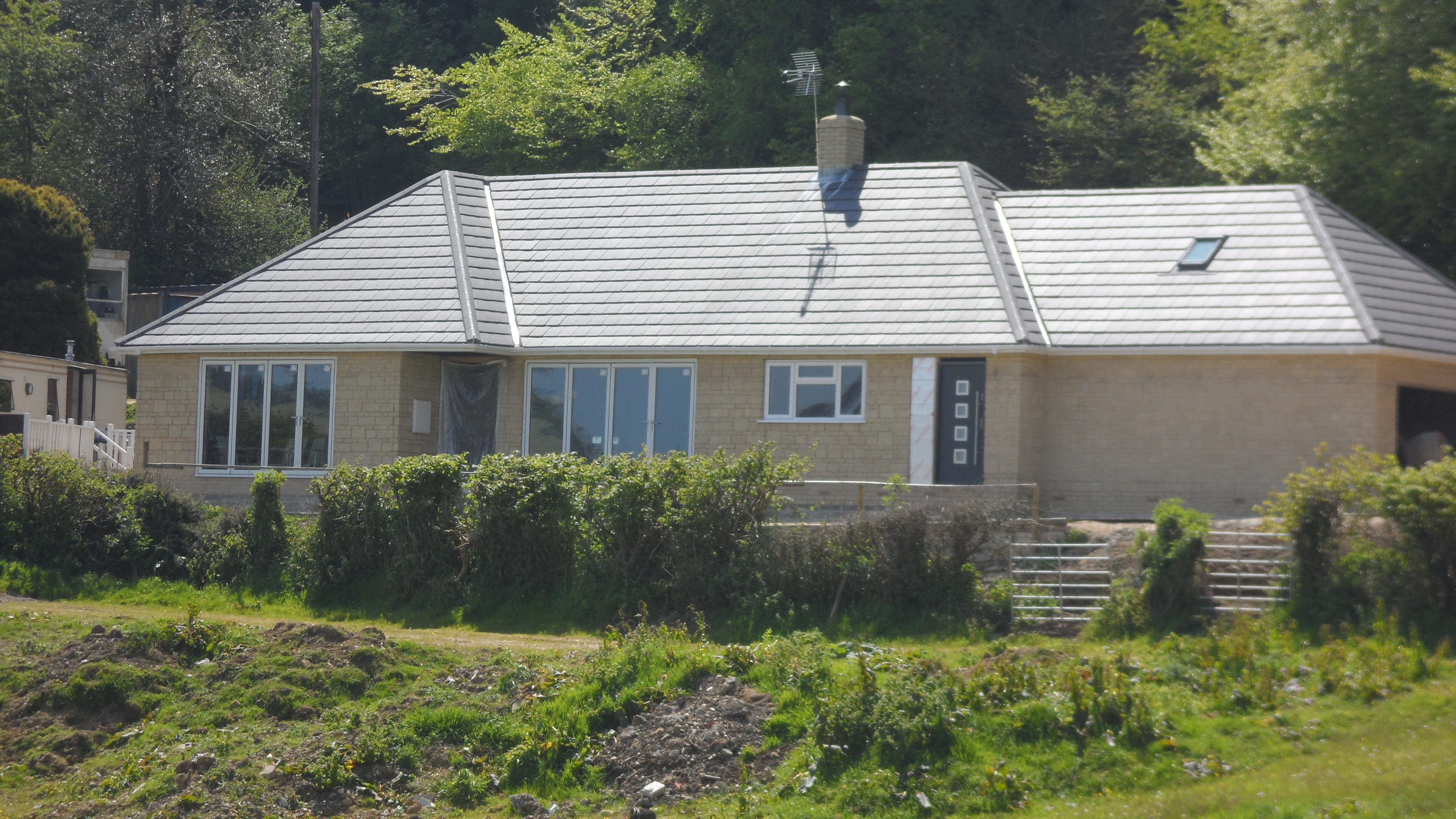

Hi all. I think my title states my issues, that this months ASHP KWH consumption costs are becoming a joke. I thought I would check with the forum and users who support this technology as to whether mine is the norm or I am missing something in running efficiently. Bit of background. I built the 155sq Mtr + garage 3 bedroom bungalow using traditional material over past 8 years and mostly myself. Exposed country location, block beam floor + screed + tiled, brick outside, cavity therm walls insulated, therm walls throughout, d/glazed throughout, tiled pitched roof, intergal garage (36 sq mtrs) good helping of insulation to floor, wall roof etc. An MCS registered company designed and supplied me with all the material to install Daikin Altherma 7KW ASHP, UFH with stat to every room + Daikin 300ltre hot water tank. Which I did with controls in garage area. This company never visited the final install, but have to say their drawings, telephone and install support was excellent. Daikin attended, were positive about the install and set it all up in 2018. Since then except for a main PCB/fan failure it is left to run 7 x 24 with just Daikin annual maintenance. Since instalation and living in the property past 3 years my annual KWH consumption for whole has been in excess of 14500 P.Annum but unable to accurately know how much the system was consuming. Hot water set to 48 deg, most rooms and hallway are set to 20 deg except for spouse main bedroom at 22 deg (she is disalbed with serious heart condition so need that heat). I don't fiddle with it or alter the stats and it runs 24 x 7 year round. November 22 I fitted a consumption meter to the electric feed tails that supply the ASHP, Immersion and its logic. I can now accuratly check its KW consumption. Accepting November it began to get colder the system average consumption showed 24 KWH per day. Dec we have seen it cold past 10 days being -4 to -7 so the system has been flat out 24 x 7 some of it defrost time. It has managed to meet the stat settins but the electric consumption during these days has been frightening. Yesterday 14th Dec being -7 outside it consumed 75 KWH Yes its a cold snap, but his technology is encouraged around UK but mine doesn't perform. Meanwhile I have since shut down two areas and dropped 4 of room stats a degree to see if it drops electric consumption difference. I know there are members out there that love all this stuff so feedback welcomed. I can access the Daikin control panel in installer mode but no expert. G H Direct

Hi all. Are their members that have a Daikin Altherma 7KW Monoblock ASHP installed in a new build and does it work? Passed days cold spell has generated the following major concern, enough for me to seek other members opinion towards this heating solution. Intro Past 4 years I have personally been building our 3 bed detached retirement bungalow and currently working on the inside. Its not passive build but when 100% complete will have above average insulation. Country location only water and electricity so after much discussion with many suppliers a Daikin ASHP, Hot Water Tank and Underfloor heating solution was designed by an MCS accredited supplier who were happy to supply all items, for me to install it to their supplied drawings and Daiken manuals with final commissioning through them from a Daikin engineer. As an experienced engineer myself with time on my side I am confident I have installed it all to spec accept setting it's performance up "exactly" is painful as the Daikin installation books are poor although Youtube has some installer controller setup detail. Although it has yet to be fully commissioned it did/does function but with the following performance issue. Issue ASHP was turned on late September with outside was around 14deg C, it worked great, I was impressed with its UFH performance heating the floor space to over 24 C quickly. I worked out how to introduce the Hot Water System, set time clocks to run 8 hr days, room stats around 14 Deg C whilst I worked inside the property. Then October we had a cold spell and basically it just stalled, ASHP sitting doing its thing gobbling 9 amps but giving very little heat output. Ran like that day after day. Past few days it been very cold here so same issue. After checking all my installation plus powering on/off etc found nothing obvious, so rang the design company who in conversation suggested that because the outside temp was below 10deg C the Daikin ASHP can go to sleep until its circulating water is above 10deg C. Is this true of a Daikin ASHP there is nothing in any manual that refers to this? Apparently to kick start it back up, you have to use the immersion system leave the ASHP system circulating water and wait till it all gets warm enough for it to kick in. I await its commissioning in coming weeks but meanwhile need some existing users performance feedback.
