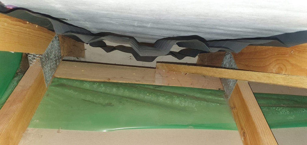

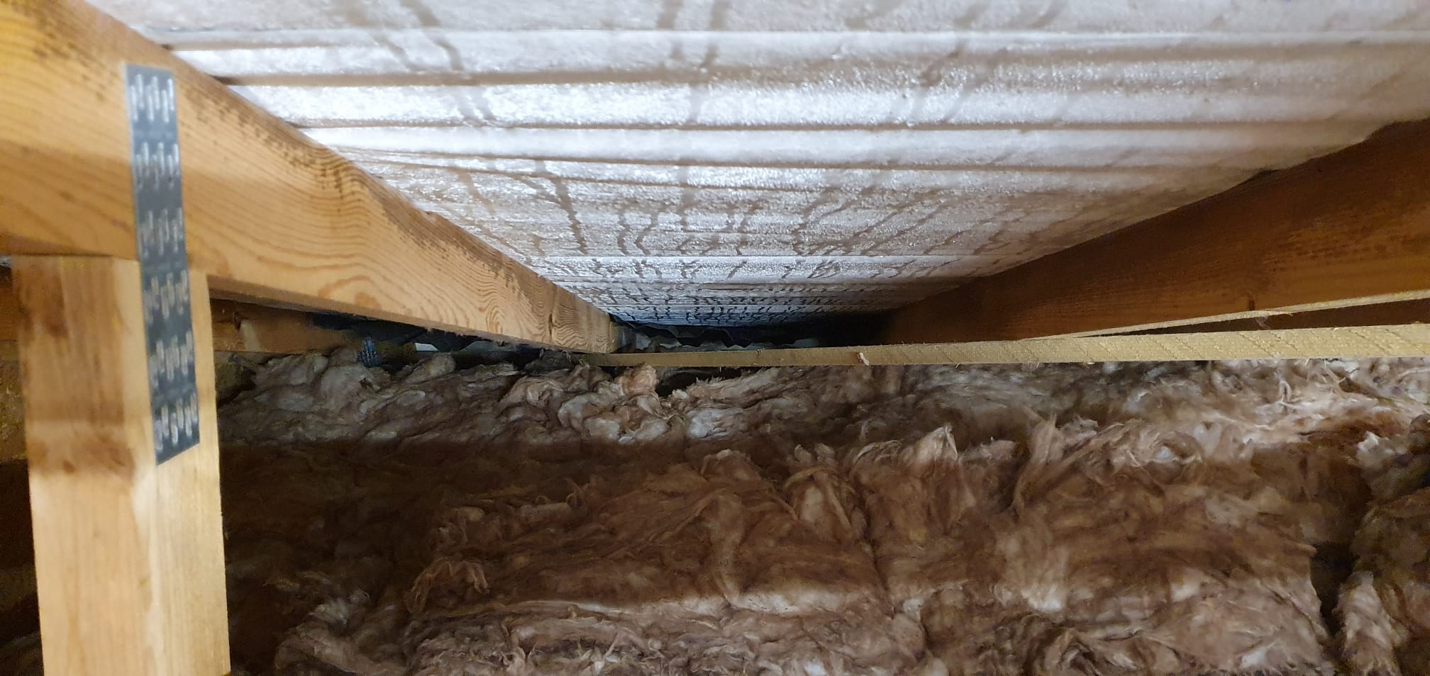

  1. I thought I would update this thread. So, after the cold spell the condensation on the felt did disappear. I'm not changing to rigid board insulation, maybe that was a mad plan! I have also installed 50 felt vents, which should help! The other thing I didn't mention was mould on the ceilings in the rooms against the external walls (only those being slept in and not the gable ends). I believe this is because the vapour barrier behind the walls is folded to be above the ceiling. That happens to be where the least insulation is too! Seeing the attached pics, you can see how wet it is under the green plastic (even with the warm winter weather). Is this just lazy builders doing that? Either way, I've cut back the plastic as per the second pic.

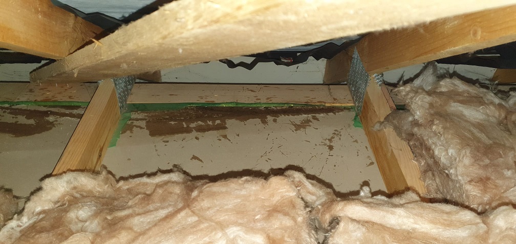

  4. Thanks for the replies. I've attached a pic how the insulation was before I pulled it back. I don't really think it was blocking the vents at the eves anyway. If I did use rigid insulation, should there be a plastic membrane underneath against the plasterboard? My thinking was it would give better insulation at the edges to stop cold bridging to the rooms below. Also, I think the extractors connecting to the loft haven't helped, so I might connect them to the soffits again. I'm not sure how a 100mm pipe will fit into a cut in the soffits, as I'm sure it's not even 100mm wide. Or is leaving this loose in the soffits ok? Also to add, in the pic you can see where the wood is stained. I'm guessing this isn't the first time this has happened:
  5. Hi All, after getting the xmas decs down the other week I noticed the loft has a huge amount of condensation on the felt. The house is a 2017 new build, and I installed loft zone flooring in the centre two years ago with adequate ventilation under the floor. Slightly worried, I decided to pull back the insulation at the eves to ensure adequate ventilation (it wasn't bad in the first place). I did check the soffits, and they are the vented type with a grille along the entire length. Is this common, or shouldn't there be any condensation at all? The other thing I did at the start of the year, is connect the bathroom and ensuite fans to the roof vents (rather than going into the soffits - it was just left loose a blowing in there). This was because of a failed extractor, so installed inline fans which are brilliant at getting rid of steam from showers! However, on noticing the condensation I've disconnected one of the pipes, so it is sucking air out of the loft to try and dry it. Which is helping a bit, but still wet after a week. I have asked around, and quite a few people I know (not on our estate) have wet lofts due to the very cold, and non-windy conditions. I'm really just after your opinion if this is a problem? Secondly, I think I've decided to strip out some of the loose insulation and put rigid board insulation (80mm or 100mm) at the eves to stop cold-bridging to the rooms below (as we've had some mould at the edges in the bedrooms that are slept in). Is this a good idea? Thanks!
