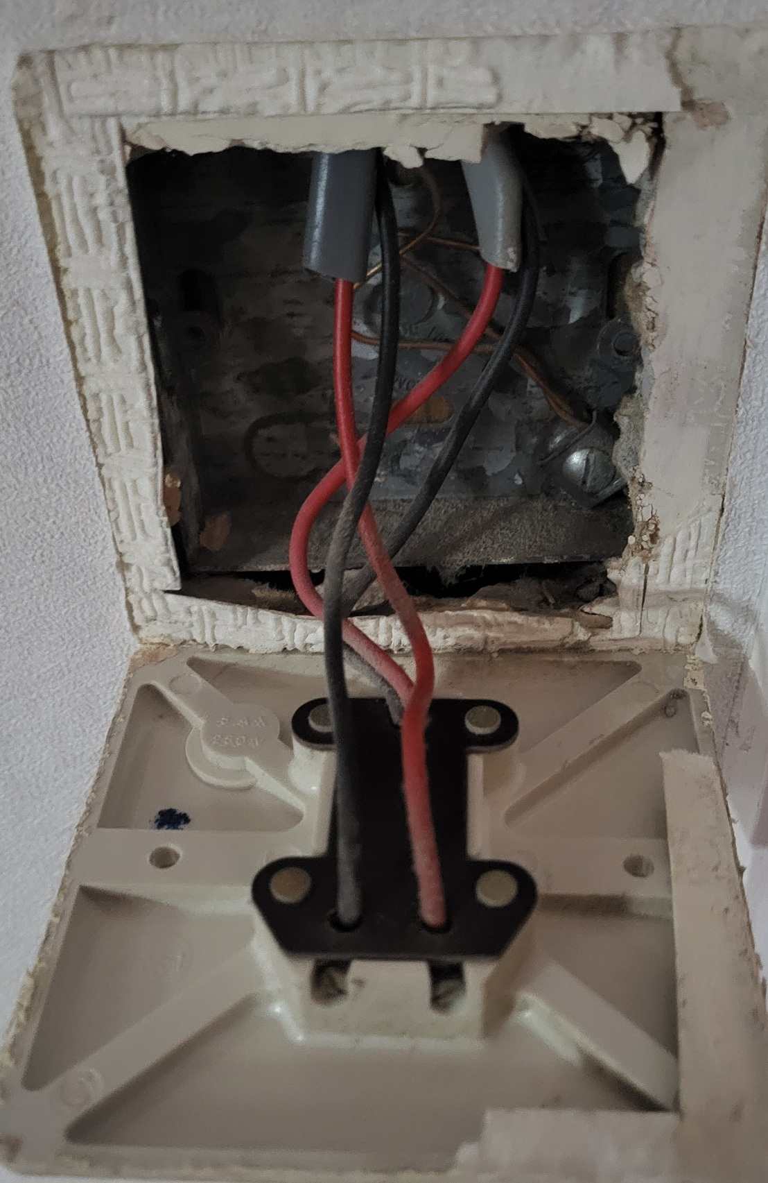

  2. I cut through the boards and insulation in the loft this morning to look at the wiring to the landing light pendant. There is a ring that goes in and out with the light bulb connected to the neutral. There's a third twin and earth with both red and black going to the light bulb live. This appears to go to the landing light switch common. The landing light switch S1 and S2 are wired to the stairs light switch S1 and S2. Would I be right to separate the ring from the landing light, then take a neutral from the hall pendant up into the loft and connect that to the landing light?

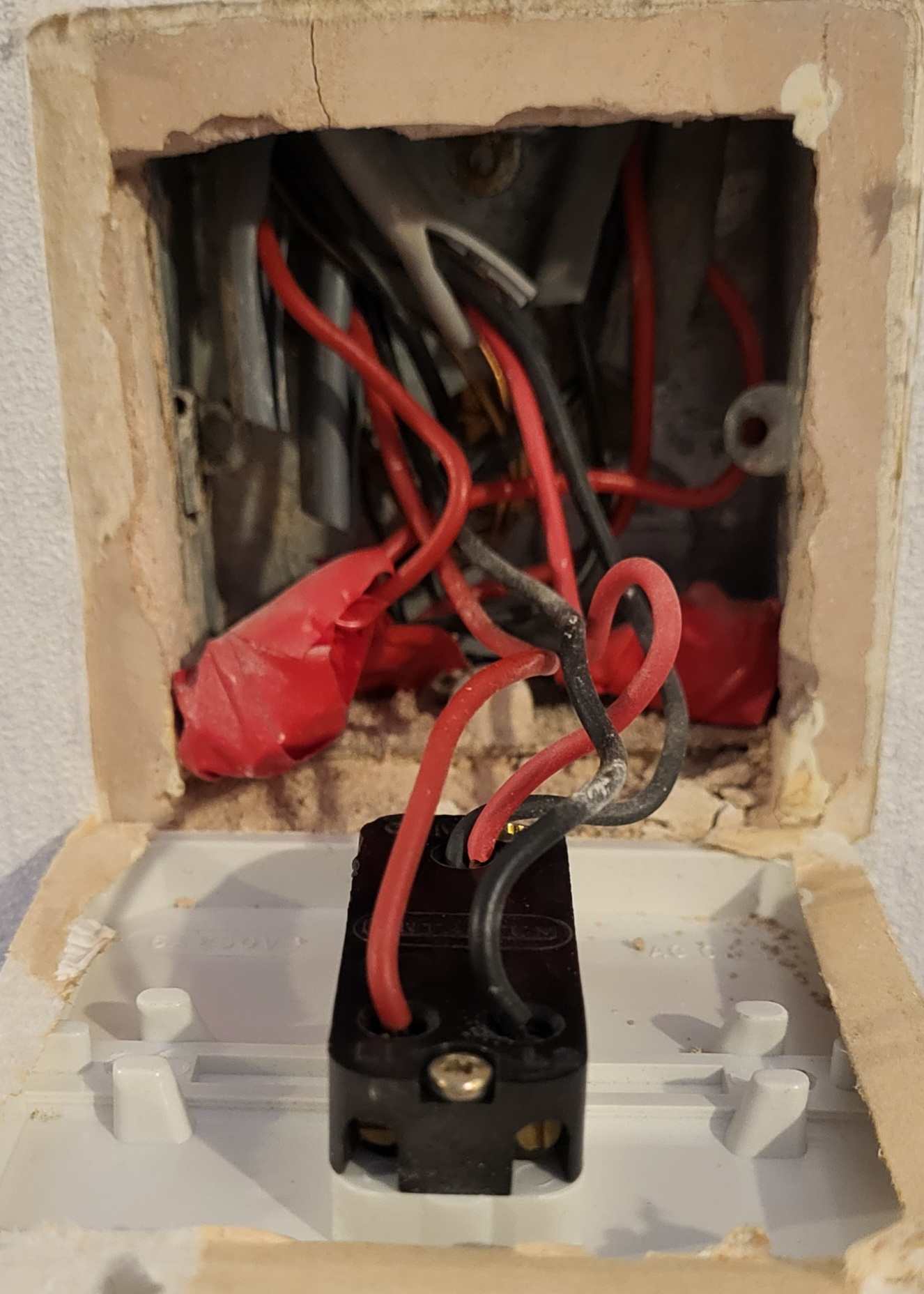

  4. The third switch is by the front door and is for the hall light. The common on this switch is connected to both the red and black of a twin and earth. The common on both the switches at the bottom of the stairs is connected to both the red and black of a twin and earth. I take it this is common practice if you really just want a single wire. So if you wanted to connect all three terminals of two switches, you'd connect red to S1 and black to S2 of both switches, then have a 2nd T&E and connect both red and black to the common of both switches.

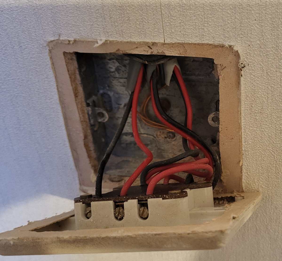

  5. This is the upstairs switch. All as expected. This is at the bottom of the stairs. Left switch is the landing light. Right switch is the hall light. Back left terminal is live and neutral from the RH twin and earth, plus live from the front right terminal. Front left and centre are N and L to the upstairs switch. this is the mother load of 5 twin and earth with PVC tape and everything. The ceiling rose just has red, black and earth coming into it.

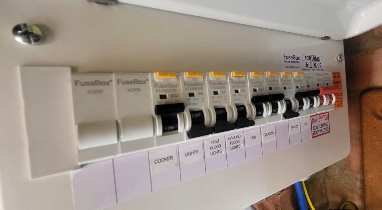

  8. The landing light is a culprit. With the bulb removed, the lighting circuits stay on. I've had all the downstairs lights on and off and it seems stable. Anyway, I've had the cover off the board and found that the unlabelled way is used and is for the sockets in the front rooms. With the bulb in but switched off, the socket circuit for the front room trips. What's that a sign of?

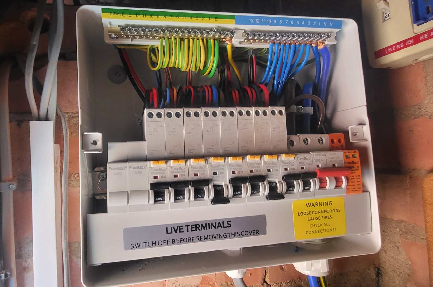

  10. It is the MCB that is tripping, not the RCD. There are decorators in at the moment so don't want to knock the power off to remove the cover. I'll do it later when they're done. This is the new board from the outside.
  11. We're coming to the end of having an extension built. Their electrician has wired it all in but said he cannot sign it off unless we have him replace the fuse board with RCDs at an additional cost. We agreed and he did it on Friday. On Saturday, we found that the sockets at the front of the house have no power and the circuit he labelled as downstairs lights is tripped and won't reset. His reply to my email asking about this was more or less '£90 per hour to fault find, min 4 hours'. With all the lights off, if I reset the RCD for the faulty light circuit, the other light circuit trips as well. For the sockets, there is only 1 circuit labelled on the box. All the sockets in the back rooms are good. All the ones in the front rooms are off. This seems odd to me. I wonder if the spare way on the board is the other sockets and he's not labelled it. That RCD won't reset. I'm an electronics engineer, though not an electrician. I'm safe to disconnect things and reconnect them. So what's a good procedure to track down where the fault is?
