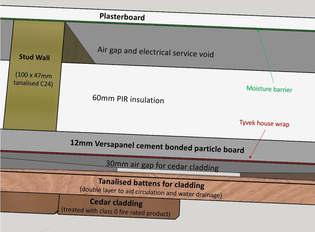

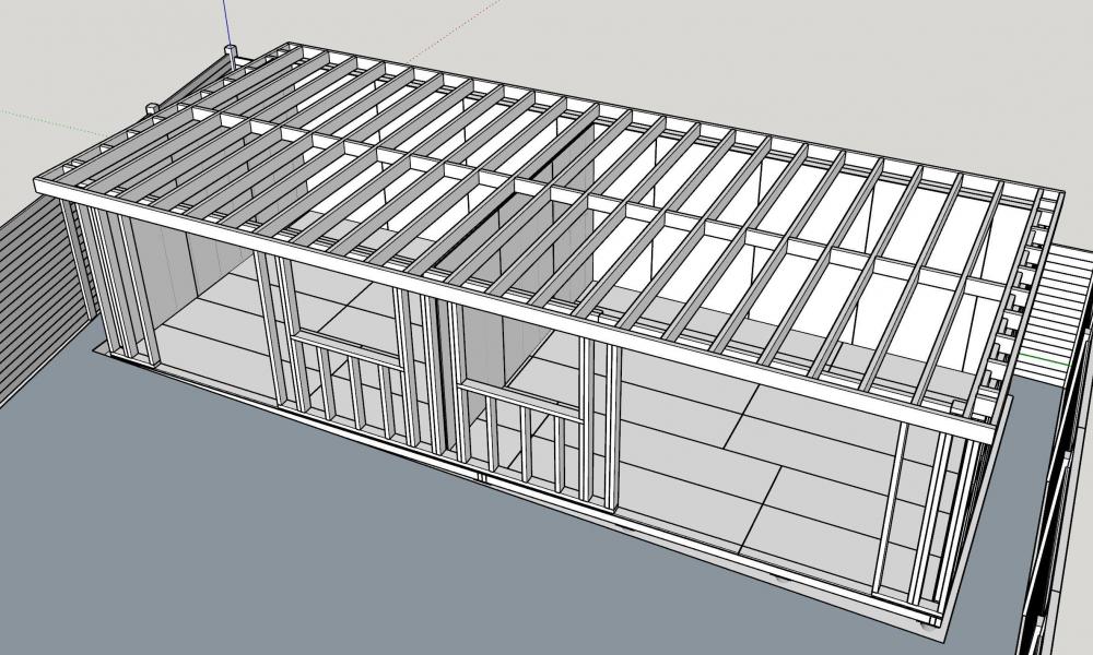

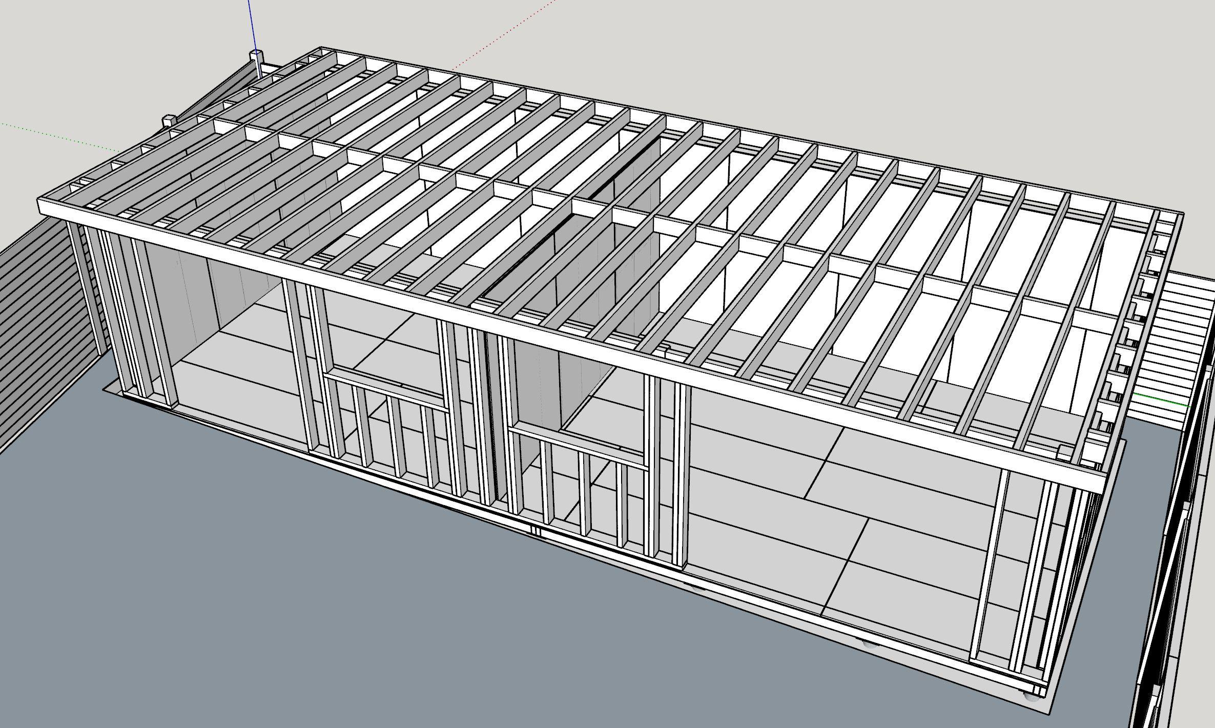

  3. some pictures of the stud structure and the wall section:
  4. Hi, I am building a 9 x 4m workshop / garden room I am trying to do it in accordance with building regs and permitted development - one of the regs is regarding fire resistance of buildings which are within 1m of boundary fence. I did speak to building control to talk things through and they seem happy for me to use a cement board (instead of OSB) on the outside as sheathing, thus making my build exempt from building control. There appear to be three options: 1. Fermacell 2. Versapanel 3. Magply I have heard stories about the weight and difficulty cutting these types of materials Questions 1. Which is the most recommended product from those three options or are there others I have missed? 2. Am I mad? - most people (even garden room companies) are using OSB, even on builds which are tight on the boundary (<1m) thanks Martin
