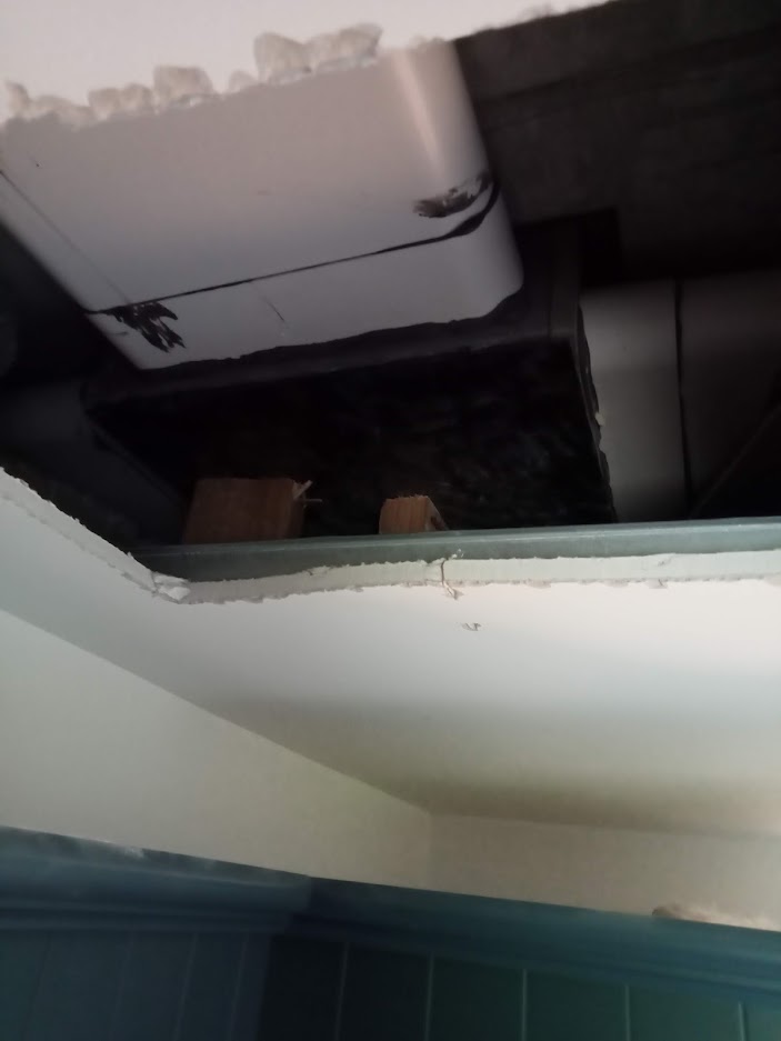

  1. Just an update and close to this if anyone else finds they are in the same boat. I purchased an endoscope from AMZN and used it to view the inside of the ducting but I could see no breaks in the ducting. I cut a hole in the plasterboard ceiling and stuck my head up to have a look. About 4 feet from where I cut I could see a "junction box" where the supply spilt off into 4 different ducts. The bottom of this junction box had been dislodged and the air wasnt going anywhere. I had to cut a second hole to access and glue the bottom lid back on. In the picture the 2 pieces of timber are holding the lid up to let the glue dry after repair. I will also use airtight tape as a backup to the ducting glue. This job was a right pain in the ass to locate fix and repair the ceiling. I did it myself but Im sure it would have cost a good bit if I had to call in an expert. The crowd that put in the ducting weren't great and in the end all we had them do was the ducting. I did a diy on the purchase and installation of the actual MVHR and vents, which turned out to be a good decision based on this junction box failing only 2 years of use by shoddy workmanship. Hopefully this can help someone if they run into the same problem.
  2. Due to the breeze I'm feeling, it seems like a disconnection.
  3. Yeah, I was thinking a cheap endoscope on Amazon to try and see the problem. I dont fancy cutting out the plaster board to fix the problem.
  4. ducts are 6" diameter and have been working perfectly for 2 years, this has only happened in the last 2 weeks. I can feel a breeze coming from the drop/false ceiling were the ducting enters, the breeze stops when i turn the machine off, so its a leak somewhere.
  5. Hi All, my supply vents are giving very little air to them. I have an anemometer and have balanced the system myself upon commissioning 2 years ago. I checked all vents and my extract vents are bang on from the flow rates on commissioning, but the supply vents are producing very little. I have taken off the spigots from the MVHR unit and the machine is producing very good supply and extraction. So i know the problem is within the ductwork. I can feel a breeze coming thru the false/drop/void ceiling that my ducting runs thru. Does anyone have experience in the best way to find a disconnection of ducting, without tearing pieces out of the ceiling to find the particular spot?
