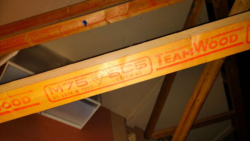

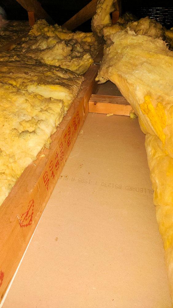

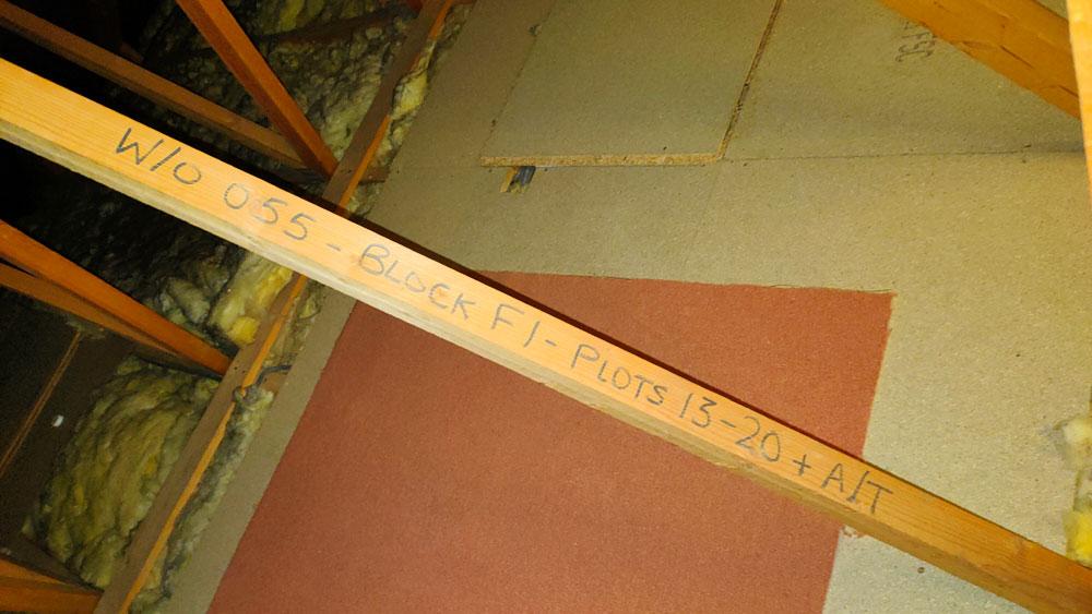

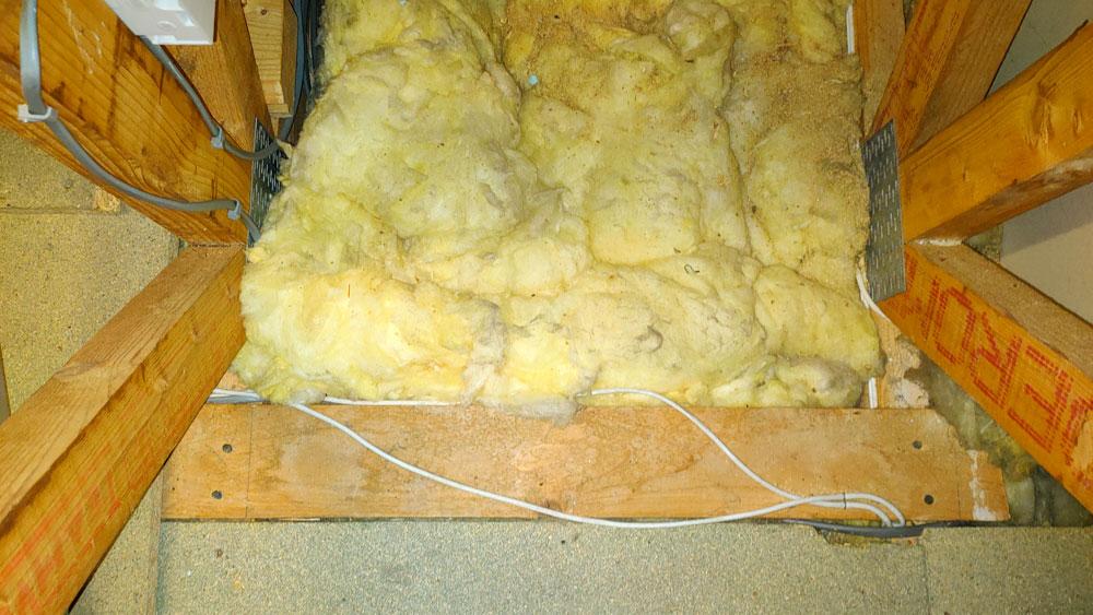

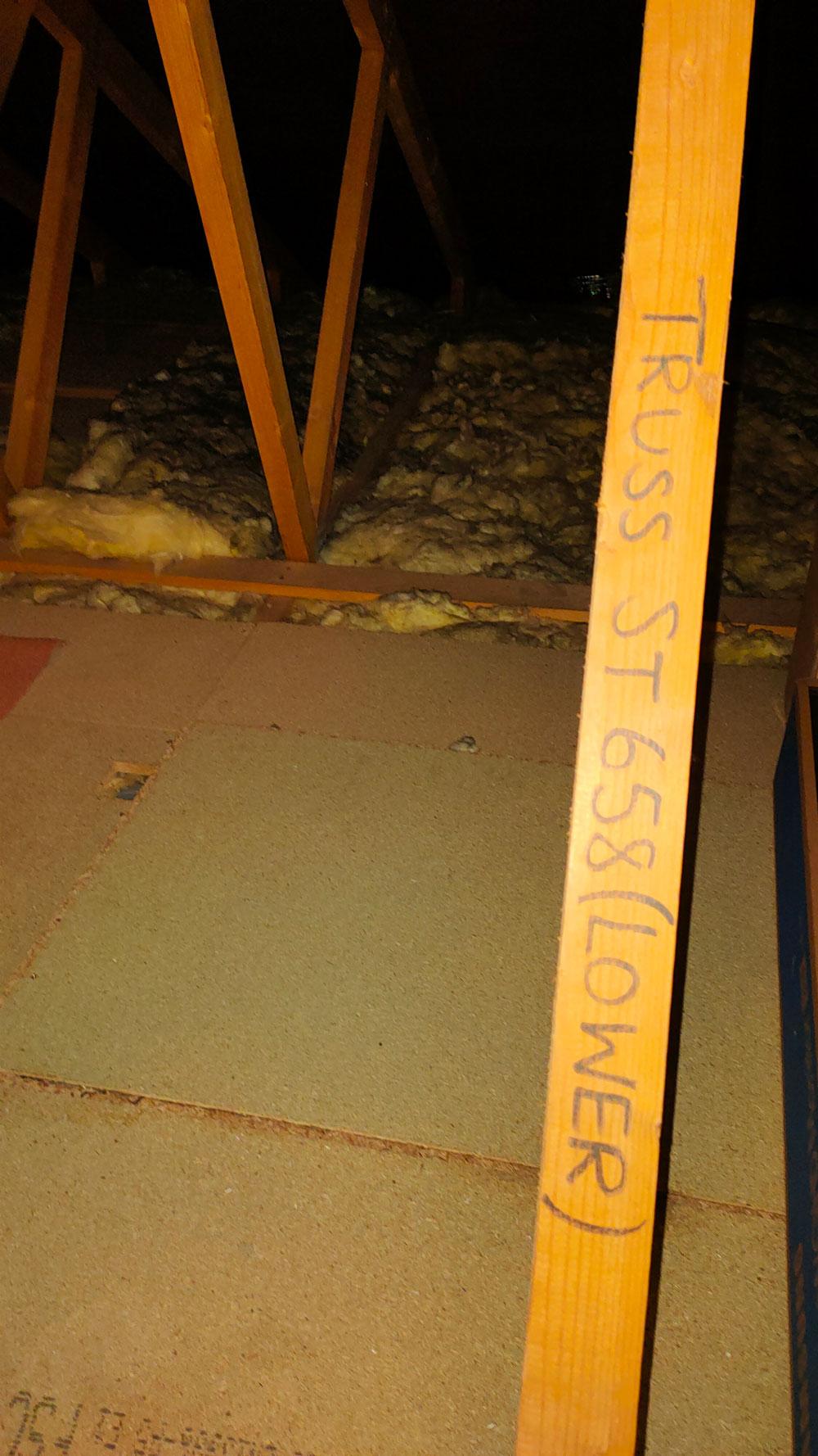

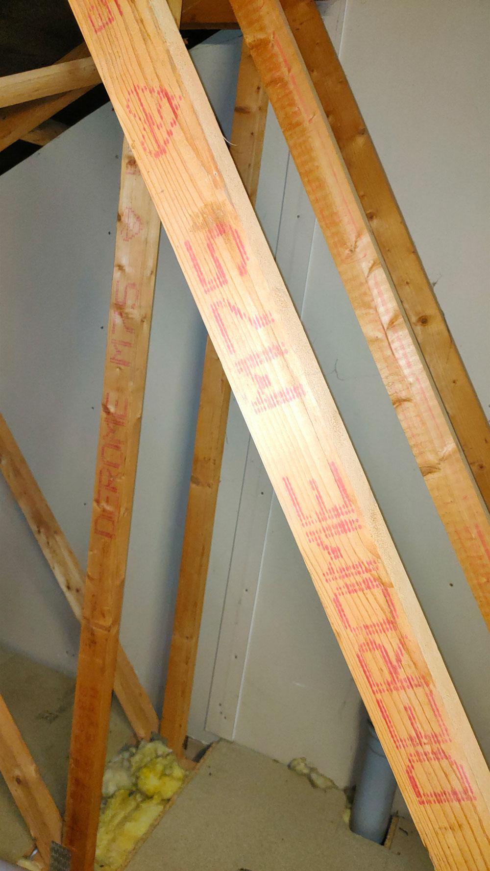

That's good to hear - would like to put more up but realistically should't be anywhere close to 1000kg! I pulled up some of the insulation in an unboarded section so you can see how that looks..... here the strip of wood towards the bottom of the image (under the white wire) corresponds with some wall here are some of the trusses with info on them... Thanks again for taking a look! -

Hello and thanks for your answers.... I have 140kg of stuff spread over about 5 positions. My flat is meant to be 45sqm so the loft is roughly the same, It's more long and thin with the longest dimension of the flat being 11.5 metres and varying widths. The actual beams are boarded over and insulated - I recall seeing some writing on the trusses but it was more about the plot number the truss was intended for - I'll take another look to see if there are further clues. -
Hello, I'm not sure if anyone can help me with this... I have moved into a 20 year old property with a decent sized loft space that's already been boarded with chipboard (and insulated) and I'm trying to find out what weight the floor can take per square metre? The joists are 60cm apart on centre and are 4.5cm wide by 9.5 cm high. I'm not planning to push it close to the maximum and I'll spread it out as much as possible - just wanted to get an idea of it's rating so I can feel reassured that I'm pretty far away from it. Thanks for reading!
