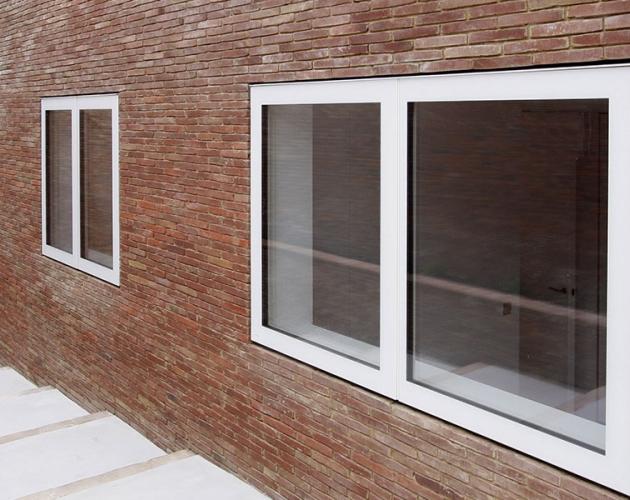

I'm not sure I understand why if the window is installed within the insulation zone it would be more thermally efficient - if anything I would imaging the reverse! Thanks for the reference image. Yes, I think a 25mm sill would be more than acceptable.
It's a nice idea, thank you. However, I'm wondering how practical it would be considering other comments regarding the porosity of brickwork
I'm looking to achieve a minimalist aesthetic
I hadn't considered thermal bridging, thank you!
I found the photo online. It's of a house built in south London. Thank you for your advice, a small aluminium trim could well be a good compromise.
Thanks for the reply - I hadn't considered staining. Do you think it would be an issue on mixed/multi stock?
I was wondering if anyone has experience of installing windows without using external sills? I am looking to install windows that are flush with the external brick wall. I understand the function of sills, but would be interested to know how others have removed them while maintaining water tightness. I am not looking to use a frameless system, but rather a standard aluminium window e.g. Schuco or Velfac. I've seen them on various buildings, and have attached a reference image of what I would like to achieve.
