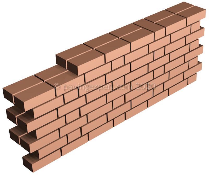

  7. Thanks for the advice. So, if I constructed in a similar style to the illustration attached I would be OK?

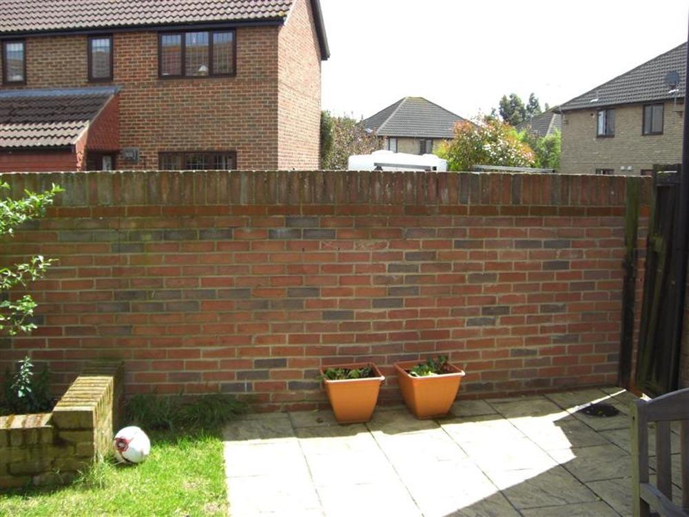

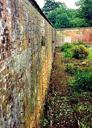

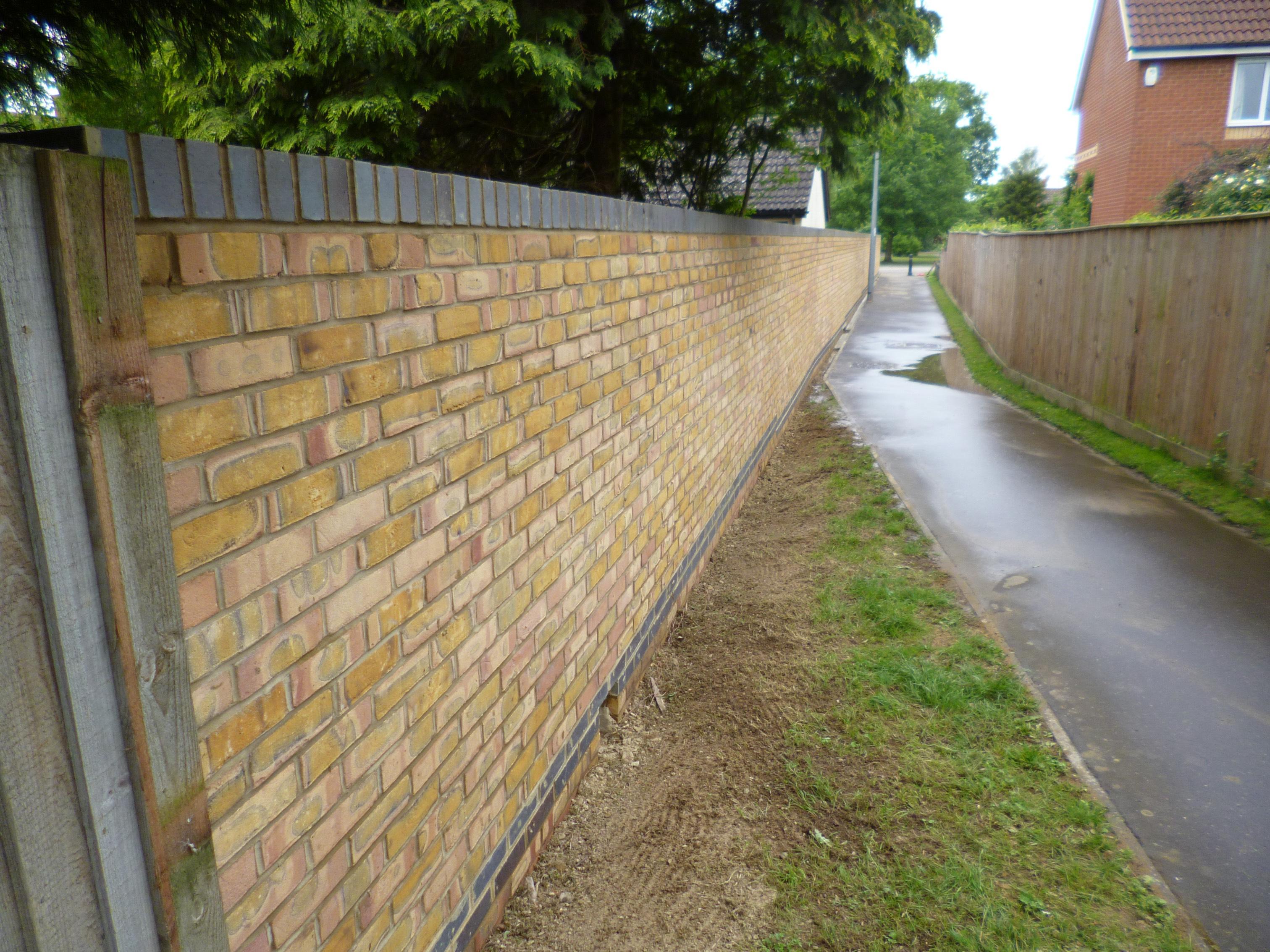

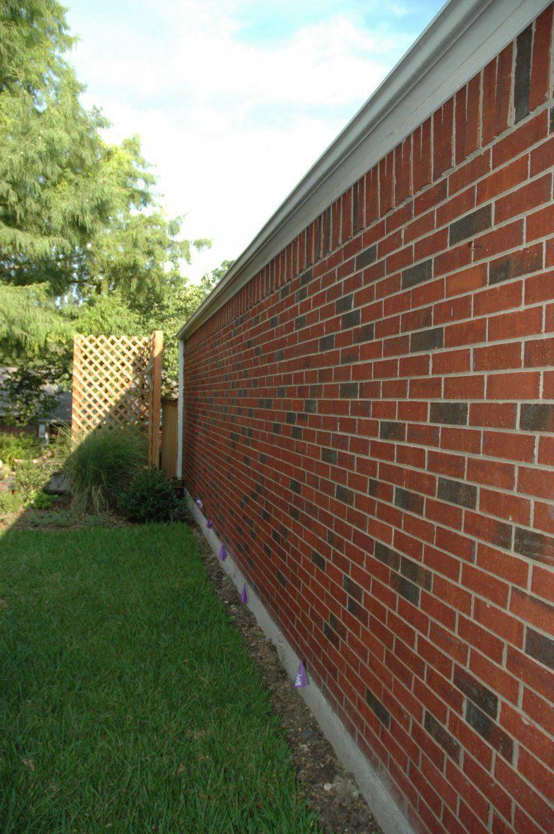

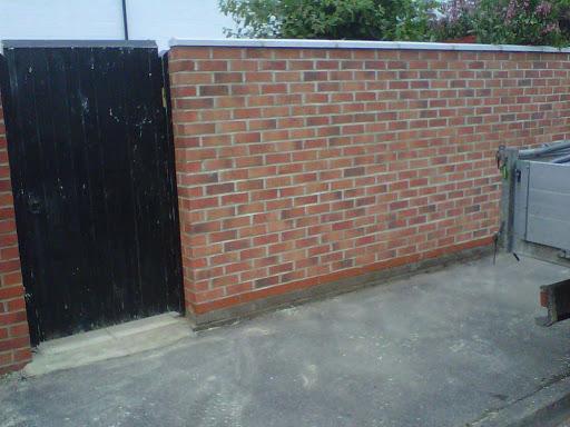

  8. I need to build a new approx. 2m-high 20m-long brick wall (one-brick thick) in a London garden. Ideally, I would like it to be flush. Am I able to get away with building such a wall without piers or other protruding reinforcements? Are there any workarounds or "hacks"? I've attached a few reference images of what I would like to achieve. Any advice greatly appreciated!

  11. I'm looking to achieve a minimalist aesthetic

  13. I found the photo online. It's of a house built in south London. Thank you for your advice, a small aluminium trim could well be a good compromise.
