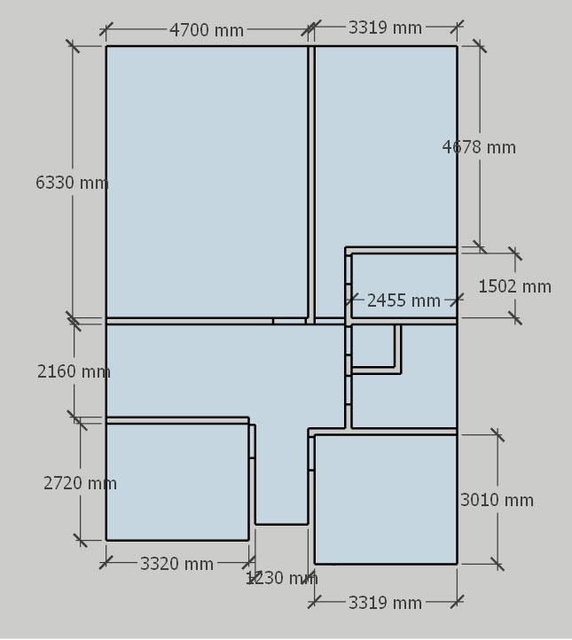

  3. Following 3m ground floor extension and loft conversion i am looking to raise the height of existing concrete ground floor. (floorplan attached). There are currently smallish differences in floor height between rooms and hall and a little bit of "out of level". I have been looking at an increase of about 100-120mm and we increased downstairs wall height by a whole block. I am considering 50mm celotex and 50mm flowing screed which will allow me a bit of tolerance with celotex levels etc. I am now thinking about 80mm celotex and 22mm P5 boards. is it possible for a competent DIYer to get a level enough surface on top of celotex to fit the boards and for the whole thing to be acceptable result? Is there a foolproof way to sort out differences of level (maybe 3mm over metre) and level (maybe 0-15mm) between rooms. The boards look increasingly tempting but i am worrying about the final result. Any advice regarding boards and celotex appreciated. Thanks Brian
