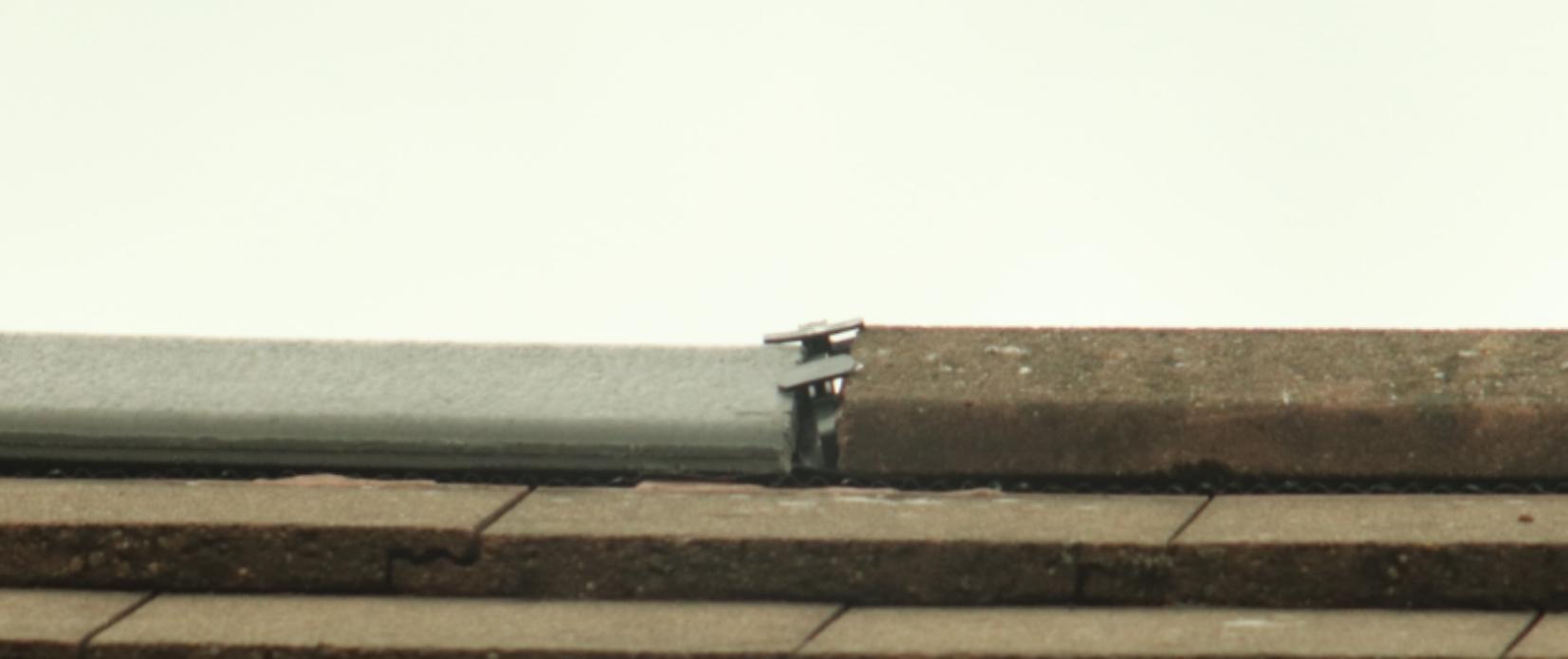

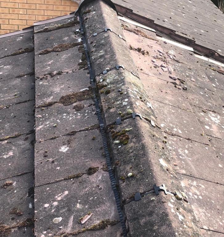

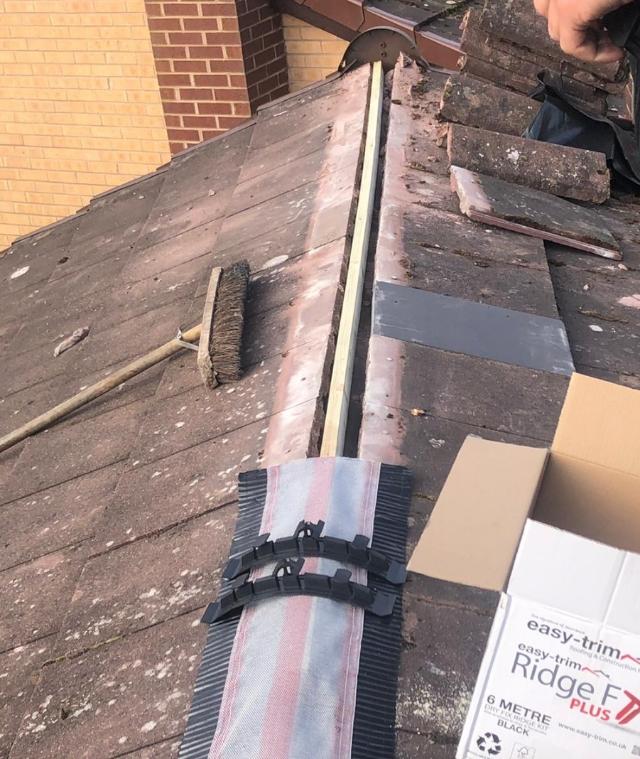

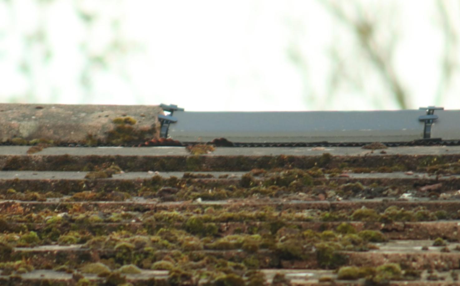

  5. Hi, I need advice on how our dry ridge got installed. Please see the attached photos. The roofing company replaced one broken ridge tile with a different type one, however the dry ridge plastic connection between the old one and the new type seems to be off. I don't think anything is leaking yet. Should I ask them to redo it? Will it leak? Thanks for your time.
