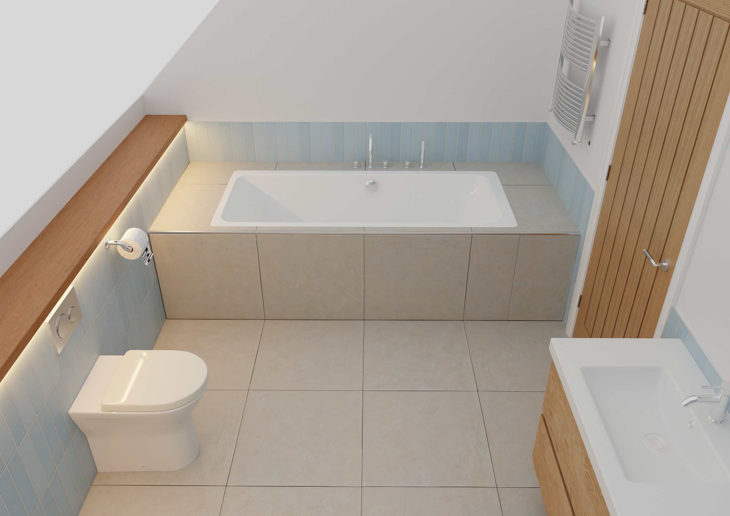

  3. Nice! I'm still formulating a plan to lower the bath down from where it is in the picture, but the angled side panels is an intriguing idea. I'm gonna have to pay particular attention to the sealant around the bath but I'm kind of a bit OCD about that anyway.
  4. Yeah, that's how it's normally done, so same thing but with the tiles raised around the bath to make a flat surround. My wife has hip mobility issues so this would allow her to sit and swing her legs in to the tub without having to support her weight on the edge of the bath itself, which hurts. So it would look like this - Sounds like what your saying is that back board is strong enough if it has a bit more support than ply.
  5. I'm planning to build a level "deck" around my bath tub, so the tiles are at the same height as the edge of the bath or near as dammit. I'm not sure about using the foam expanded tile backer board horizontally, how strong is it? When I've done this sort of thing with ply I've been able to stand on it with no concerns at all.
