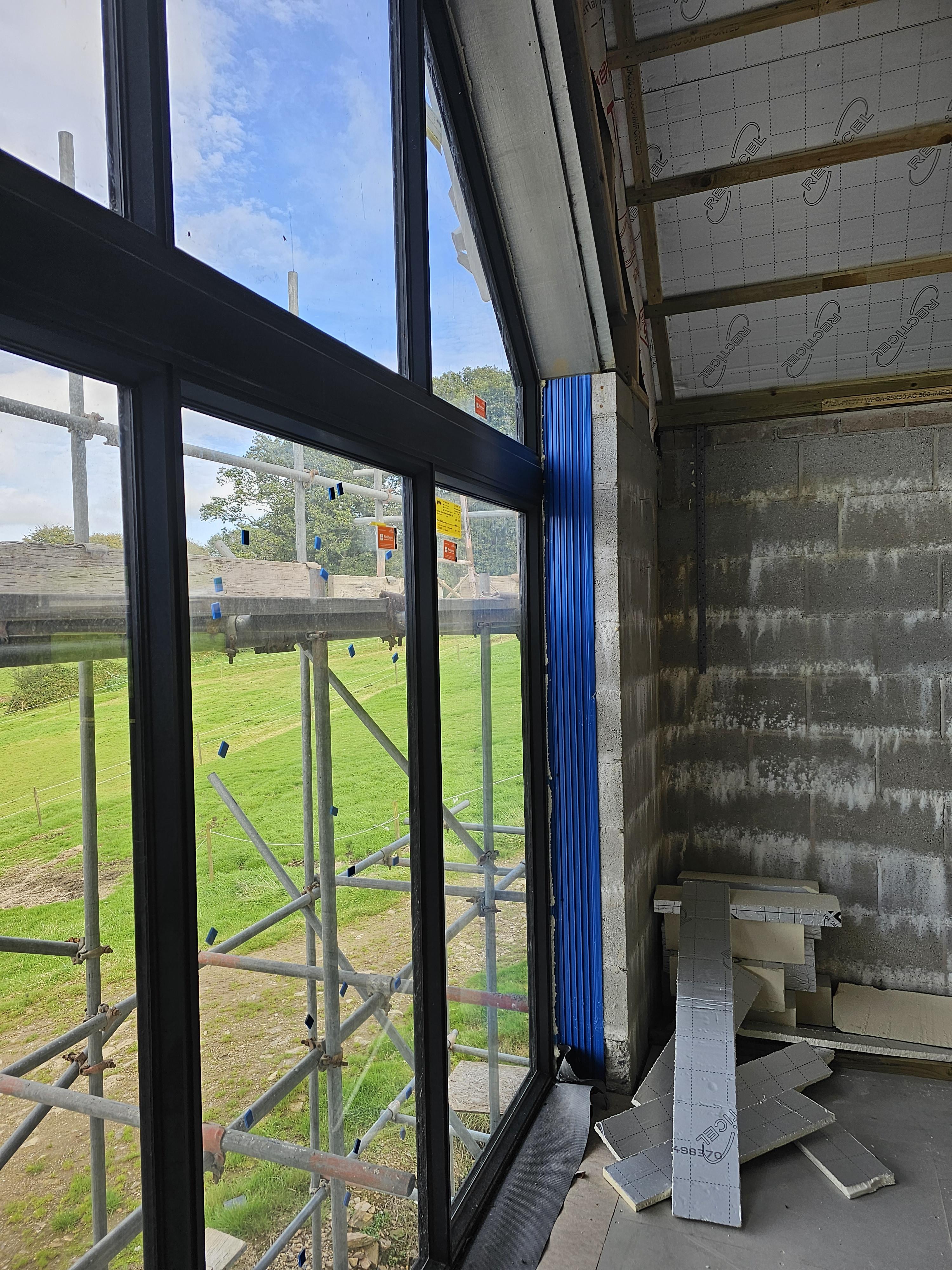

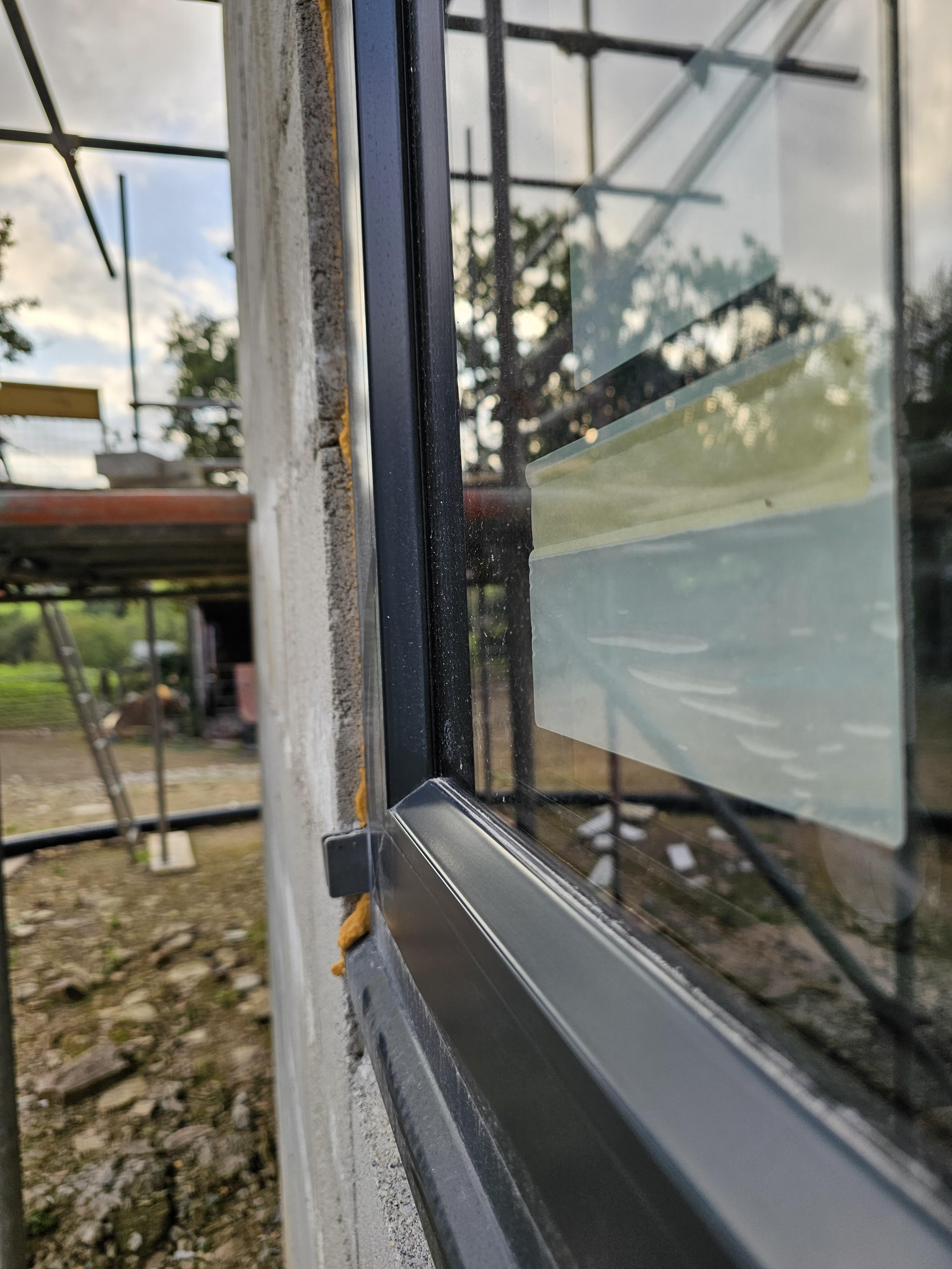

An update on this, the Company acknowledge that they're not fitted correctly but are still standing by their statement that is due to the direction of my builders. (My builders issued no direction on fitting) It's getting quite heated so I won't say too much more at the moment. They do insist that the large fixed gable frames must be fixed directly to the external skin for stability and due to wind loading. (They provided a technical drawing and I fabricated a 70mm box steel which sits between the apex and lower frames) Does anyone know if this is correct or should it also be pulled back into the cavity? Thanks
No nothing specifically about position within cavity, I had assumed that would be fairly standard procedure at the time. They had the details for where there was timber cladding/render etc. We're in South west England.
I'll speak to them tomorrow and report back with the outcome. Thank you for your help.
Sorry, 7 days fitting. That's great, I'll look it up. Thanks
I put the question to them last Friday and they came back to me today after speaking to the fitters (their own in house) and their reply was our builders told them that's how they wanted them (very unlikely, don't think they were on site at the time) but that they wouldn't cause any issues as they are. I wanted to be sure I wasn't making a fuss over nothing so I'll get onto them again. They were here for 10 days fitting(quite a lot of windows) so I don't doubt they'll dig their heels in about moving them. Many thanks for your help.
Yes supply and install by a reputable local firm.

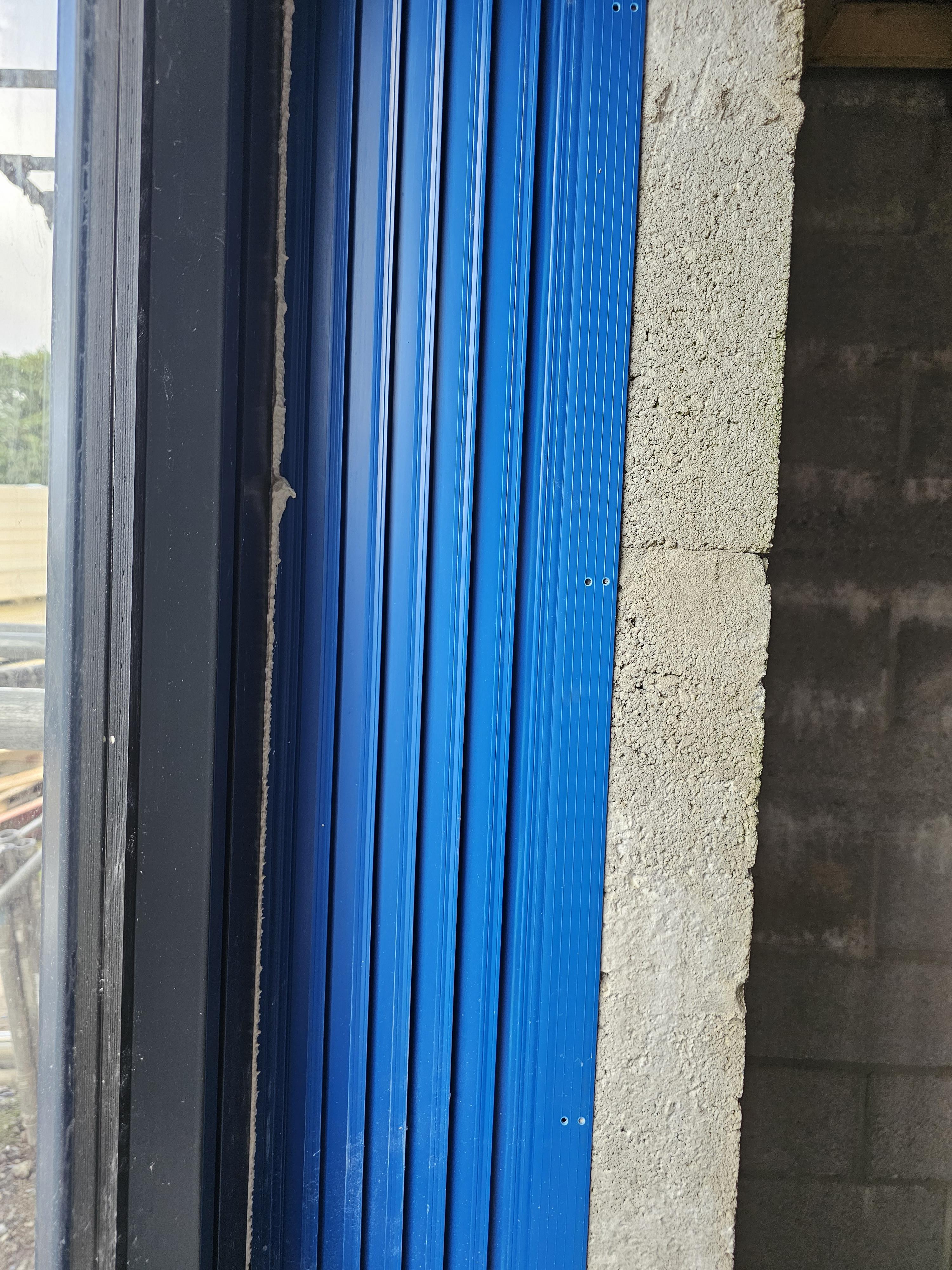

Thanks for your reply. I thought I'd read that re building regs but couldn't find it again or in the part L documents? So they should have been fitted on straps then? It's a 150 cavity. Stub cills fitted, slate cills will be fitted underneath.
Hi, I'm hoping someone can express an opinion on the position that our windows have been fitted. The fitters have direct fixed the 80mm deep ali frames to the external block leaf (flush with the cavity side and approx 15 - 20mm back from the outside) We have a mix of timber cladding and render going on. So, is this correct? Since they were fitted several trades have commented that they're set quite far out, rendering will be a nightmare and they're likely to leak? Further research suggests there will be a bad cold bridge and possibly condensation issues, or are they fine? Would appreciate any input. Many thanks
