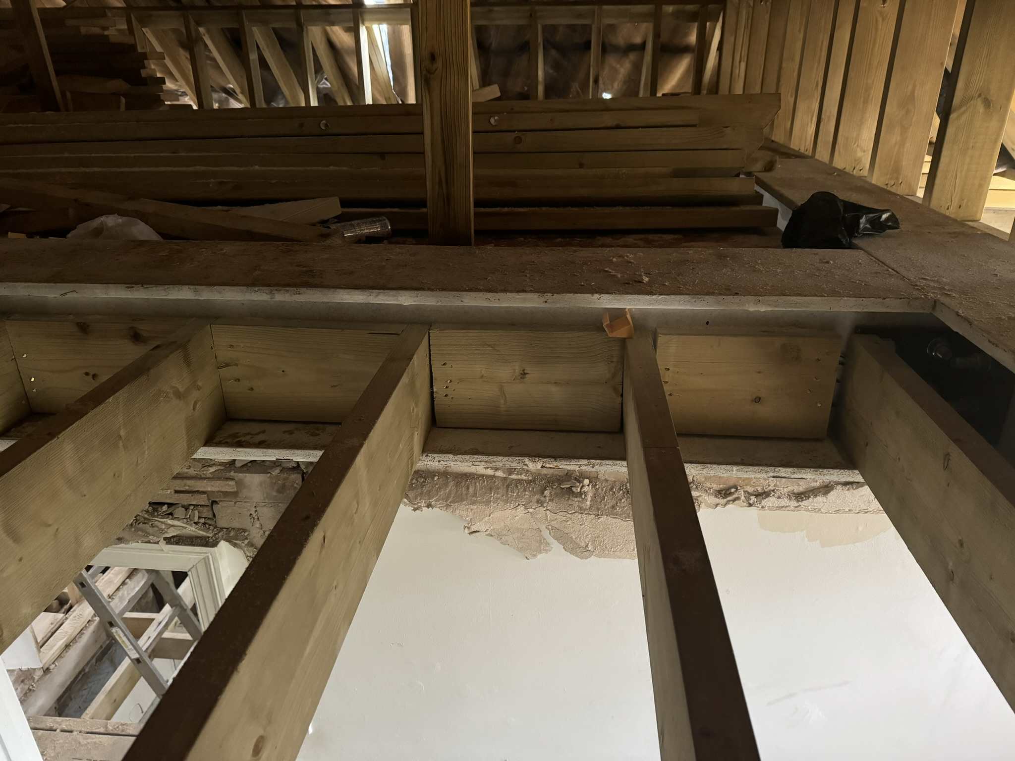

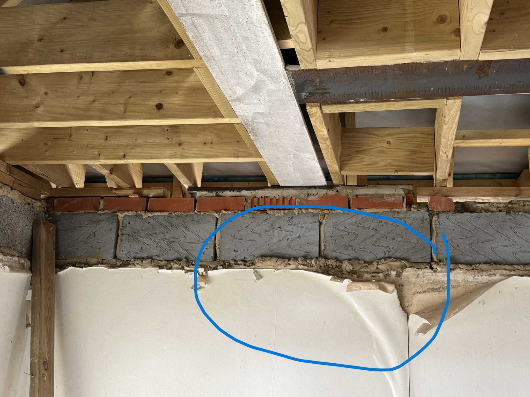

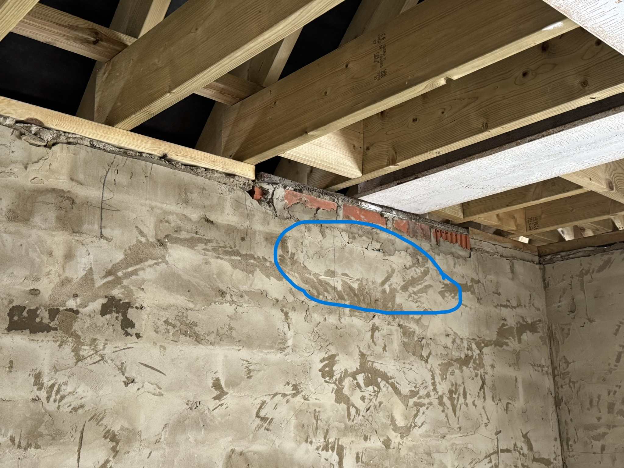

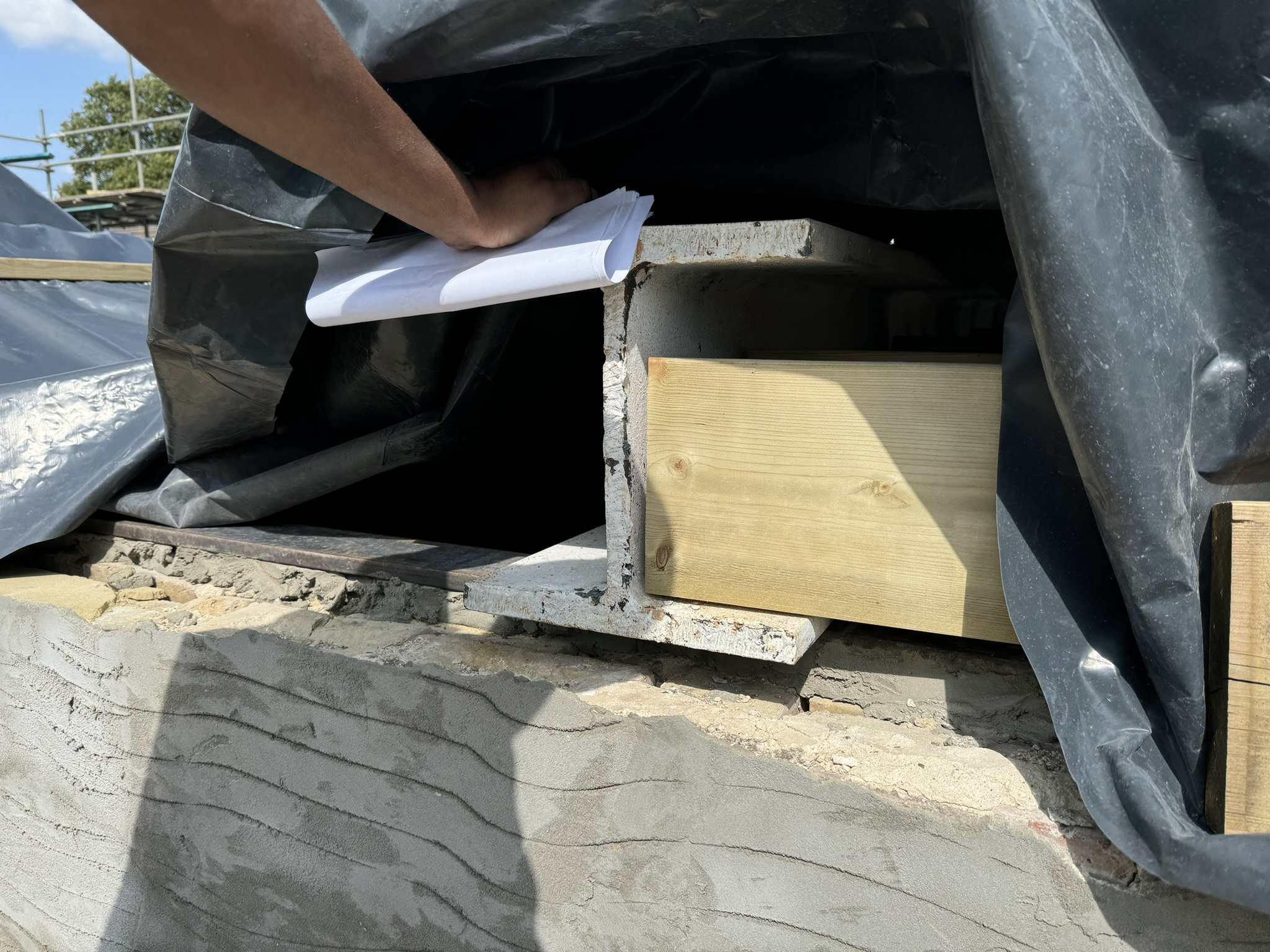

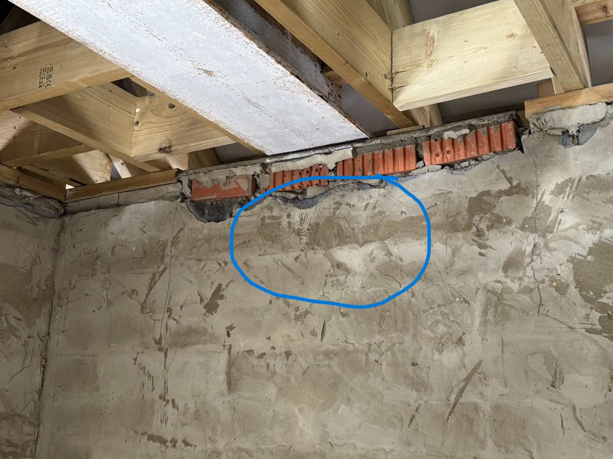

BCO have visited and recommended a packer hoisting procedure. He inspected the steel beams, which were okay, but he noted that the spreader plates for the rear steel beams at the loft level were installed on thermal blocks with weak bearing capacity. He suggested replacing one course/layer of thermal blocks with 10 N concrete blocks below the spreader plates. The structural engineer has noted this recommended but the builder did not follow. With the builder's dispute, is it safe to use at least two acrow props with strongboy attachments placed just below the steel beam to insert the 10N concrete blocks without needing a builder? If this is not the best topic to ask this question, I would move this question elsewhere.

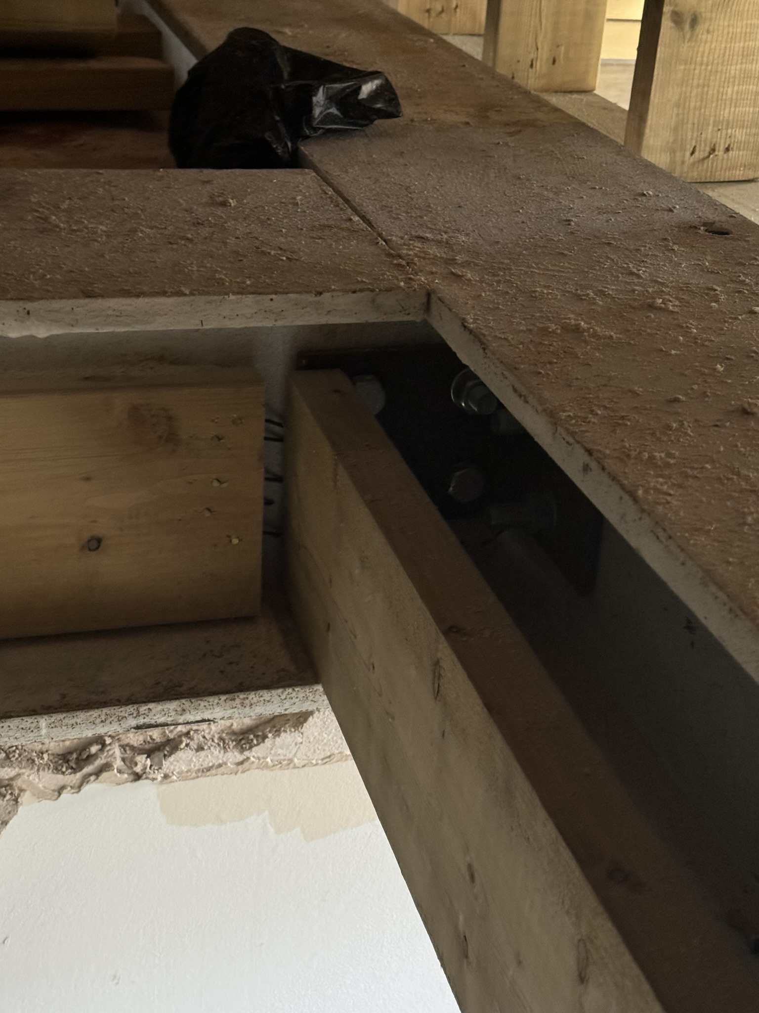

I cannot trust builders nowadays with their quotes. If I am going to add packers, would I need an engineer to check if its okay to place them on the existing josits?

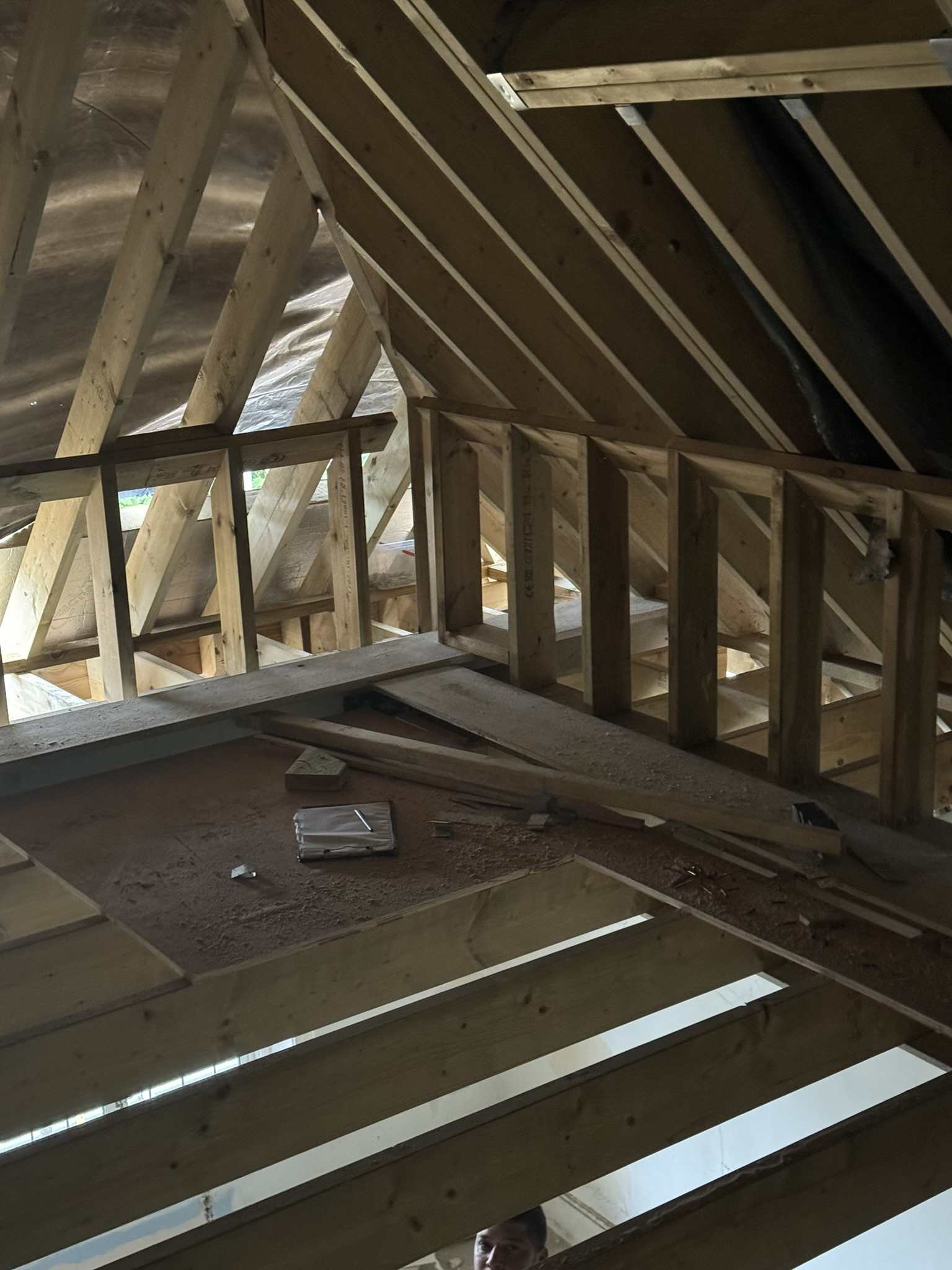

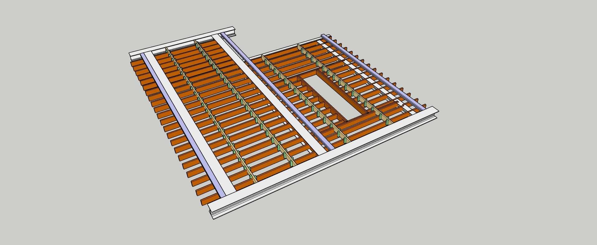

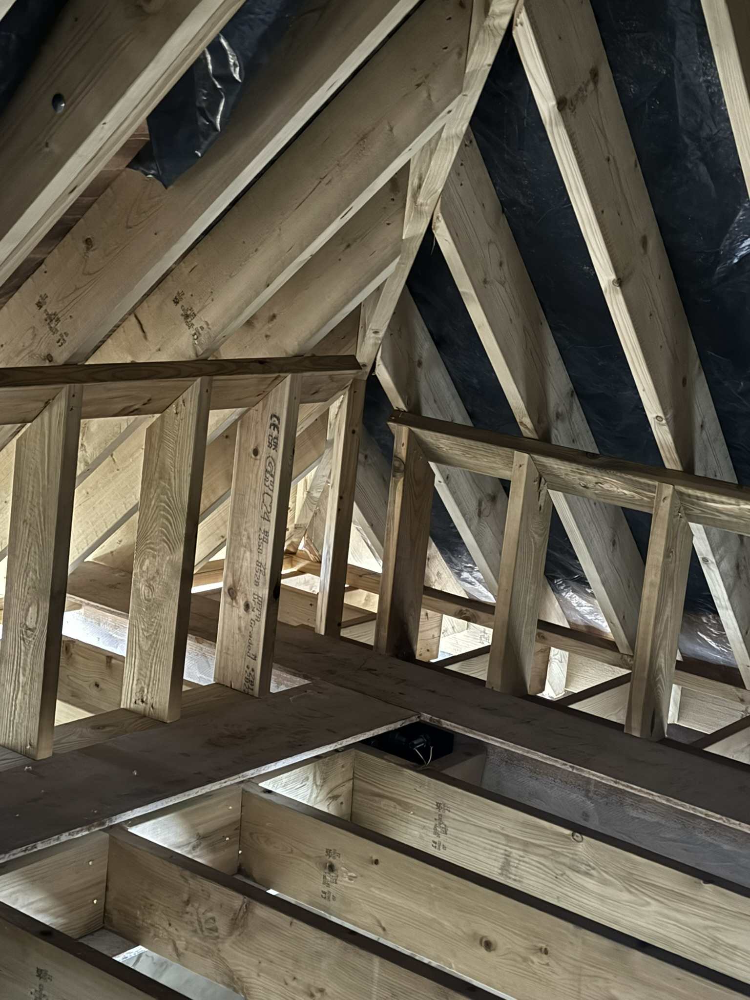

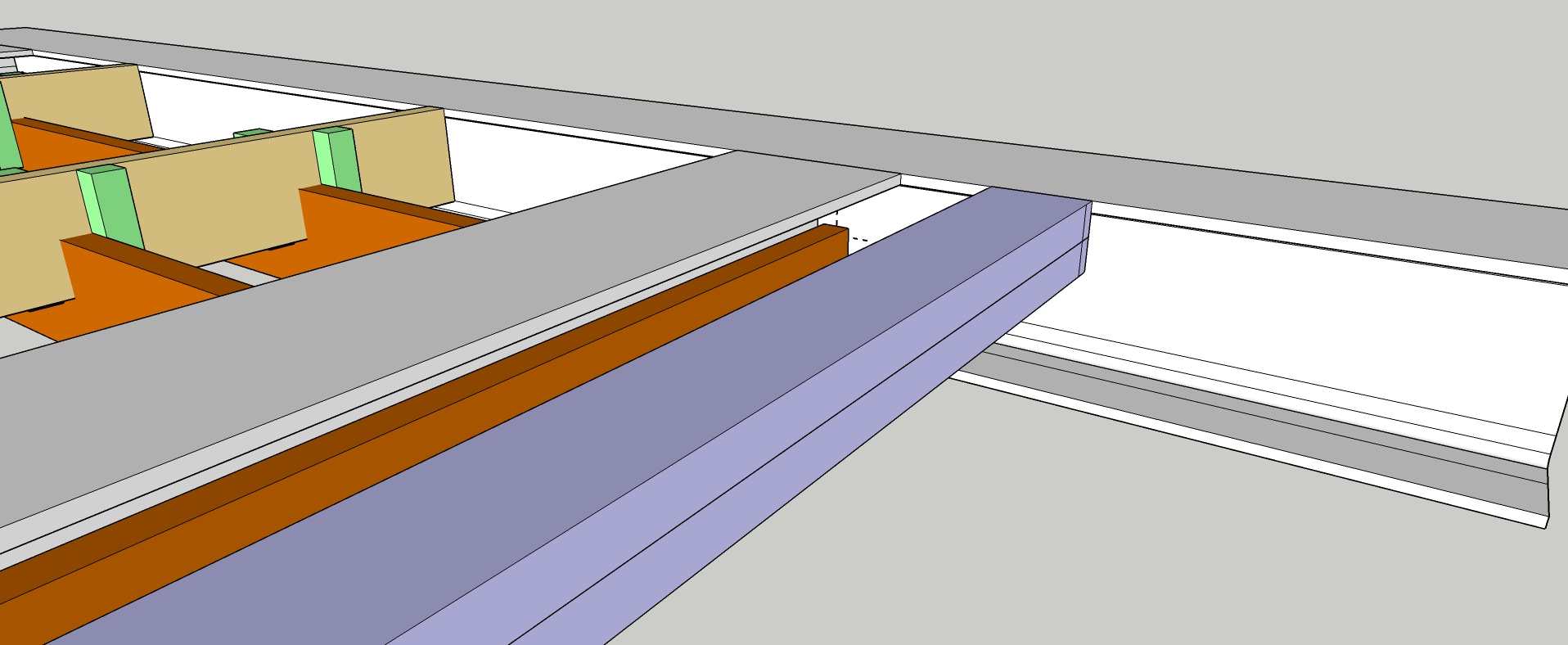

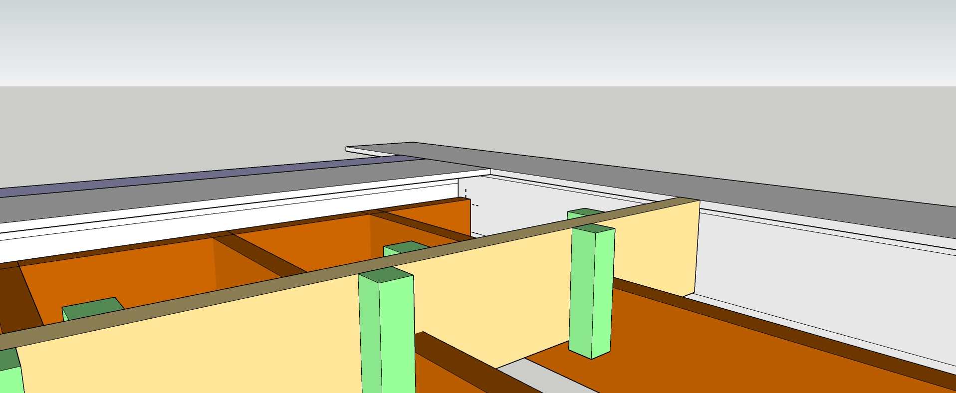

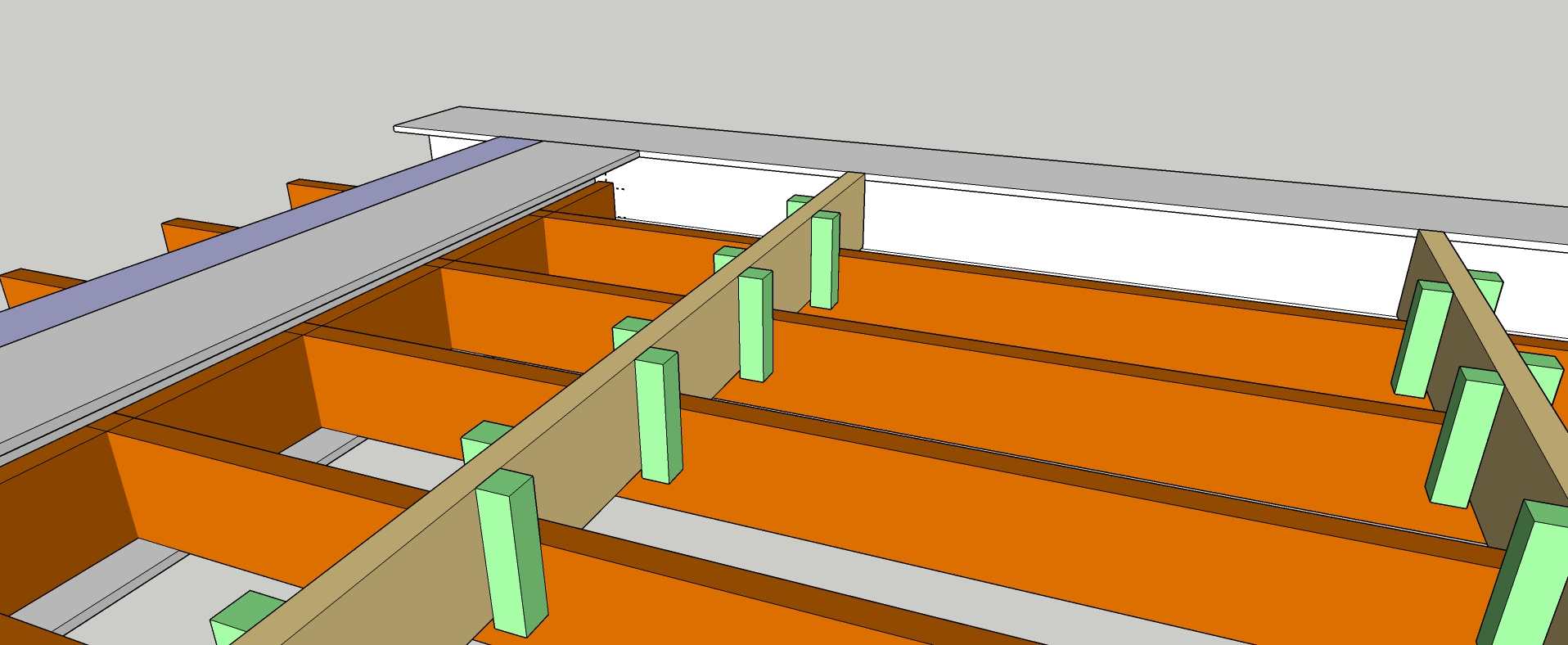

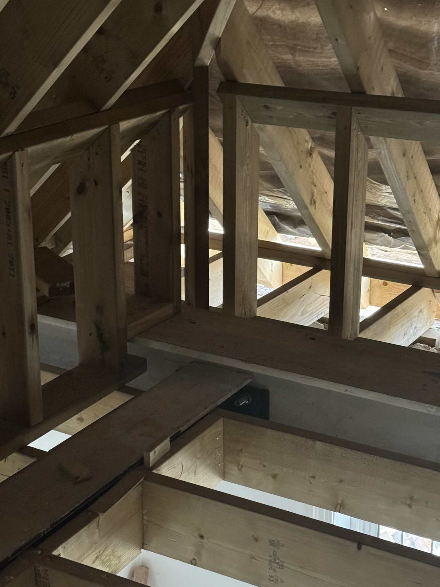

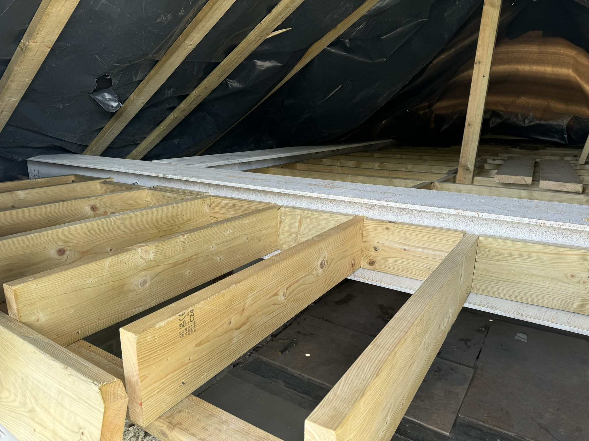

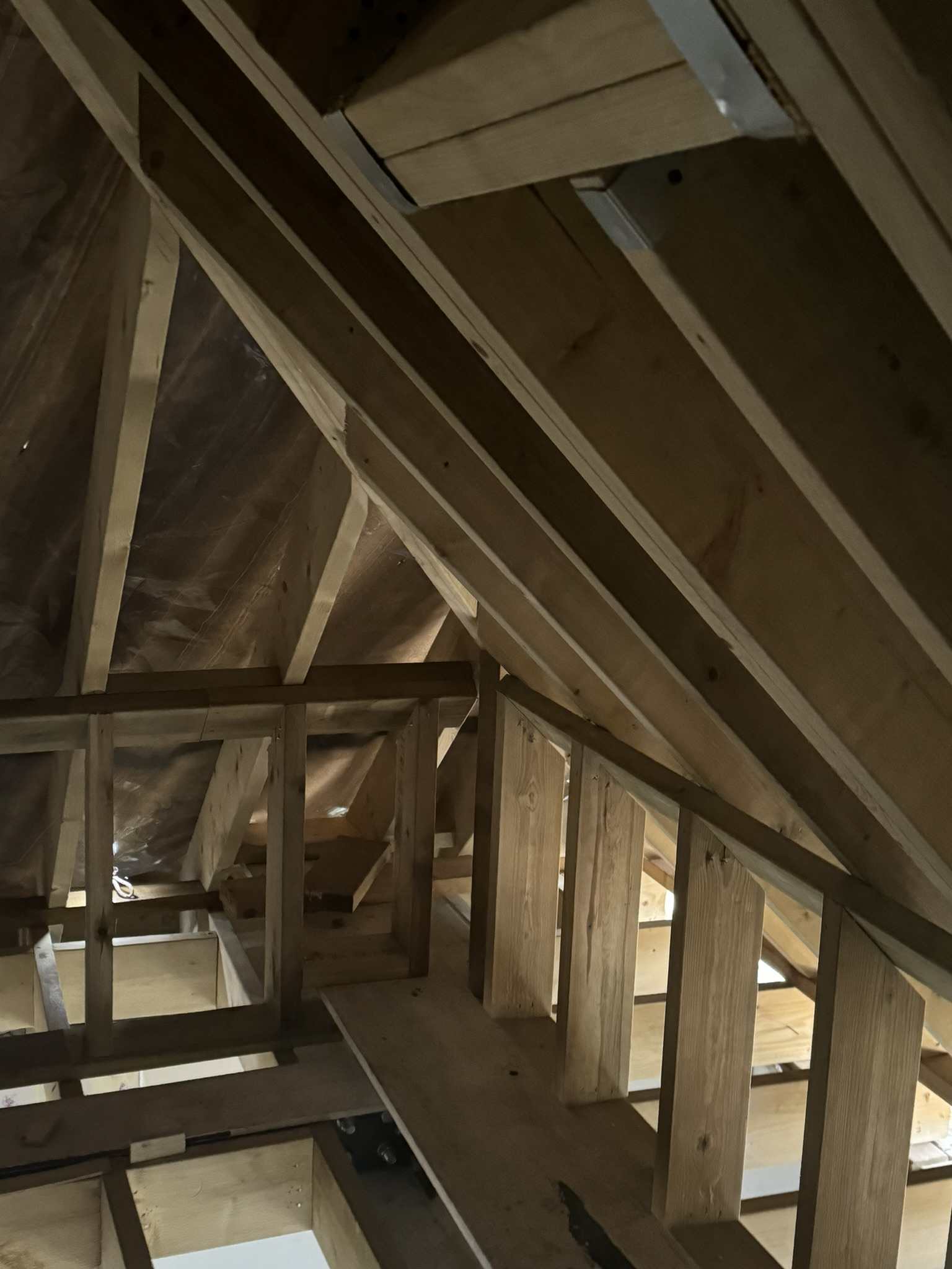

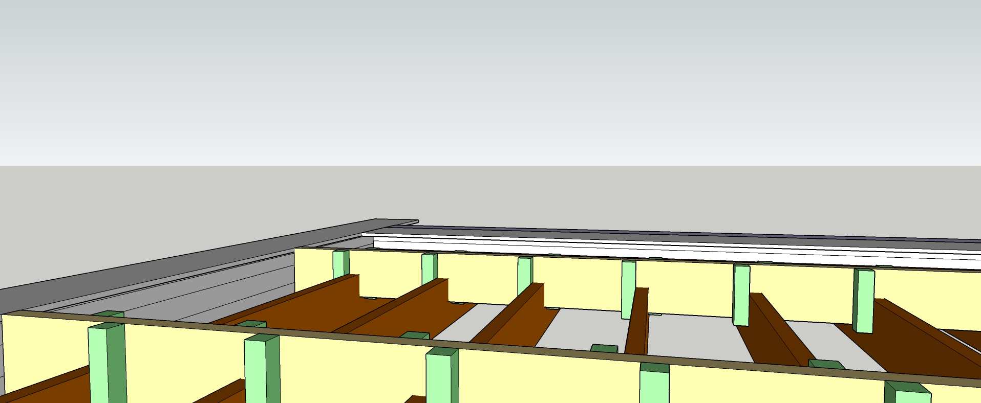

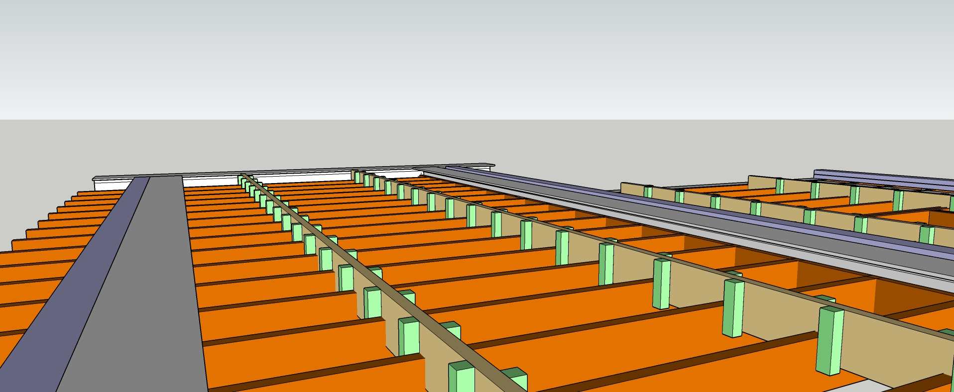

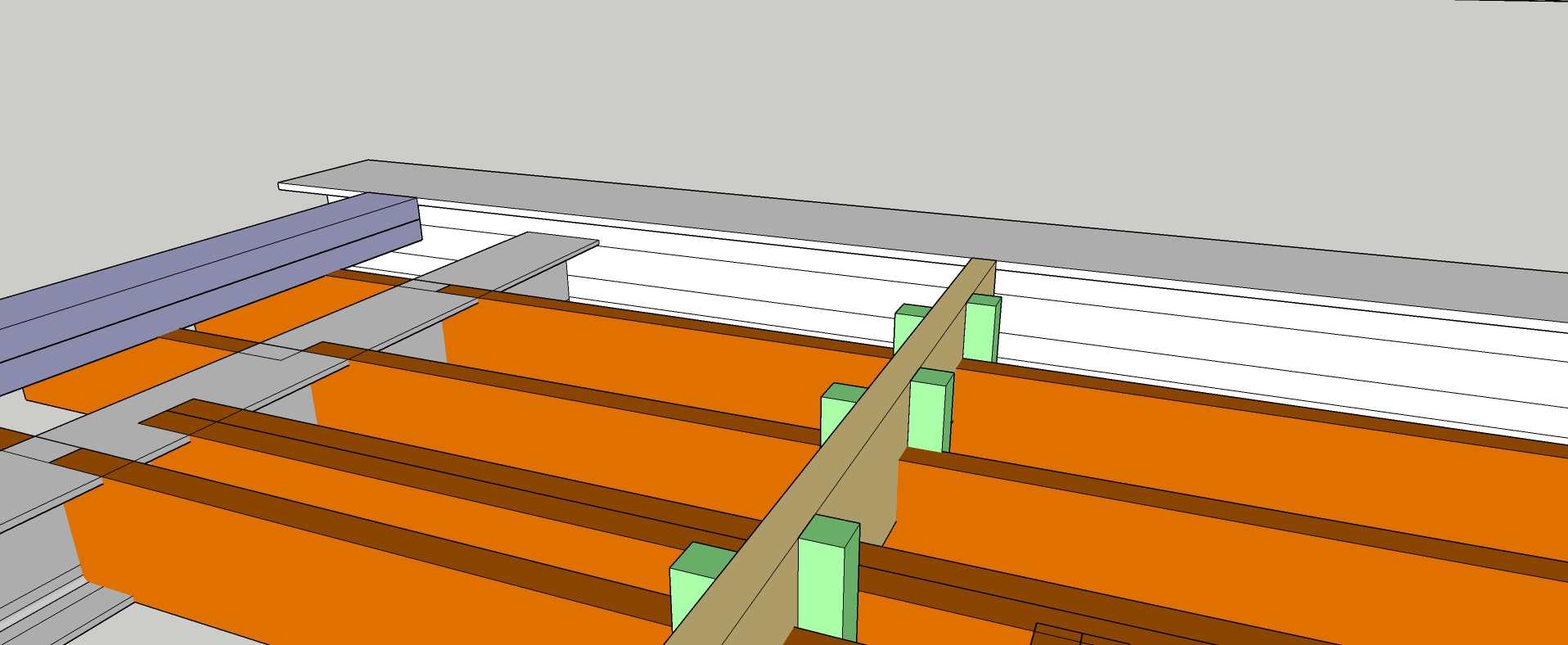

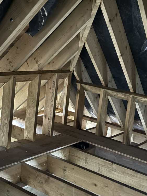

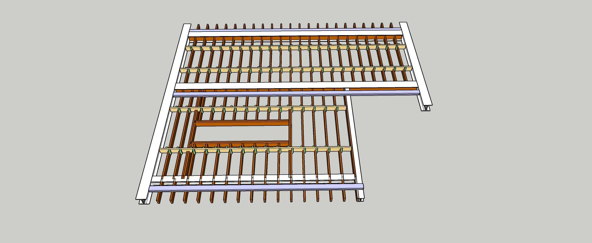

Hello all, I need some advice from builders, surveyors, engineers, architects or even self-builders, I am proposing a self-build on raising the floor level after the builder failed to follow the structural engineer's details by wrongfully installing the steel beam and timber joist upside down. You can see the drawings and photos where this has caused issues with the builder, who has refused to do the work as he wants extra money, and the engineer, who has not answered my queries. Building control couldn't provide their answer, so I had to create proposed detailed drawings for raising the floor level. I am so keen to do a self-building project on this issue. Is it worth it? Are these drawings suitable for raising the floor levels? I am open to ideas and suggestions. I have attached my documents just in case. Kind regards SE Detailed Drawing.pdf Sheet 1.pdf Sheet 2.pdf Sheet 3.pdf Sheet 4.pdf
