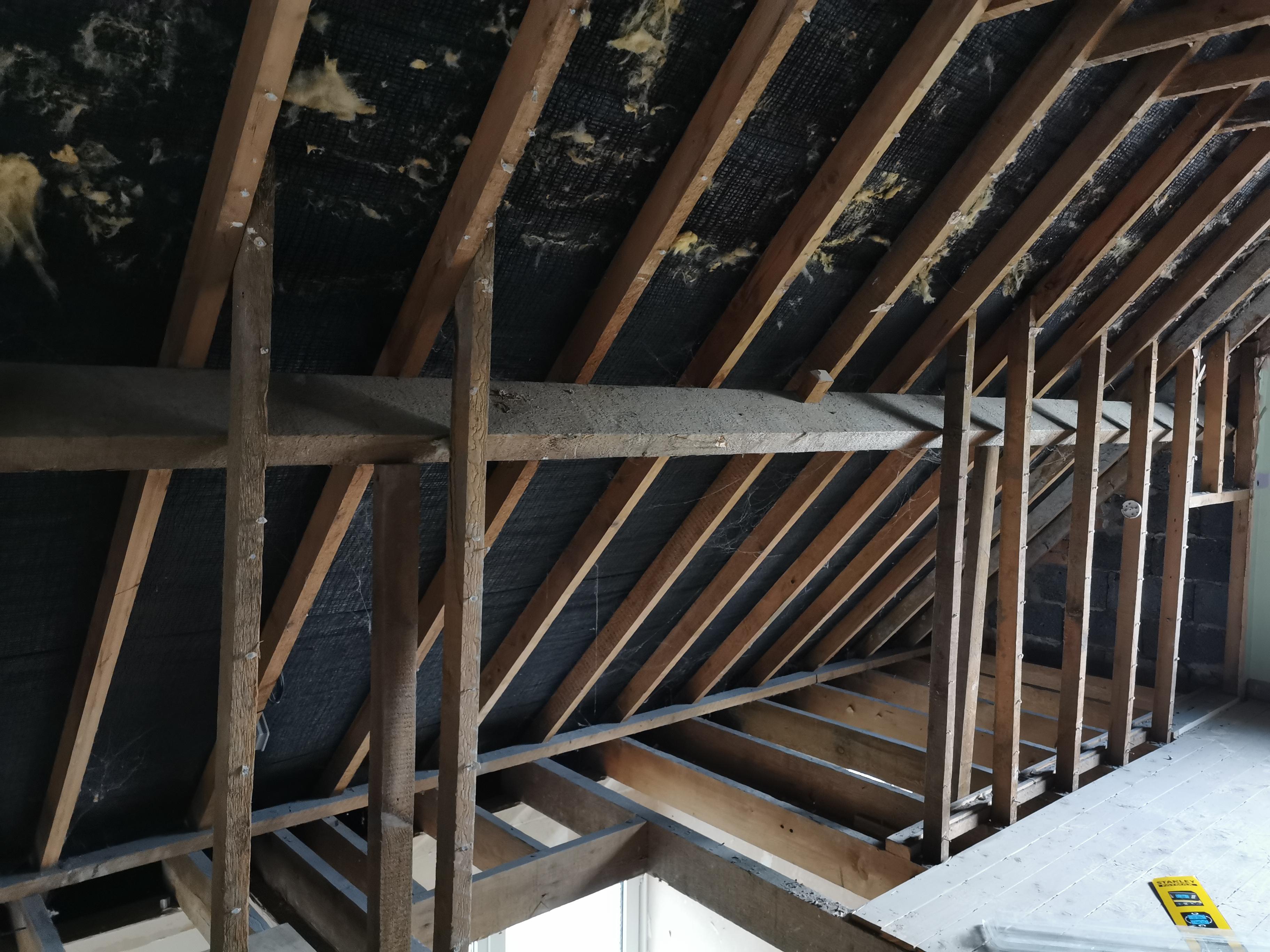

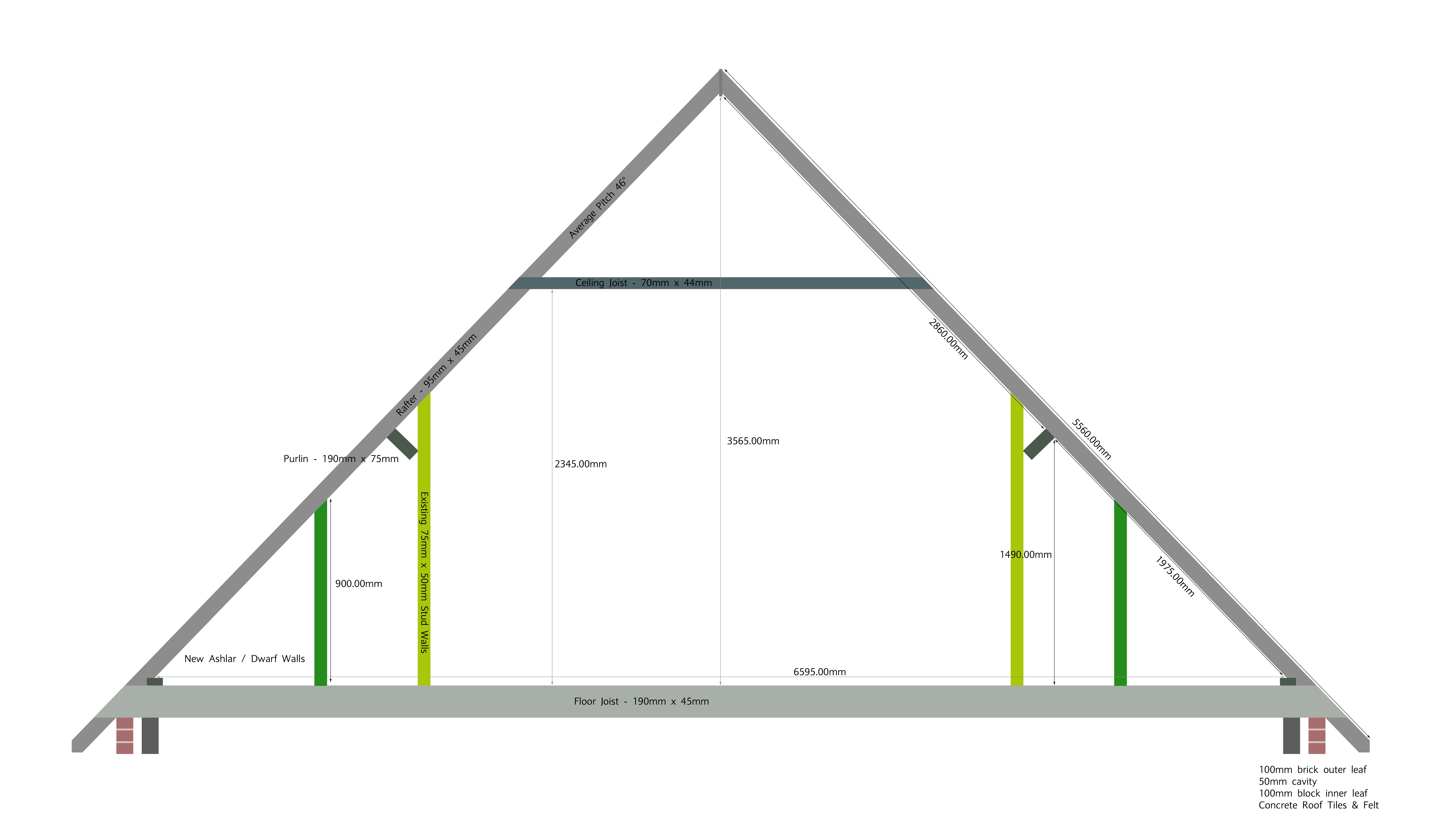

Ok great thanks 👍 They don't span >6m, they are resting on ground floor walls as you say, so they span about 3m + (sorry for the confusion) Yeah it looks like I need help from a SE 👍 Cheers
Cheers Temp for the advice, Good point on the 190mm floor joists 👍 Will try putting more than 150mm insulation if possible thanks 👍 Yes, that is correct with the felt roof and we did plan on the 50mm air gap (cold roof). Been reading/thinking since posting yesterday, I think the only way to achieve our plans is by removing the purlin completely and beefing up the existing rafters. Question is, do we actually need steels/flitch beam underneath the new ashlar wall? As you mentioned with the 190mm joists spanning over 6m, if these were not up to to spec, I suppose the solution would be to double these up (say every other joist) and in turn would these then be able to support the new ashlar walls 😬 Cheers
Hi Looking for some help and ideas! 😀 We are currently modernising a 1960s chalet type house (similar to the one pictured but not the actual house and no chimney present). Planning to install 150mm PIR insulation in the existing and new rafters and also planning on gaining a bit more space by removing the existing stud walls and installing ashlar/dwarf walls, with some wardrobe space behind these ashlars. The issue is the purlin is hindering the plans as it's sticking out a bit too far, ideally I think this would be best removed or perhaps there is another way (i.e. install a flitch beam 95mm x 75mm underneath existing purlin, then cut the existing purlin in half so it becomes 2 x 95mm x 75mm beams) but not sure if this can be done... I know in typical loft conversions, steels/flitch beams would be installed underneath the ashlars, but again unsure if this would be necessary in our case. Any ideas on how we achieve what we suggest? We are following the rules by the way, house is subject to building control approval for structural alternations. I've not contacted any structural engineers yet (it looking like I need to), just going through some ideas I can then put forward to him/her. Thanks for any help / ideas

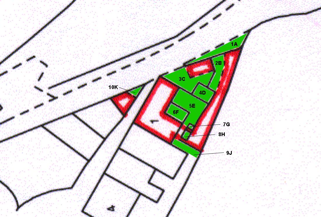

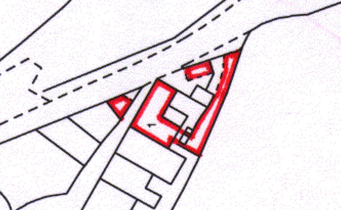

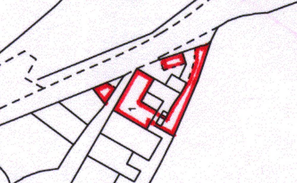

Hi there, new to the forum and looking for some guidance! Planning on purchasing a run down house to tidy up and live in. I have seen a few but came across this one with an odd title plan, the plan appears to be split up into multiple segments, I can see at least 6 pieces of land bordered. The title plan does mention "The mines and minerals together with ancillary powers of working are excepted". So I am assuming sometime in the past, the owner has decided to retain these odd bits of land, which is now mostly overgrown. The vendor has not mentioned any mine shafts etc and I've searched the mining map and nothing has come up to show this is a mining area. My plan was to maybe put an extension on the non-red areas or a garage or just simply clear the area as a garden, but now this does not look straight forward, I am sending off an index map search to get more information, just wondering if anyone has any advice or perhaps come across this situation before. It's a bit odd! If you look at the land next to the 10k green bit, that is the properties front garden, but why isn't the green bit not included? I appreciate their is a right of way to neighboring properties at the front, but that is not an issue. The area in red is freehold land. Thank you for any help and guidance
