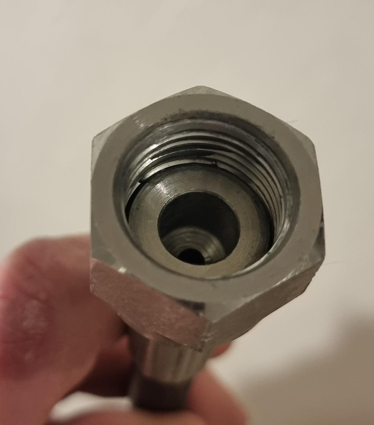

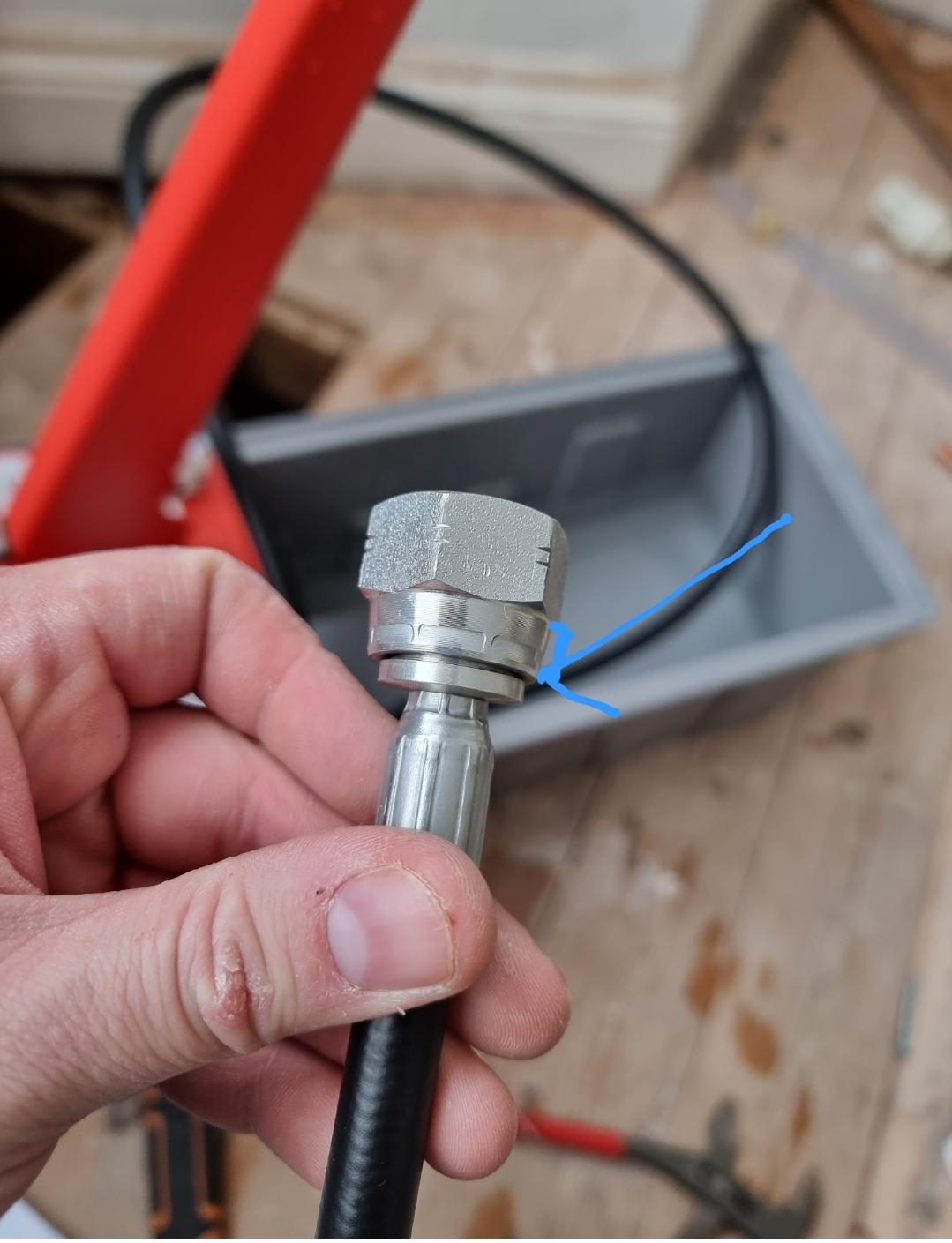

  1. I've had two now. Didn't see anything in either box. Not the end of the world. Its 89p for 5 from screwfix.
  2. Thanks guys. Appreciate the responses. I thought it would need a washer. I just can't understand how they don't come with them. Or at least mention that you need them in the Instruction manual. Says absolutely nothing about it.

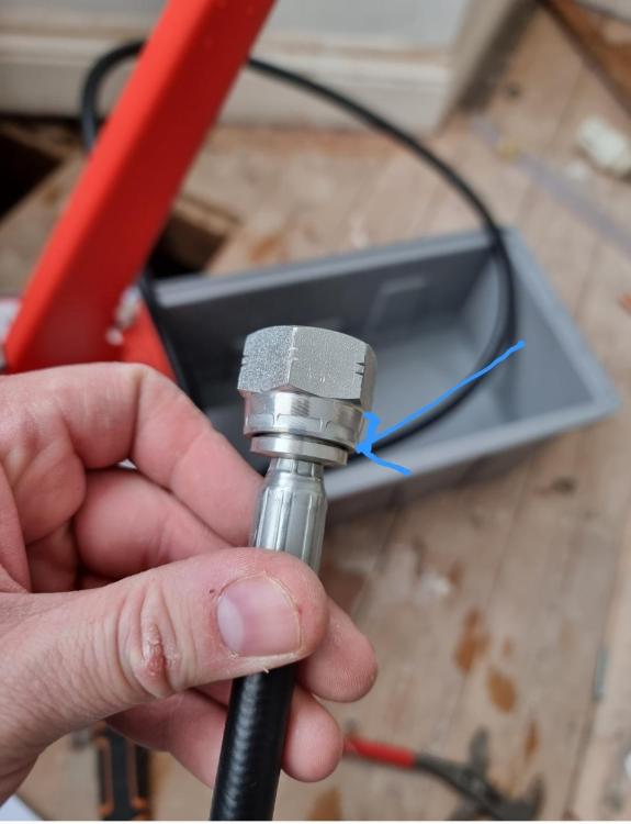

  3. Thanks for the replies guys. I just can't get bit to stop weeping. I'm abit surprised it didn't come with a washer. This is the second one I had. The other one come with a broken gauge. So didn't even test that one, but it didn't have a washer either. This is another pic of the connection.

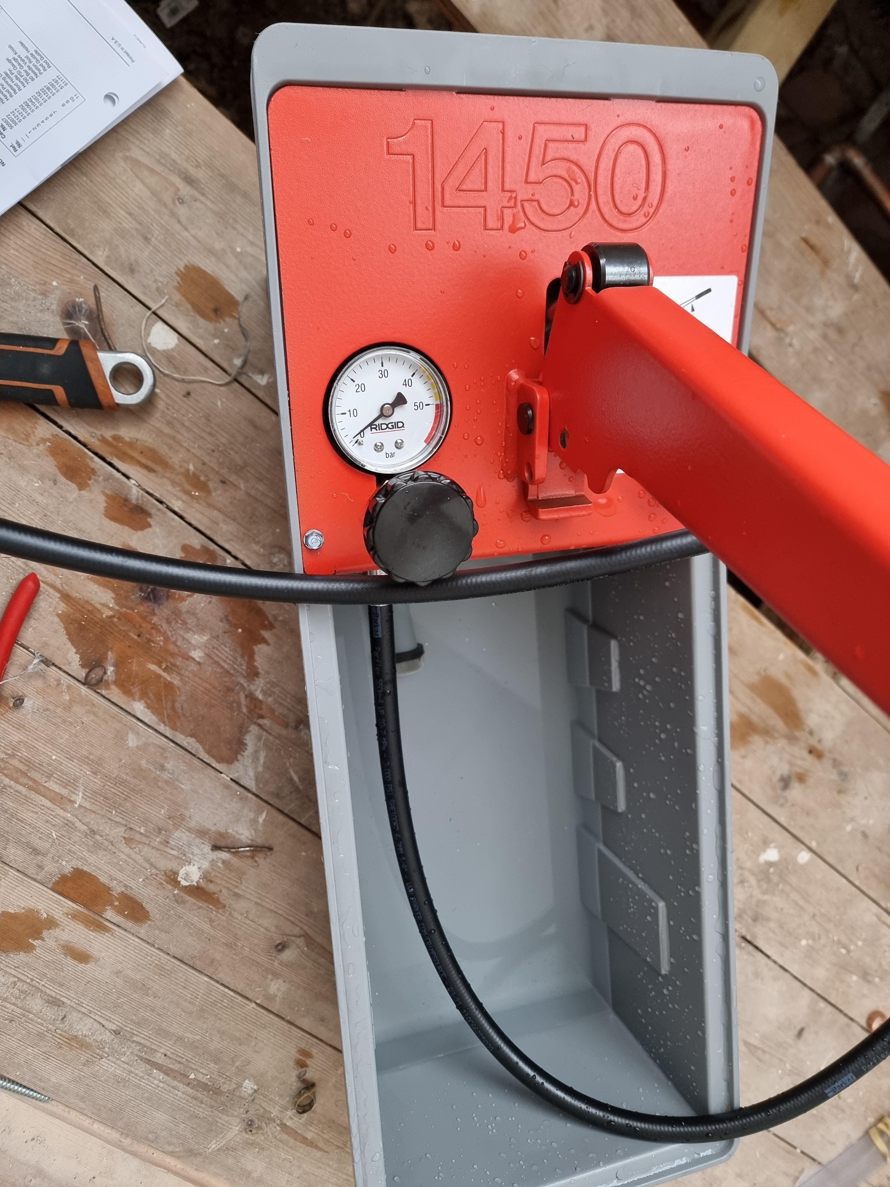

  4. Hi guys/gals. I need to test a small bit of plumbing I've done. I bought a ridgid 1450 pressure tester (over kill I know), but its not holding pressure. The hose that attaches to your pipe/rad etc is leaking. Is it supposed to come with a washer? Cheers
