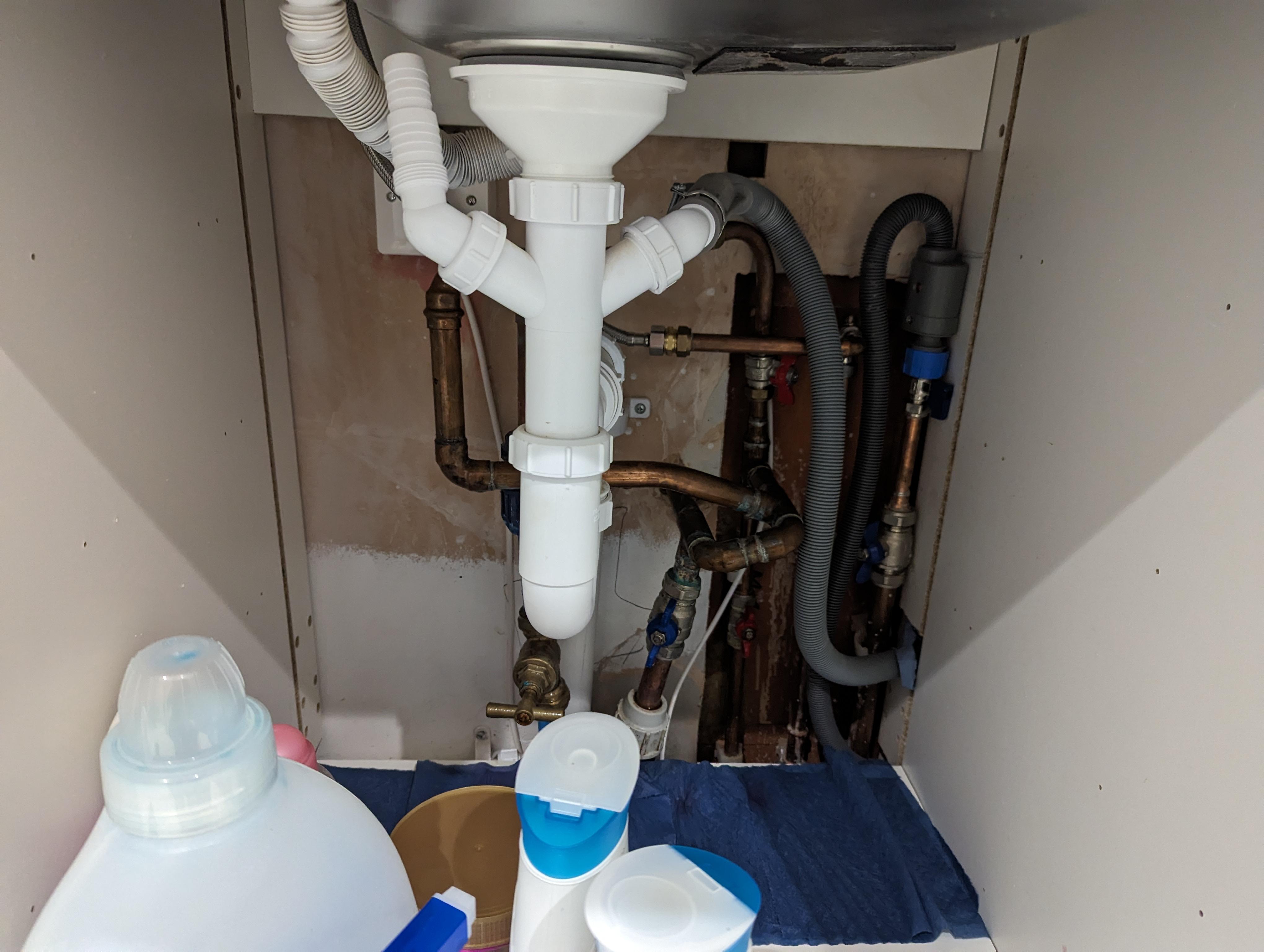

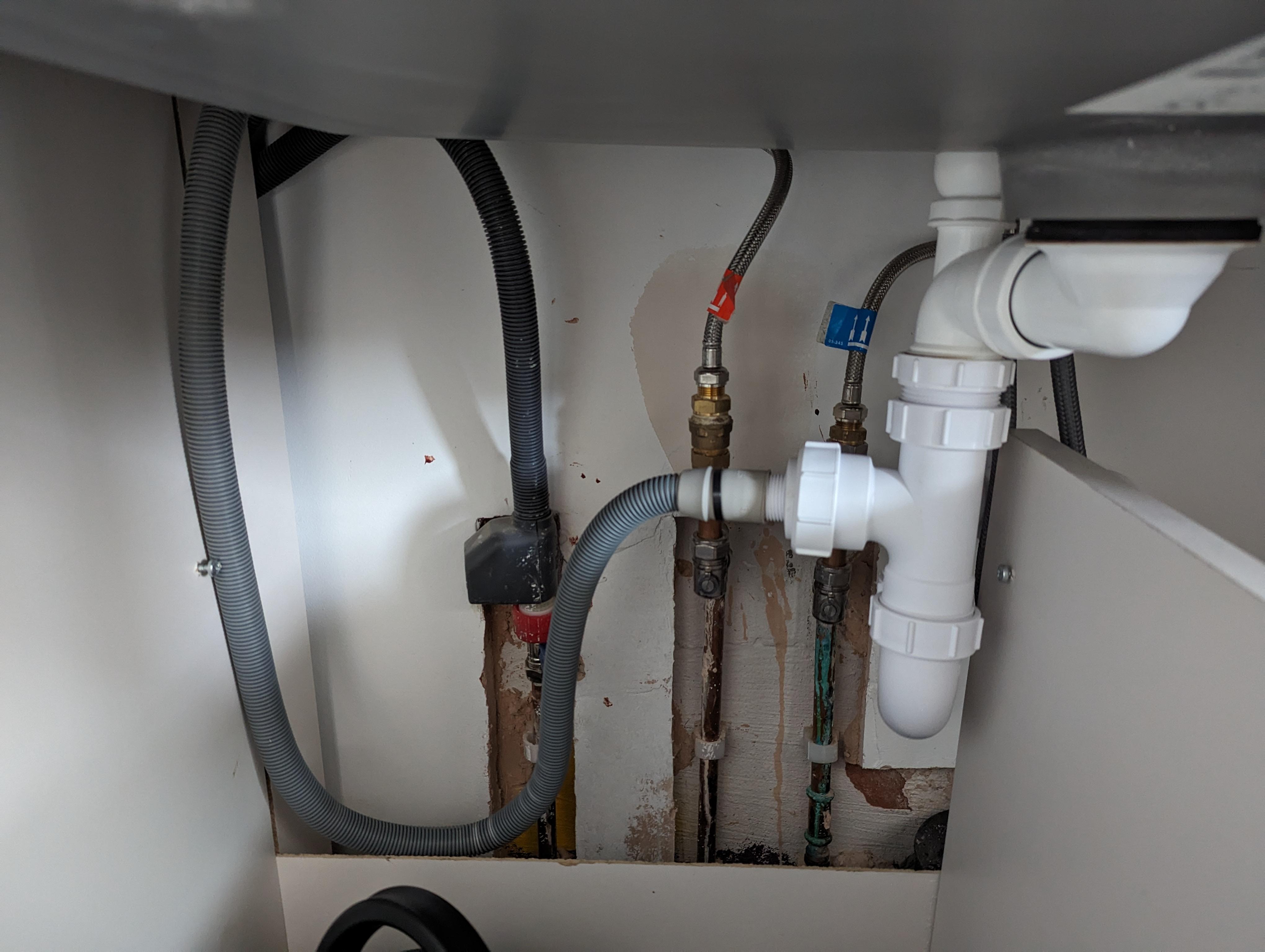

  3. Hi, I need advice whether I should pressure our contractor to redo the plumbing under our kitchen and utility sinks (see: pictures attached). The kitchen supplier said they couldn't hide the pipes more. What are my options? Is it reasonable for the pipes to looks like these? This is a new build house (the contractor is still on site), but the pipes look like excavated from Titanic
