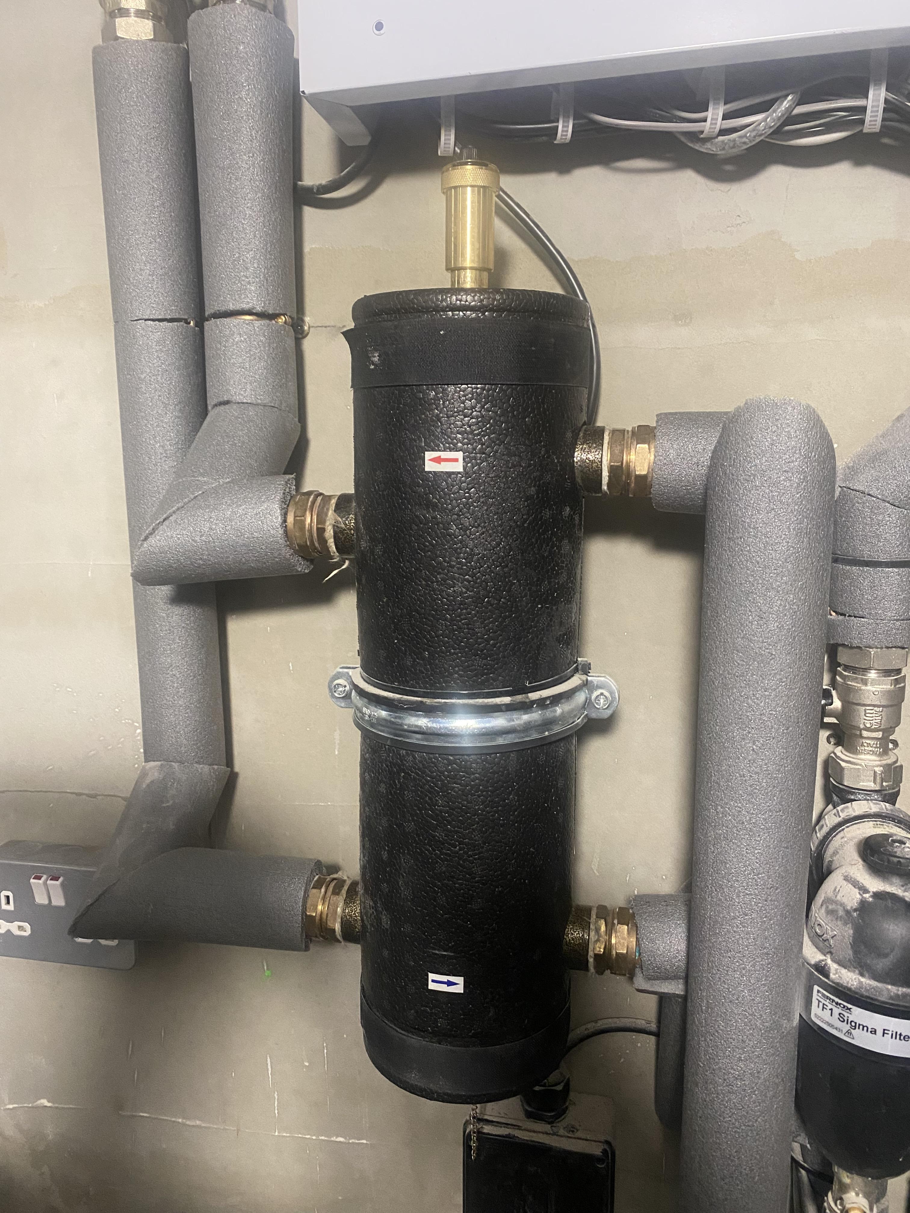

Yes, TLA's are the devils work. I have attached a pic of the black unit. Not good that it adds inefficient. Any suggestion on how to change this or how they could/should have done? He definitely said that it does not take the heated water from the HW cylinder so it must have an emersion heater in it. They are going to look at introducing a small cylinder just for the UFH but he said to wait and give it a few weeks or months first and see how we get on. By which point... winter will be over of course so no heating likely. Ref the CoP and curve; he said to start it off as recommended and if the house is warm..... reduce the curve every few days. Generally, I tend to find the house is too warm in the bedrooms in the bedrooms of an evening. -

Ok, so the company that installed have visited today and found several things out and also made some changes. He wasnt sure what UVC or OP stood for???? The UFH does not pull hot water from the HW tank. There is a separate vessel next to it, small black unit about the the size of 8/10 litres, that circulates and heats the water for the UFH. He found that the top up valve had been left open, so the tank was getting topped up with cold water.... wasting the hot water. The pressure was at 2.4bar, which he said is high, but must be the pressure at which the water into the property is at, otherwise it would continue to increase. Seems low pressure to me, but that is what he reckons it is correct. He adjusted the compensation curve and set the tank temp to 50c, whilst changing the control unit so it now shows energy consumption. At -3c external temp the curve is set at 40c. At 10c it is set at 32c. He reckons to try the HW running on a schedule of a few hours in the morning and a few in the evening, to see if that is enough for the usage. Outside of those hours it will use the tank hot water, which will obviously cool throughout the day. Any thoughts? -
