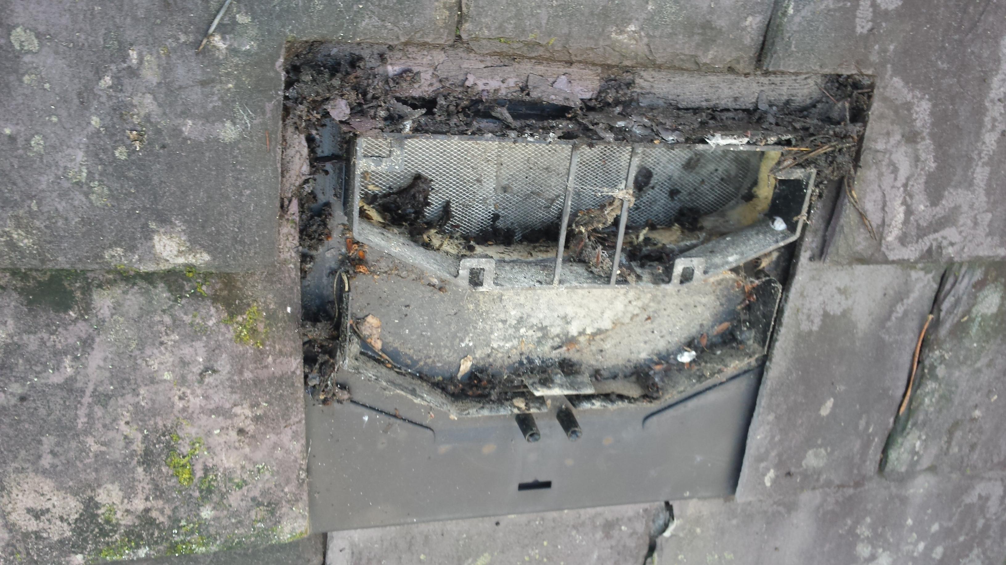

New Member (2/5)

  1. I have 32 of them so quite a big job to replace and unless I can use a hook/tingle then virtually a reslate. I will email their technical people to see what they were thinking. Since I have membrane and sarking I don't really need them, so I could just fill with foam.
  2. Thanks Jack - good spot - that is it. I have looked at installation instructions and yes they are oriented the right way. But this makes little sense to me why have that lower compartment and lip. When the slates are butted up close to the top lip, the gap fills up with debris and water can run straight in. I have cut back the slates with a grinder to make a channel and also used silicone to seal cap to slate but don't know how long it will last. Anyone else used this piece of crap?
  3. I guess a real pain to reverse these. For the lower ones which have insulation underneath anyway, could I get away with just sliding thick DPM underneath.
  4. Thanks. Even if reversed there would be a gap in the (new) top lip which seems odd. Any idea what make these are. I cannot find anything similar on the internet.
