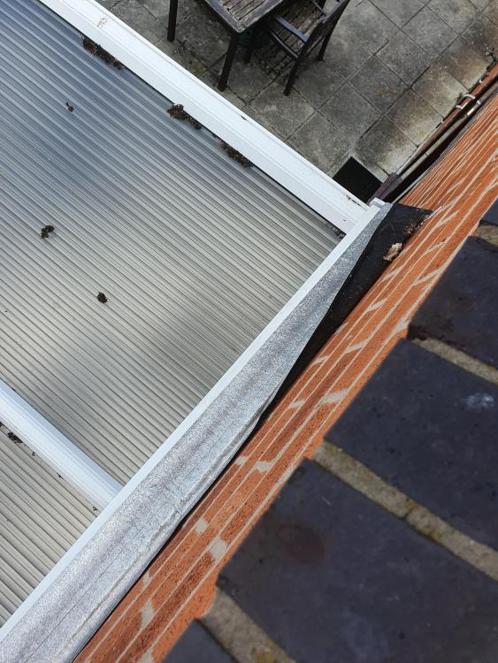

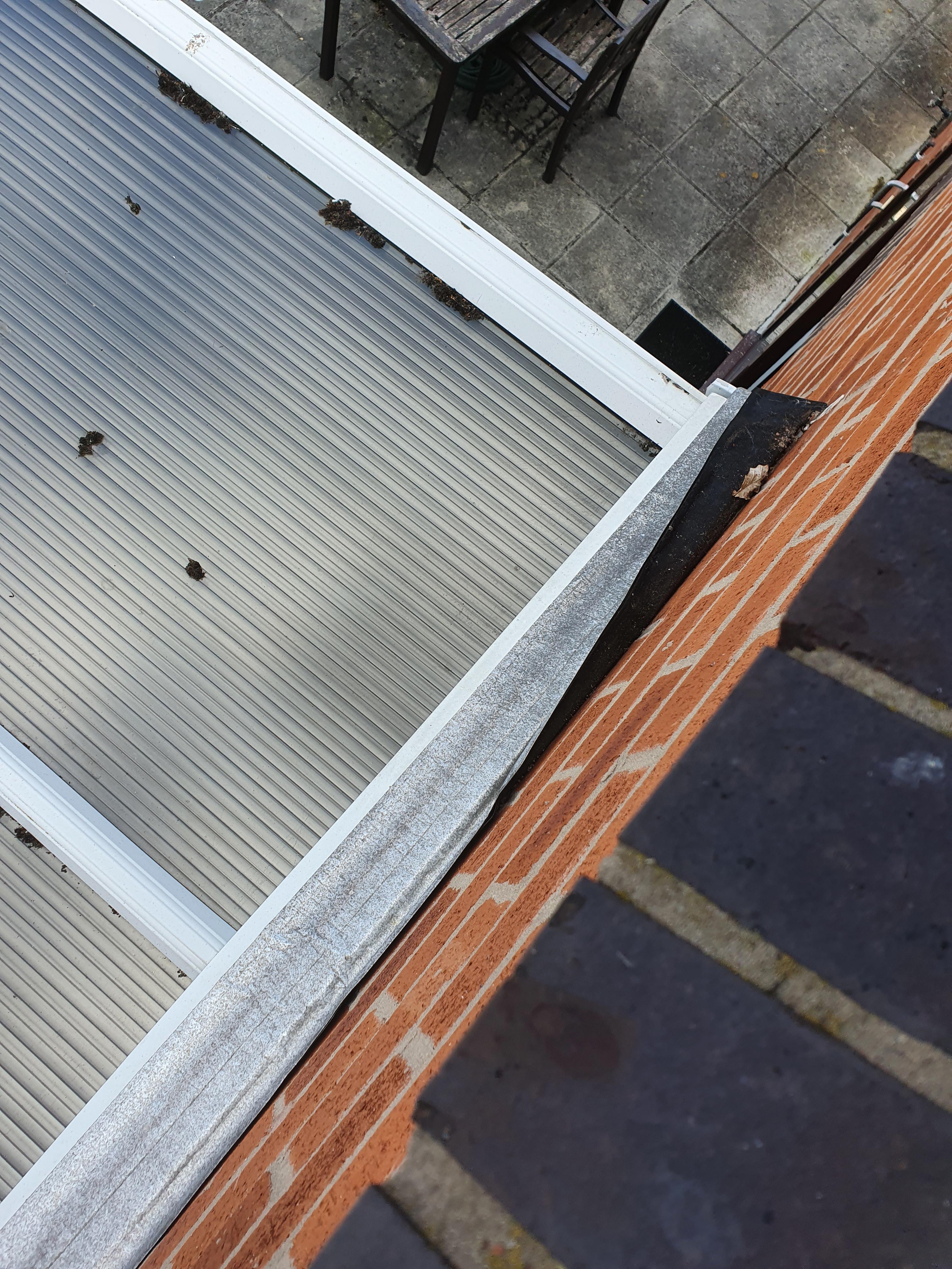

Conservatory flashing coming away from the wall
Josh95 replied to Josh95's topic in House Extensions & Conservatories
Brilliant thank you for your advice! You've really helped clear things up. I'll give your suggestions a try and go from there. Thanks again! -
Hi, I'm hoping someone can advise if possible please? I've recently moved into a house with a conservatory and noticed that part of the seal between the house and the conservatory roof (I believe this is called flashing but not sure?) Has bent away on one end. From what I've seen online, this flashing should be mortared into the wall. Was this an incorrect installation from the beginning or just a different way of doing it? Any easy fixes for it would be appreciated. Pic attached. Thanks, Josh

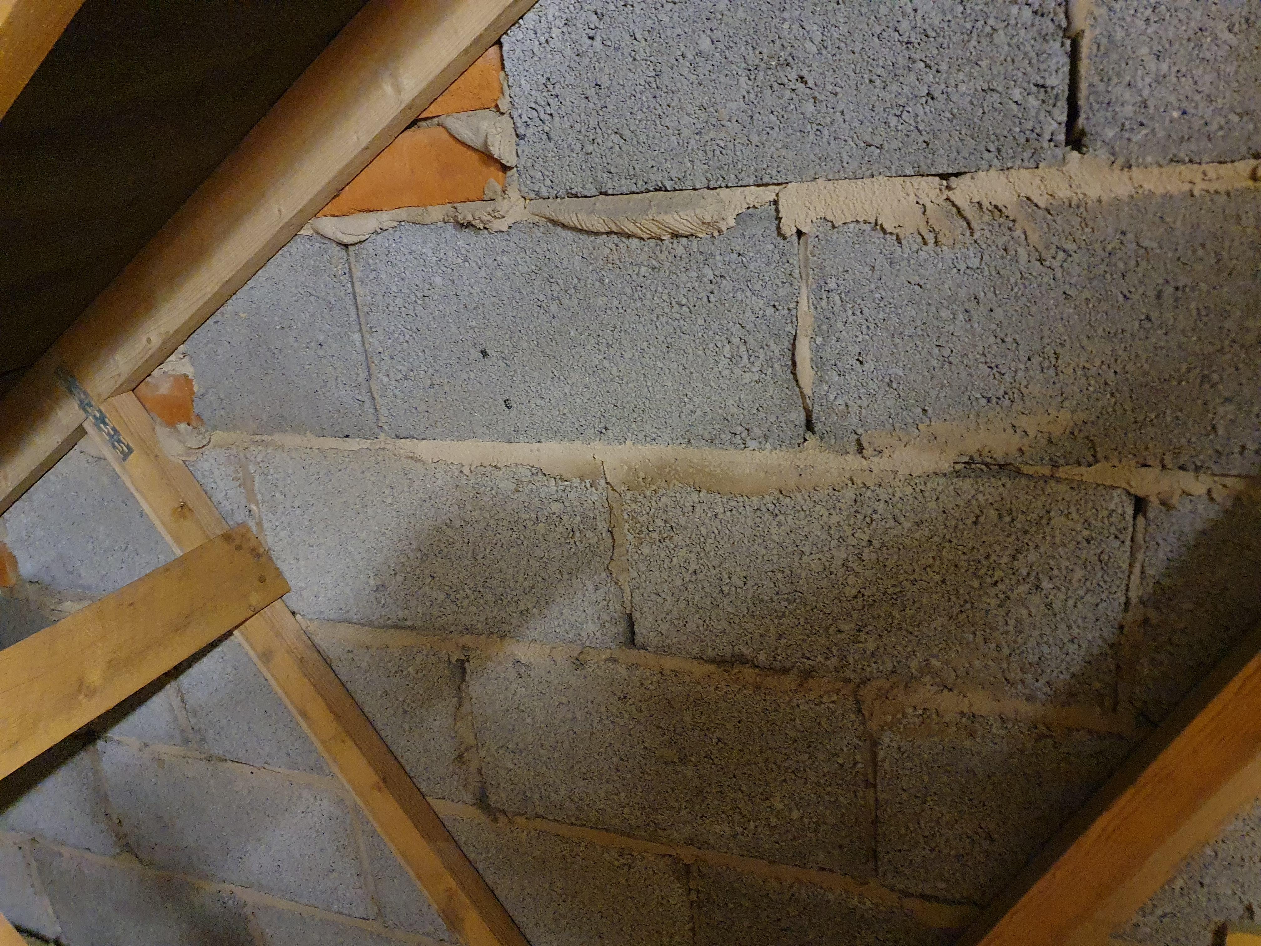

Thanks, just had a read of that link and it's very interesting! The attention to detail when building these houses appears to be non existent. If the visible part of the wall in the attic is to go off, I imagine the rest of the wall is filled with gaps just like this. Sounds like it's going to be very hard to retrofit without destroying the house in the process :(. Ive enquired with a few companies about getting the cavity filled as I thought this would be a cheap and easier place to start for atleast some levelling of sound dampening. Unfortunately nobody seems to want to touch it with it being a party wall. Soundproofing companies just keep mentioning removing dot and dab and attaching a clip to wall system with rockwool, techsound, soundplank and acoustic board but they never mention gaps, or the floor void so definitely useful information thank you! I have to admit, the sound does seem like it coming directly through the wall (as if it's a piece of cardboard) alot of the time rather than it sounding like it coming from edge etc but it's hard to work out. -

Hi everyone, fairly new to the forum and just looking for some advice in relation to soundproofing the party wall on a semi detached house. I've consulted with soundproofing companies online, I'm just wondering if anyone has had real world success with the sound proofing of a party wall? I'm cautious of potentially spending thousands for little to no gain. I've recently moved in to my first house on my own and immediately noticed I could hear the neighbours voices and footsteps on the stairs and upstairs footfall (especially when their kids are running around upstairs). From looking in the attic I can see that the party wall is of a breeze block construction with a cavity. The wall has noticeably bad mortar joints in the attic atleast (pic attached) which I'm guessing could be a major contributor to the sound transfer if the wall is like this throughout. All of the walls in the house are also dot and dabbed. Annoyingly the staircase goes up from the living room along the party wall so I'm cautious that losing between 6-8cm on the wall of the stairs could be quite intruding. So on the party wall I have the hall, living room running up to the landing, the box room, dining room and bathroom. Unfortunately the dining room and bathroom would be far too Intrusive to get done as they've fairly newly decorated with the bathroom suite and tiles, cupboards etc. I've lived in a semi my whole life and Never experienced anything like this. Any advice would be greatly appreciated. If anyone's soundproofed a similar layout? Thanks, Josh
