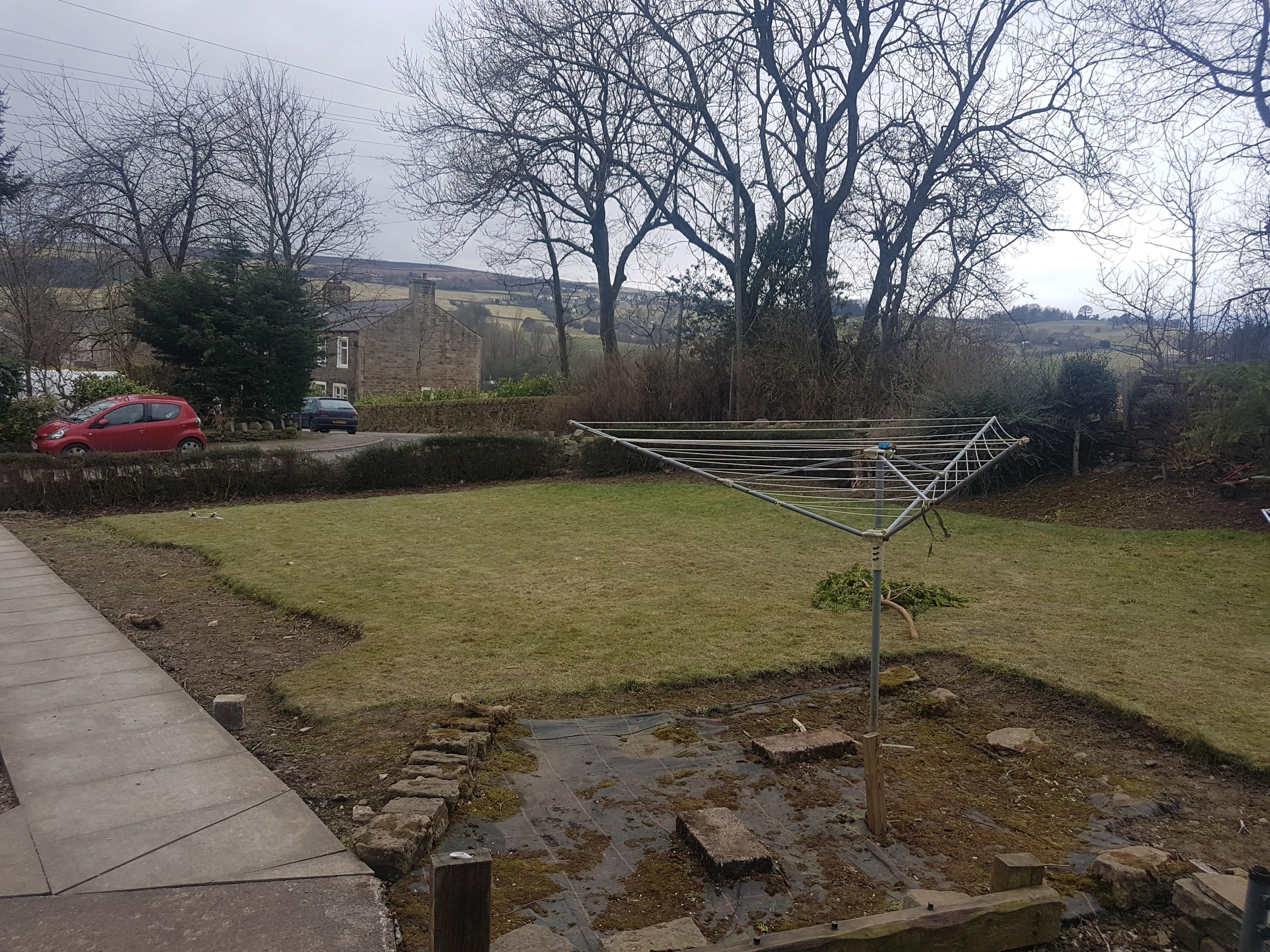

  3. View from bi fold door position.

  5. Hi everyone, we've recently moved house to a great ex authority semi detached corner plot. The garden is huge which is great as we have 2 kids and love being outdoors. We've had plans drawn up for a side extension which includes bi fold doors at the front onto the South facing garden. The front garden is the biggest by far and at the back the doors would look onto a 6ft retaining wall with a 5 ft fence in it so it's the obvious best place for these doors to go. Planning are already unhappy because they don't like doors on the front and are suggesting we put them on the back. I'm wondering if anybody has any advice on bringing them round to our way of thinking? Any advice is very very much appreciated. Thankyou in advance.
