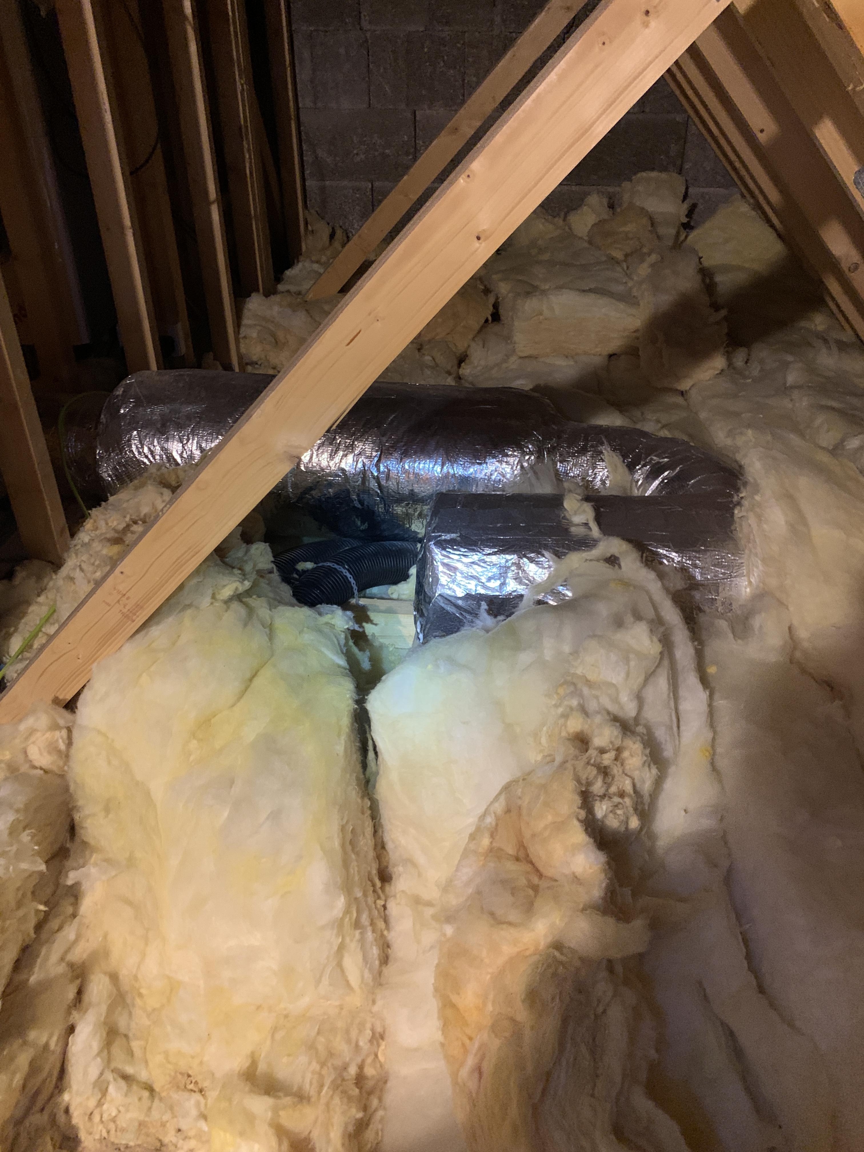

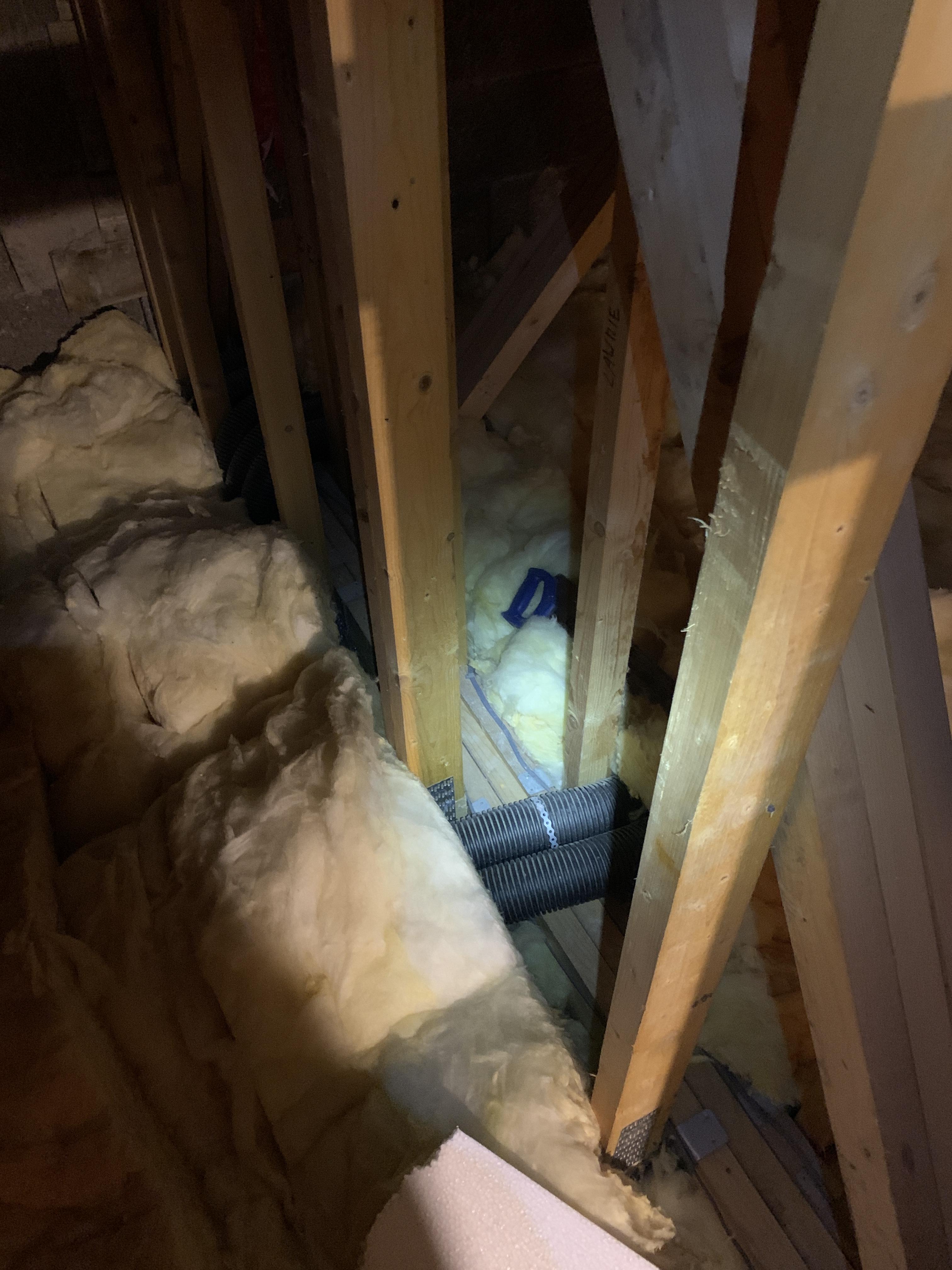

  2. Thanks Dave, Fortunately we do have a reliable thermometer and I’ve been logging the temps in bathrooms, ensuites, kitchen and utility. One bathroom, seldom used, is markedly colder but i’m still surprised the extract temps recorded by the MVHR are so low. Im thinking to add extra insulation to the gaps show in the pics and work on warming *all* the rooms that the MVHR will be extracting from. Does the fan speed make much of a difference to the supplied temps? Should the rooms where air is extracted from have doors kept closed with a good seal to make sure they only get the warm/humid air (as opposed to the cooler air that’s being supplied back in) Thanks, Nick

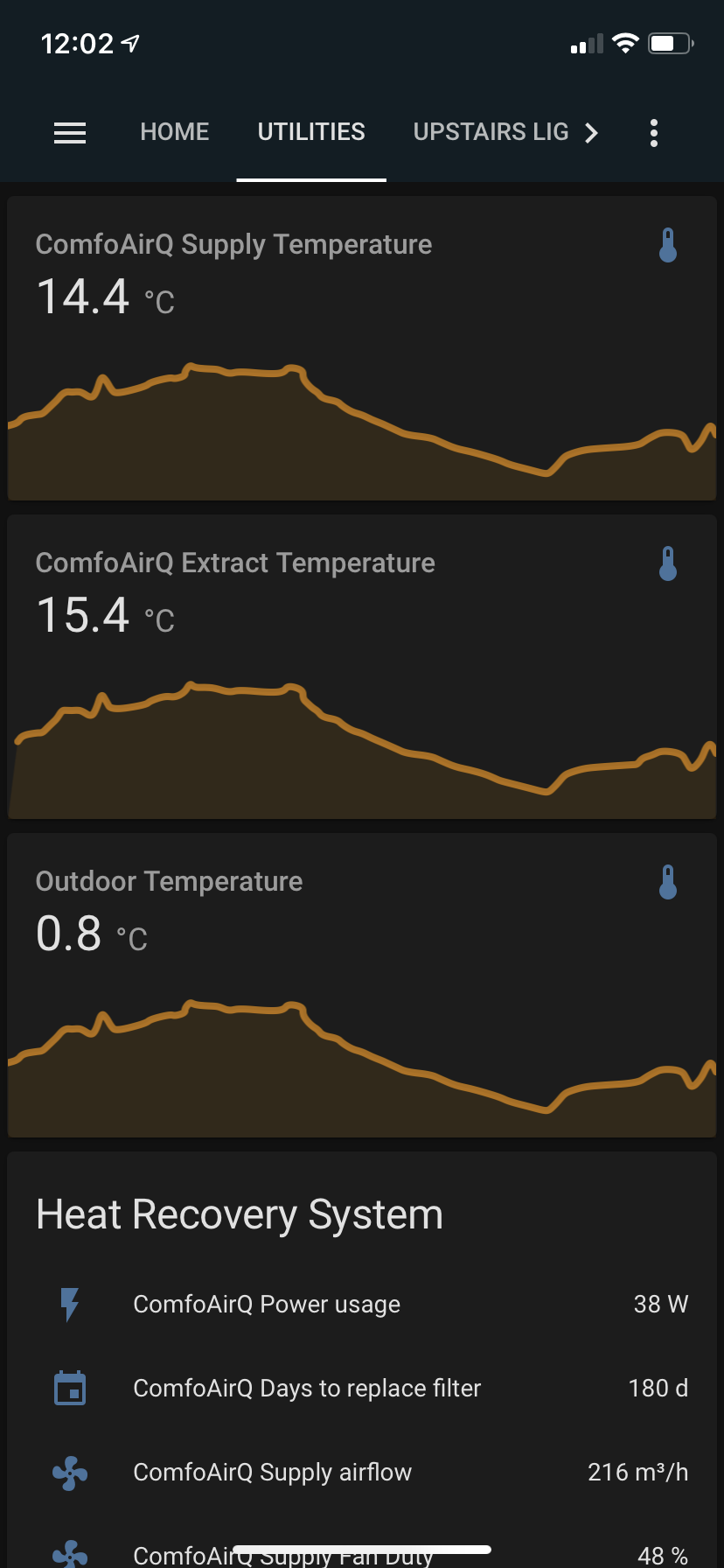

  3. Hello! I've a Zehnder Q350 in the new build which we've recently moved in to. I connected it to the ComfoConnect app which allowed me to see what's going on with the temps. I'm barely getting above 15degs supply and only 16degs extracted, but all the bathrooms and kitchens are between 18 - 20. The unit is located in the loft, however the ducting seem fairly well insulated save for some spaces where the ducting bridges the studwork. Pictures attached, could this really drop the temps by that much?? All the filters have been changed this week too. The house isn't massively warm, I need to start another thread about the temps the Nibe Heat Pump is able to generate to the UFH, but it's certainly not helping that the MVHR is supplying such cold air. Any advice on what I could look in to next? Thanks in advance, Nick
