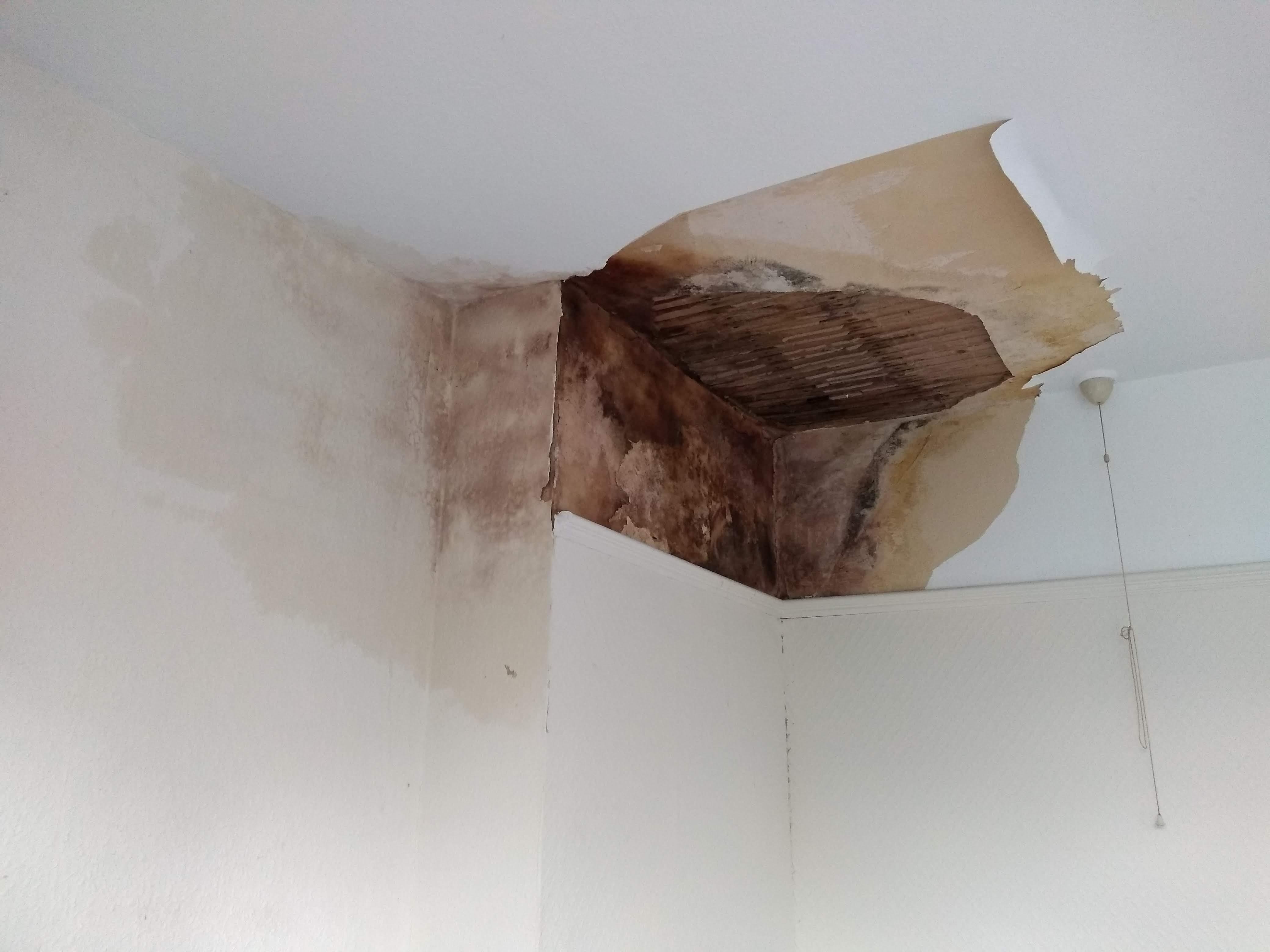

	Last year we noticed a growing damp patch on the inside of a gable end wall next to the chimney breast in an upstairs room. It eventually got so damp that part of the ceiling collapsed. We hired a roofer to fix the leak but despite having a new roof on half of the house and having the chimney repointed and reflashed, the internal wall and ceiling are still damp. We’ve had a dehumidifier on full every day but it just isn’t drying out. There is some cracking to the rendering on the external wall although it’s not exactly where the internal damp problem is. We’re also aware that we have a lack of ventilation in our loft space but could either of these things be causing such damage? I’ve attached some photos. Can anyone please advise what could be causing the problem and how we can fix it. Many thanks.

	We have a very low pitch on the roof so we can't really get into the loft to see. One of the roofers did crawl through and said it was lacking ventilation but it wasn't evident where the water was getting in. Now that the roof has been re-done and the chimney re-flashed, we think it's probably getting in through the chimney somehow unless it's possible that the external rendering could cause this extent of damage?!?! I've attached a photo of the damage from the inside and you can see that the chimney breast and the adjacent wall are very damp!

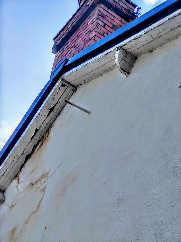

	Our roofer didn't mention the pointing but the second guy we had round (the one who took the photos for us) did say that the chimney needed pointing. There are two chimney pots which have bird mesh over them but they don't have actual cowls. Apparently the cement flaunching was cracked too but the roofer says he redid this when he was up there this most recent time. I've attached a photo although it's not very clear. When we've had a few dry days, the damp readings do go down yes, but as soon as it rains, they go back up again.?
	So the roofer came back and has redone the flashing, replaced and repointed the ridge tile and cleared up the debris. He didn't change the dry verge. Unfortunately, it still doesn't seem to have fixed the leak. We bought a damp meter and have had a dehumidifier on all day every day but the internal wall just isn't drying out. We are thinking of asking someone to repoint the chimney and then paint it with a breathable sealant. Does this seem like a sensible next step thing to do? Or could the problem be down to the rendering on the external gable wall and nothing to do with the chimney? I guess I'm just looking for suggestions as to what to try next really. I have 2 young children and have had a damp, mouldy wall for almost a year now. I just want to get it sorted. Any help or advice would be greatly appreciated!

	We have We have no way of getting up there to take more photos but the ridge tile with the big gap in the mortar is the one next to the chimney stack and is directly above where the ceiling has collapsed. The third photo above showing the "sticky flashing and the black plastic trim" is the gable end wall on the opposite side of the same chimney stack. This is the wall which is damp both inside and out. In summary the damp wall and collapsed ceiling are below this chimney stack which sits about 1 foot in from the gable end. I hope that makes sense! ?
