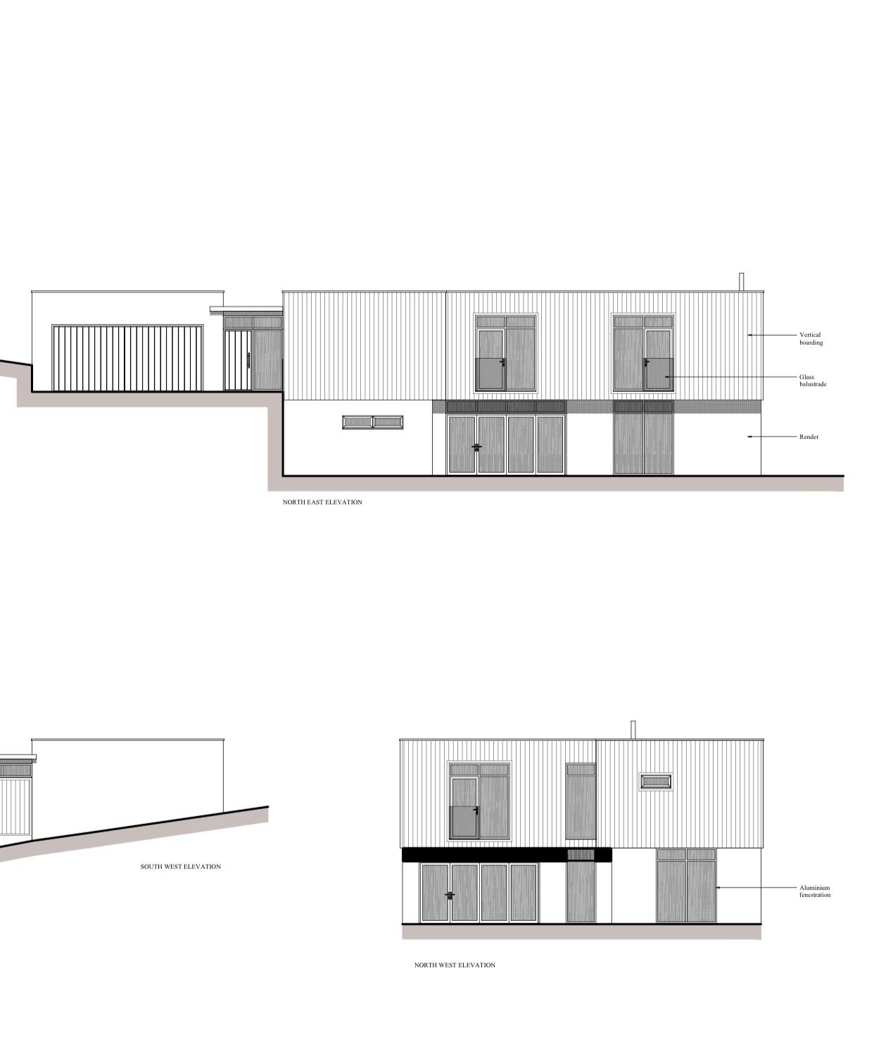

  4. Evening/morning and afternoon. hey guys just after your thoughts really on what 30k should/could get me with internorm. I’m only after Alu clad upvc due to the pine not really matching the feel of the house. I’ve had a quote for £28k for around 48m2 of glass. This doesn’t include a front door or rear but it does include three of their special Juliet balconies which I love and two lift and slides at 4metres wide. Part of me thinks this is a fair deal but is there some of you that think I could do better due to the fact it is mainly upvc after all. thanks jas

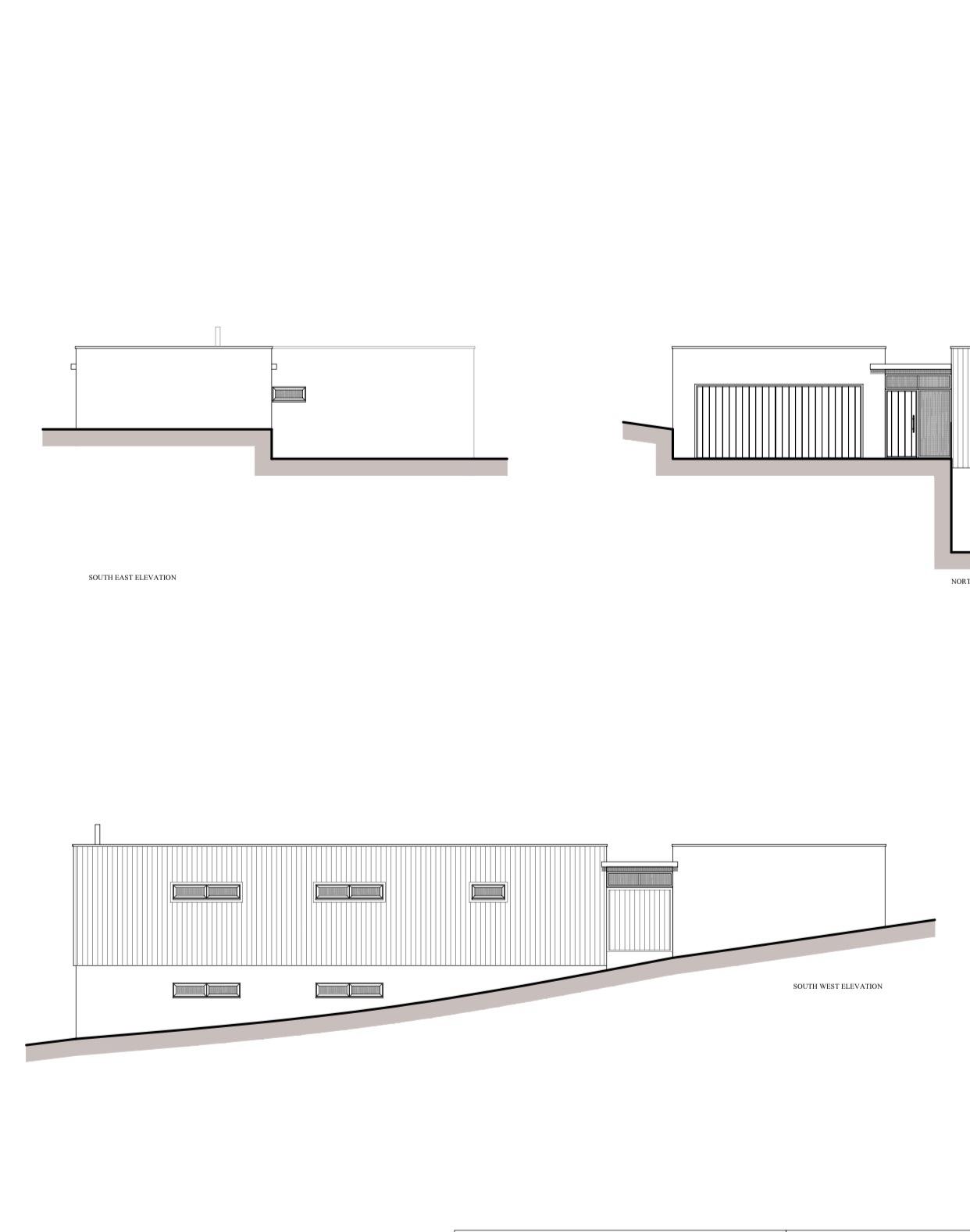

  9. Evening guys. Like the title suggests I’ve been an avid scroller looking over years of content to help push me in the right direction but think it’s time to sign up and ask for advise from you guys. I’ve finally achieved a breakthrough in my planning application and in the final stage of building reg drawings. My advise is going to be on a self build I hope to get underway in March with weather depending. I’ve gone the icf route as I’m building it in to a bank. I was going to have a 1st floor in sips but they’ve come back with a silly price and don’t want to get involved in the 1st floor contraction/ detailing so I thought stick with the icf by nudura. It’s a flat roof construction as I will be having a wild flower roof and solar panels so my neighbours continue to enjoy their view. I’m sure I’ll post questions along the way but being in the building game for a wee while I know enough to construct most things myself but I’m at a loss at the minute when it comes to windows. I’m not building passive by any means but the roof and floor will come in at 0.12U and I’m told the icf will be 0.16. I’ve probably got 35m2 of north facing windows. I’ve had a quote for internorm as I love the Juliet balconies they do but was wondering if you guys think I need to go as deep into passive house windows as they are. Is there possibly other manufacturers that would be cheaper but almost achieve what internorm offer and do I need these low arse figures. I do want as e o friendly house as possible. All be it from a monolithic concrete structure I know!! Many thanks for any advice. jas
