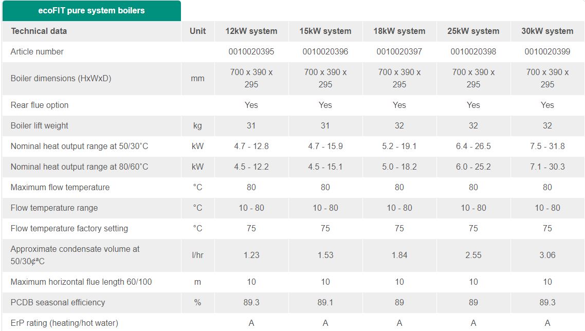

Guys you have all been very helpful previously and wondered if anyone that is mathematically inclined could look at the doc attached ( boiler spec ) and tell me how much it would cost using the 30KW boiler to heat a 250L water cylinder using the cost per KW/hour detailed in the link below - BUT the unit cost in the link below for LPG is now 48 pence per unit not 36.75 as detailed in the link http://www.nottenergy.com/energy_cost_comparison/ I am trying to work out the cost saving of installing solar thermal which would heat a 250L tank to a usable level nearly every day April - Oct Is there enough information in these 2 documents to do this calc? Thanks for any help
