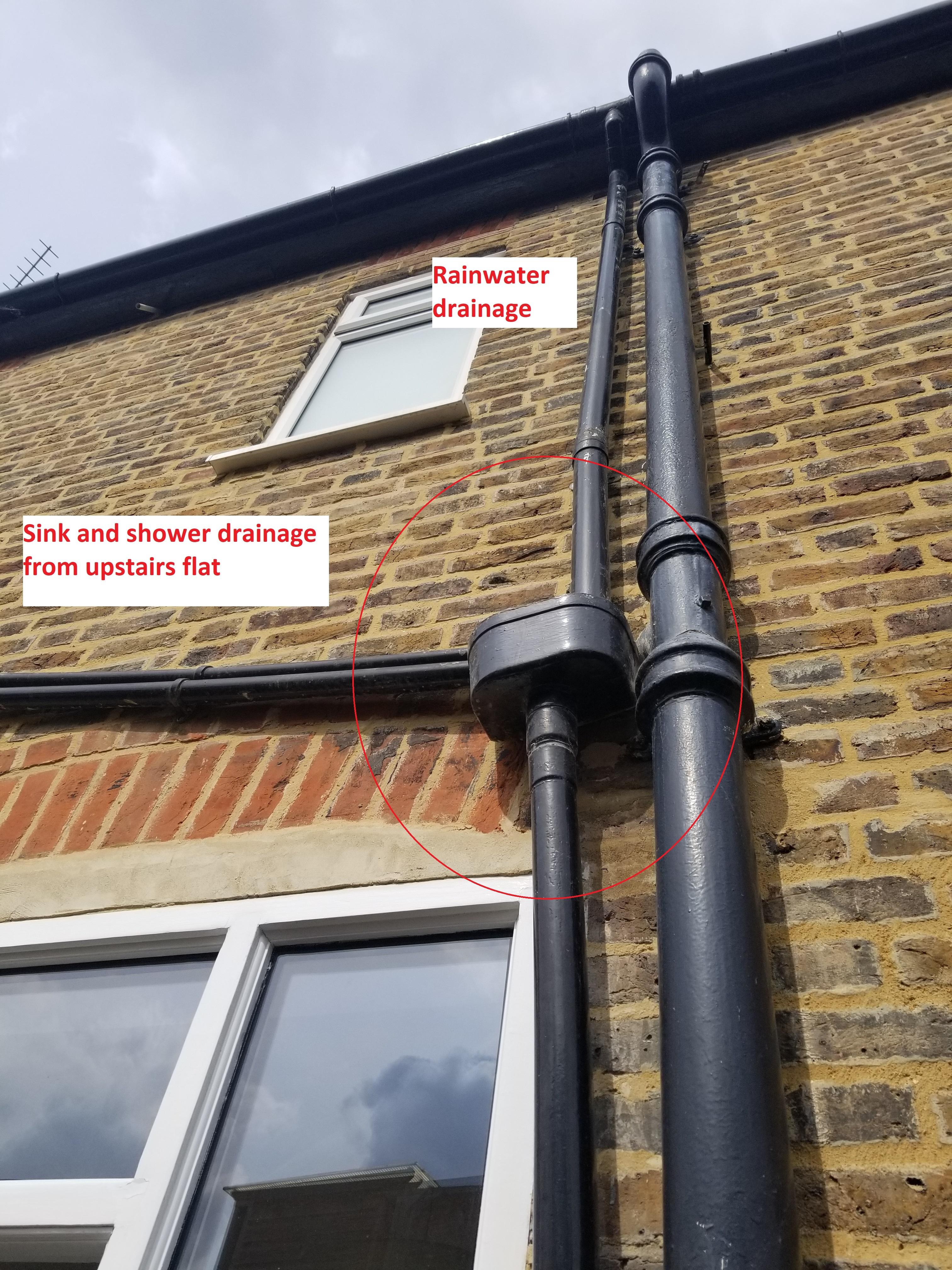

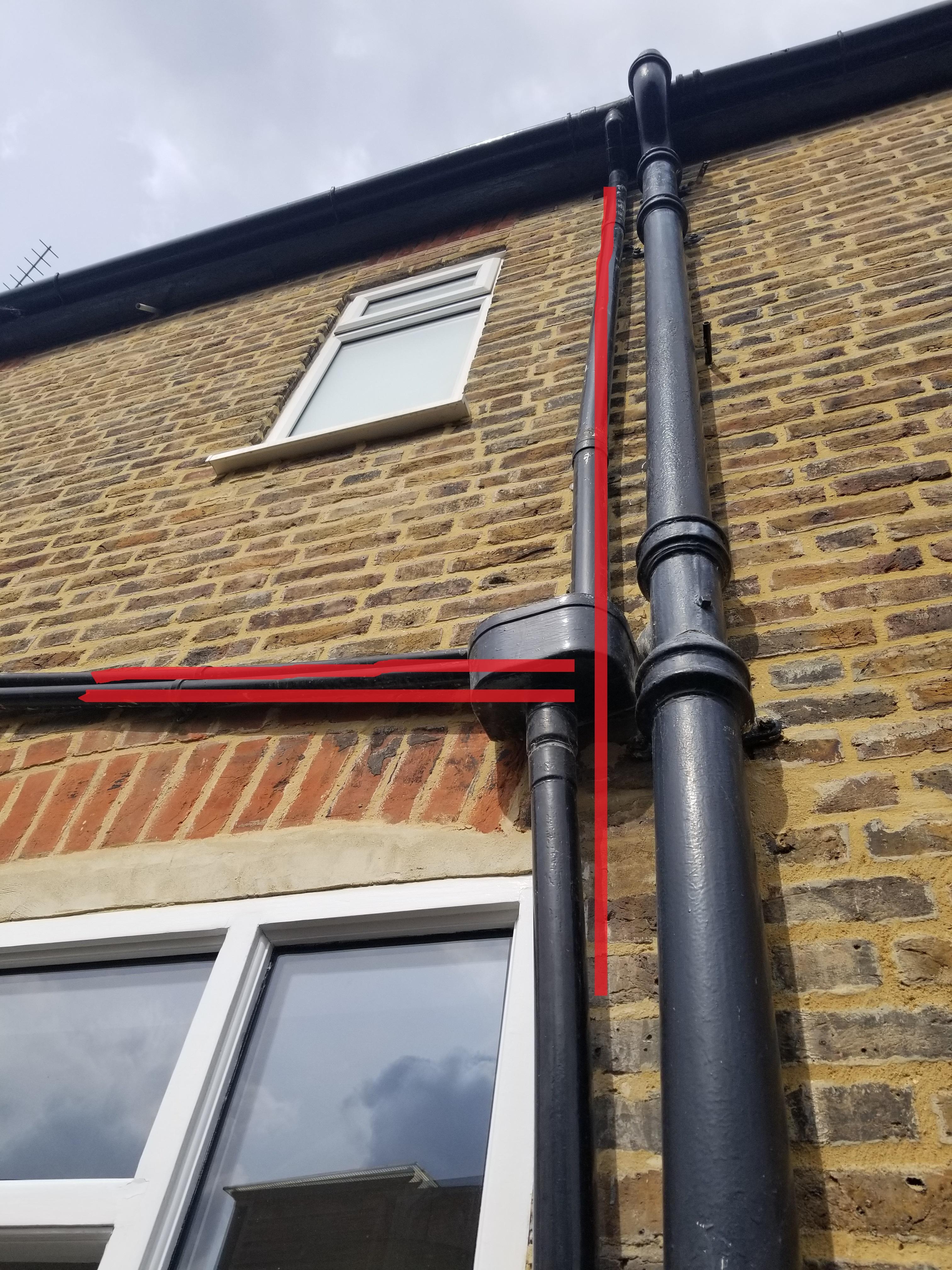

  1. Just wondering if anyone had any ideas how to fix this and get rid of the open hopper, see pic, have rainwater running into an open hopper with upstairs flat's bathroom sink and shower waste, all goes into an old Victorian combined communal sewer, everything - greywater, sewage etc. Have had some works, new front door etc all looks very nice apart from this, open hoppers are a big nono with building regs apparently as is unsanitary, does a stack exist where I could join it all into one -see pic? could I join the 2 grey waste pipes from upstairs flat into 1 then connect onto rainwater drain pipe? - also hopper currently pushes the drain pipe out at an angle which also looks awful.

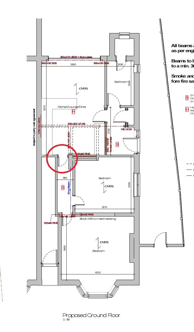

  2. Bit stumped here, just wondering if I need a door to the kitchen from the hallway (circled in red on pic), would be great not to have a door here. Ground floor flat conversion - all bedrooms have fire escape windows and a means of escape, building control have said I don't need fire doors, have mains wired smoke/heat alarms, kitchen oven extractor ventilated to the outside etc etc. Any help would be welcome! Cheers

  10. Thanks for the reply DevilDamo, Yep that's - the top floorplan is before, the bottom is after I converted the flat. Basically the BCO wants a door reinstated between the hallway and the living room, after I enlarged the old existing door opening and put an archway in - creating one general access room like you say. Problem is reinstating the doorway creates a tiny hallway which seems mad to me where you open the front door and you block the door to the living room etc, the flat is small as it is! have a virtual tour link you can look at I made when selling the flat- https://my.matterport.com/show/?m=JcjwZ5YfNJe&brand=0 I have a fire escape window in the bedroom, and the flat is first floor so the inner room scenario is allowed. A different BCO is coming tomorrow for an inspection, no one's been round so far to look so will be interested to find out what he thinks,. Some of the stuff the BCO has said so far; "Protected lobby - Protected lobbies are designed as part of the communal flats means of escape strategy as you have now removed the internal door to the newly formed bedroom you have compromised the fire strategy for the building".........But the newly formed bedroom has a door? "A FD30 door is required between dining room & protected hallway in accordance with Approved Document BV1" ....Which seems to me slightly over the top having so many fire doors in such a small flat. Before I started the conversion in the old layout the only fire door was the front door.. and also I don't have a dining room The other thing they are adamant on is mains connected smoke and heat alarms everywhere which I know is now a requirement, but also a fair amount of work getting them interlinked and wired above the ceilings etc.
