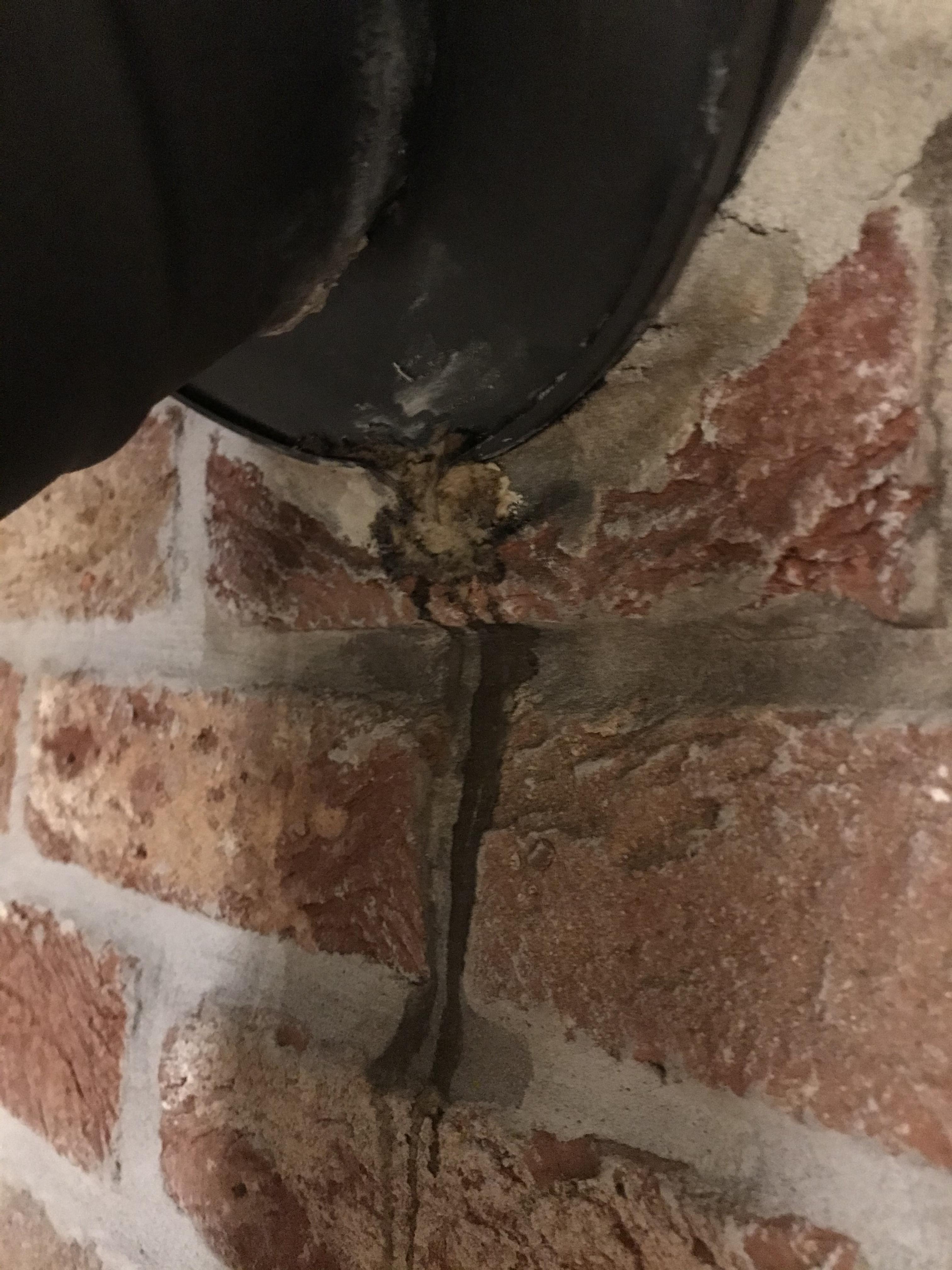

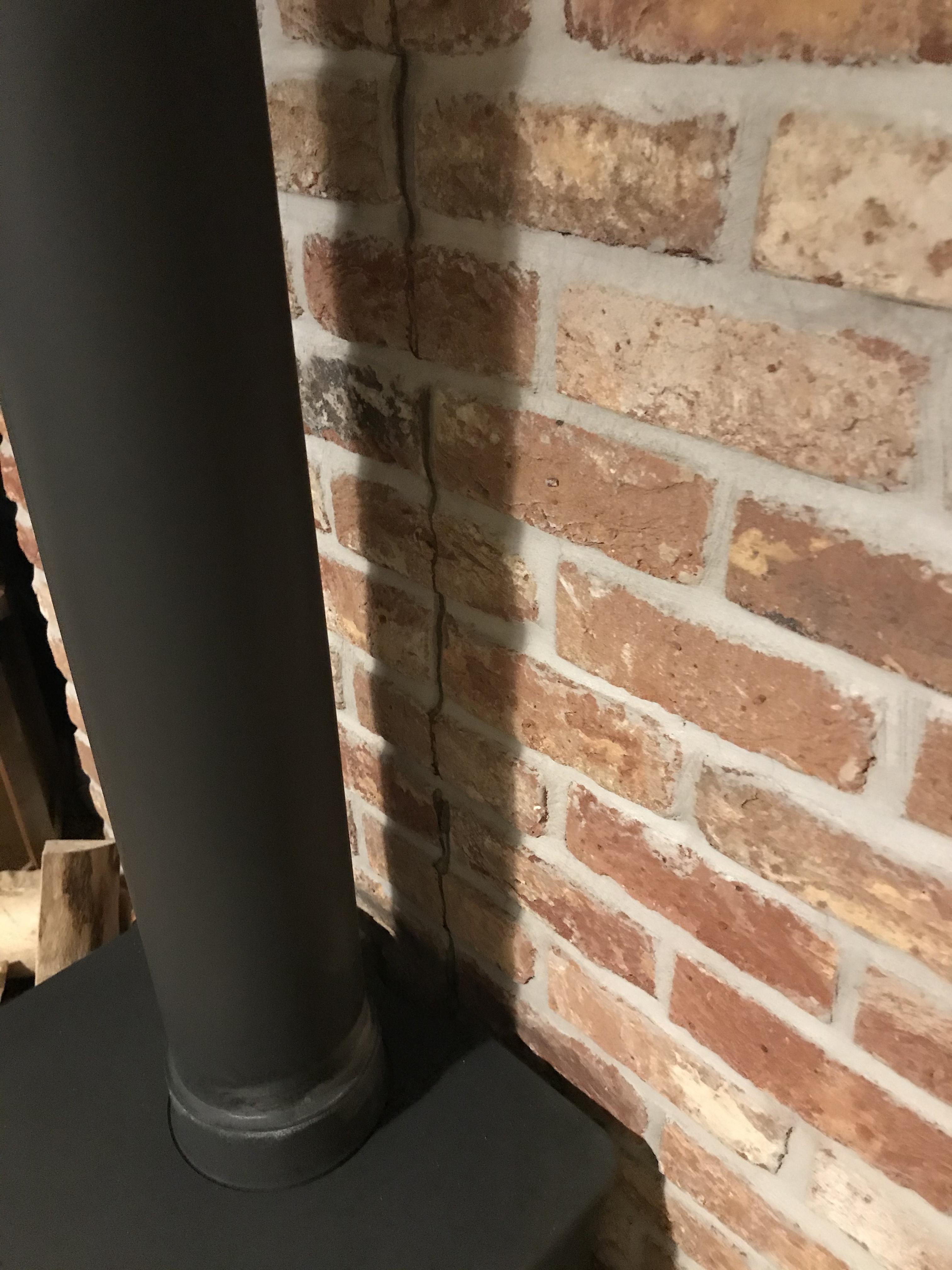

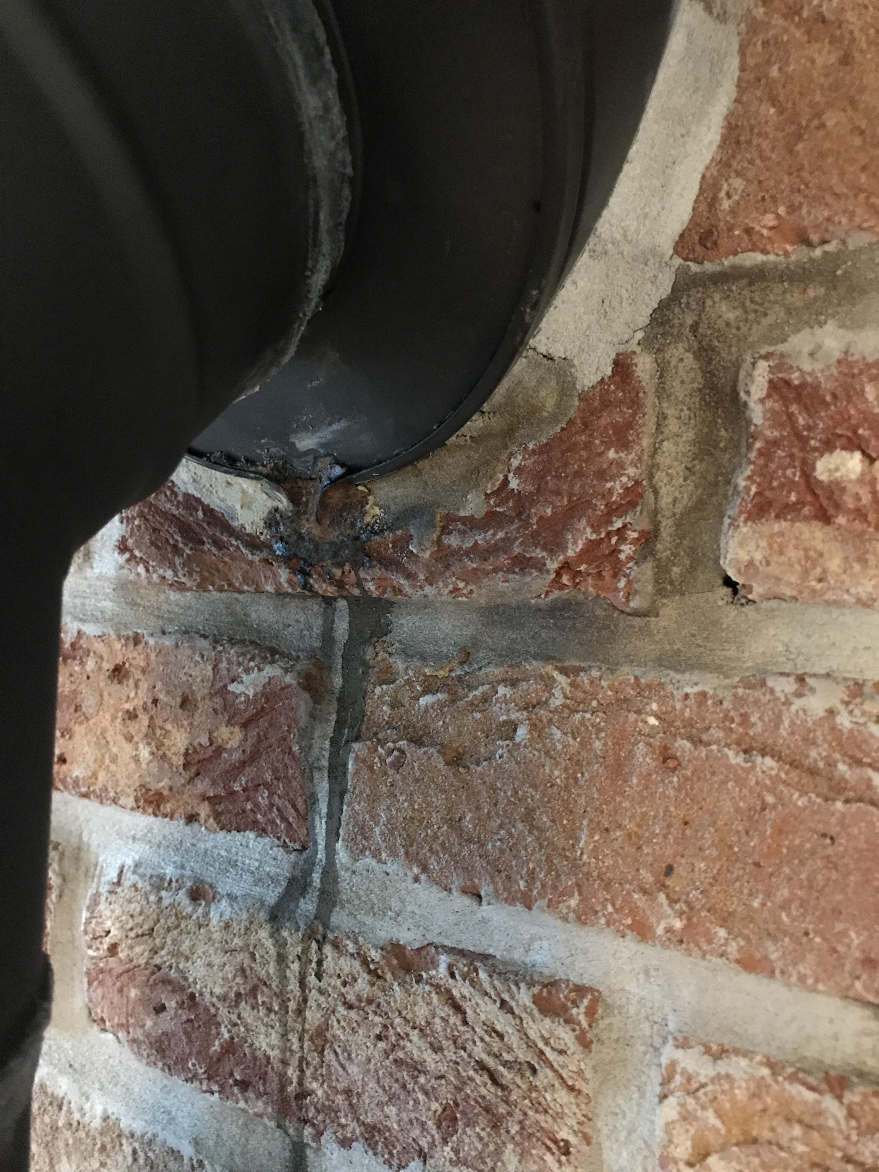

  4. Thank you so much to everyone for your replies. The guys from the fireplace centre never even mentioned condensation and said it must be rain getting in from outside! Thank goodness for forums like this! @PeterW I have added some extra photos below. Do these help? If not please let me know and I can take some more. The leaking water also seems to have made the pointing/mortar surround the flue damp and discoloured too, even though no water is directly leaking onto this area (see photos below). Could this mean the water is seeping in behind the brick slips as well?
  5. Mr Putner-thank you for your reply. Someone else has mentioned condensation which would make sense as the water isn’t always coming through when it’s raining...it’s sometimes when it’s dry outside ambit we’ve had the fire lit too. Do you know if there’s anything we could do to secure the new join so that the water doesn’t get through there?? Or would this be something we’d need to get the guys from the fireplace centre to sort for us?
  6. ProDave-they had to remove the stove and bottom part of the flue to fix the brick slips. When they reattached the flue I think they had to add a short extension so that there was a large enough gap between the new brick slip wall and the back of the stove?? I’m assuming this must have something to do with the problem because the leak is coming through at the point where they reattached the stove. We couldn’t figure out where the water was coming from as sometimes it was coming through when it was raining heavily but then the guys who came to try and fix the leak told us to use the fire to try and dry everything out and then water was coming through after the fire had been on a while but the weather outside was completely dry. So it would make sense for condensation to be a cause if the problem. Before the brick slips the wall simply had a large sheet of fireproof material on it but I’m sure there was no leak before. I notice just about every minor issue with our house (much to my husband’s dismay!!) so I’m pretty sure I would have noticed a line of water on the wall before. With the condensation, is there anything we can do about it? There’s quite a bit of water so it’s not something I think we can just leave??

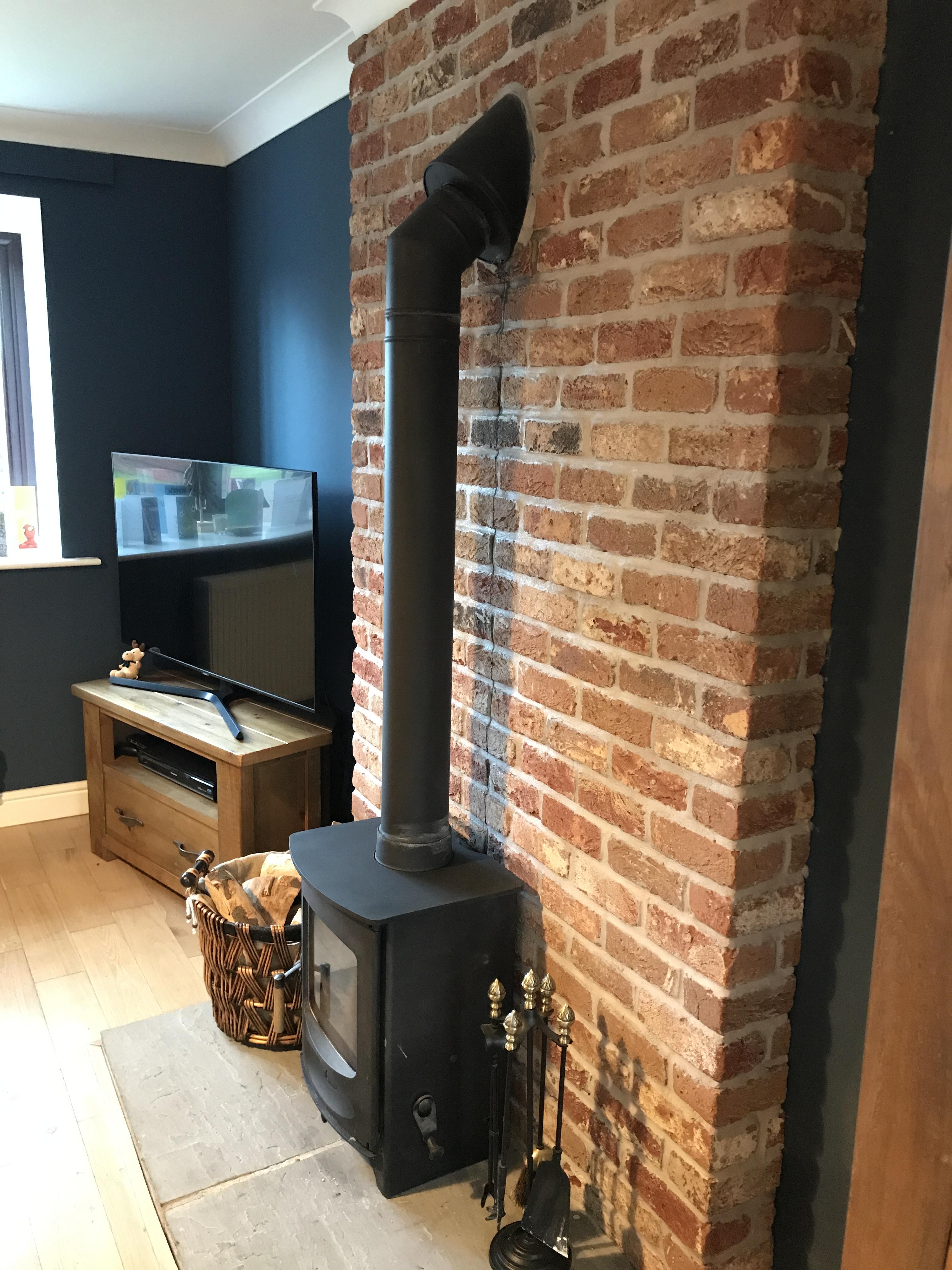

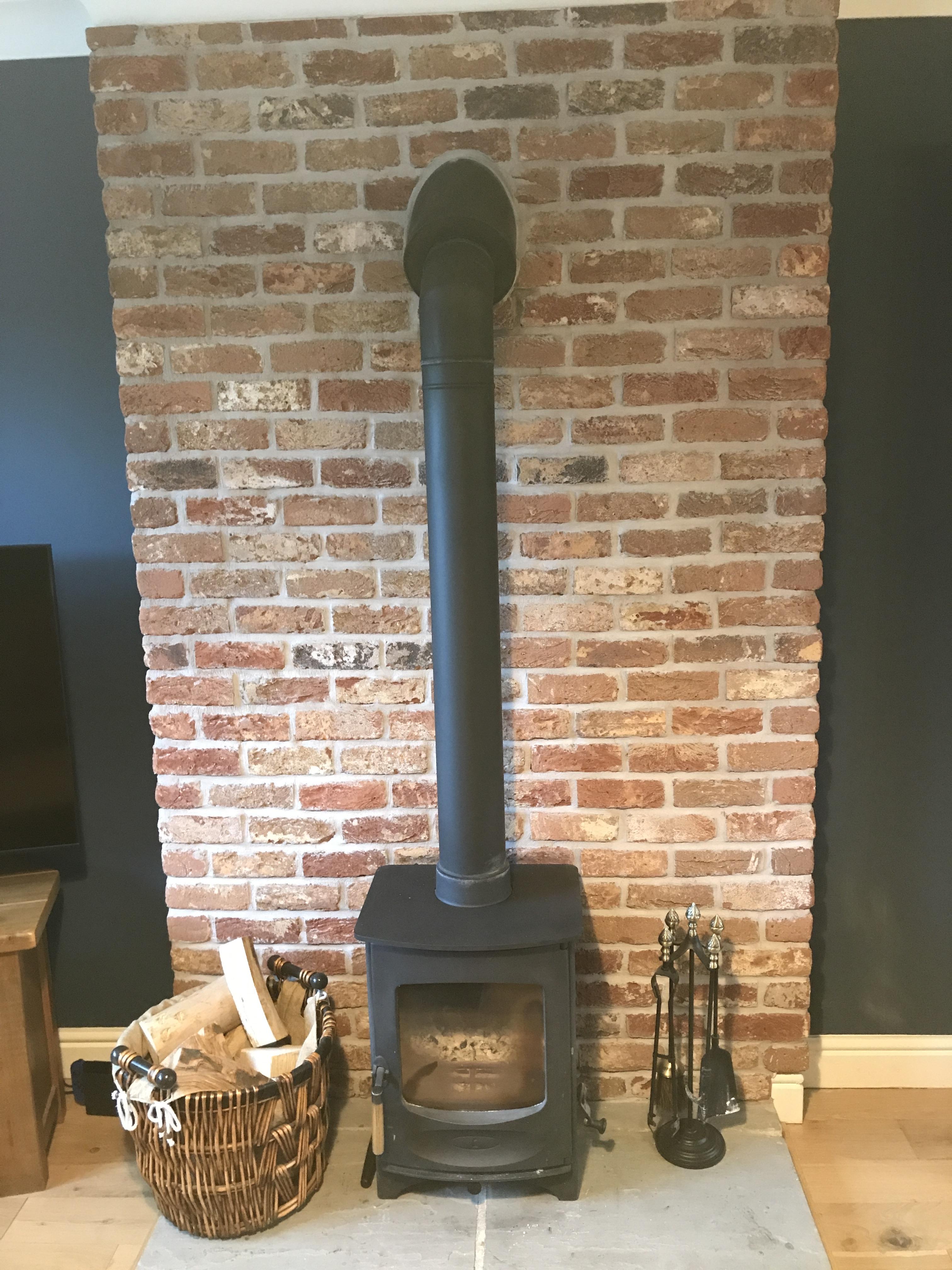

  7. Hi, we moved into our house a couple of years ago and there was already a wood burning stove in the living room. We recently had some brick slips installed on the wall behind the stove. Since then, we have had water leaking in at the point where the flue/chimney pipe goes into the wall to vent outside. The water is a brown colour so I’m assuming that means it must be coming down the flue?? There was never a leak before the brick slips were installed. The people who installed the brick slips were from a heating centre and HETAS registered. They’ve been out twice since the leak started to try and fix the problem but nothing they have done has worked. I think they’re at the stage now where they’re not really sure what the problem is so I’m trying to figure it out to see if we can fix it instead. I’ve attached some photos to try and show more clearly where the water is getting in...does anyone have any advice on how/where this water is coming in?? Any help massively appreciated. I’m hoping to avoid having to take all the brick slips back off again but it’s looking more and more likely that we’re going to have to in order to sort the leak ☹️ Thank you in advance to anyone who can offer some advice or help.
