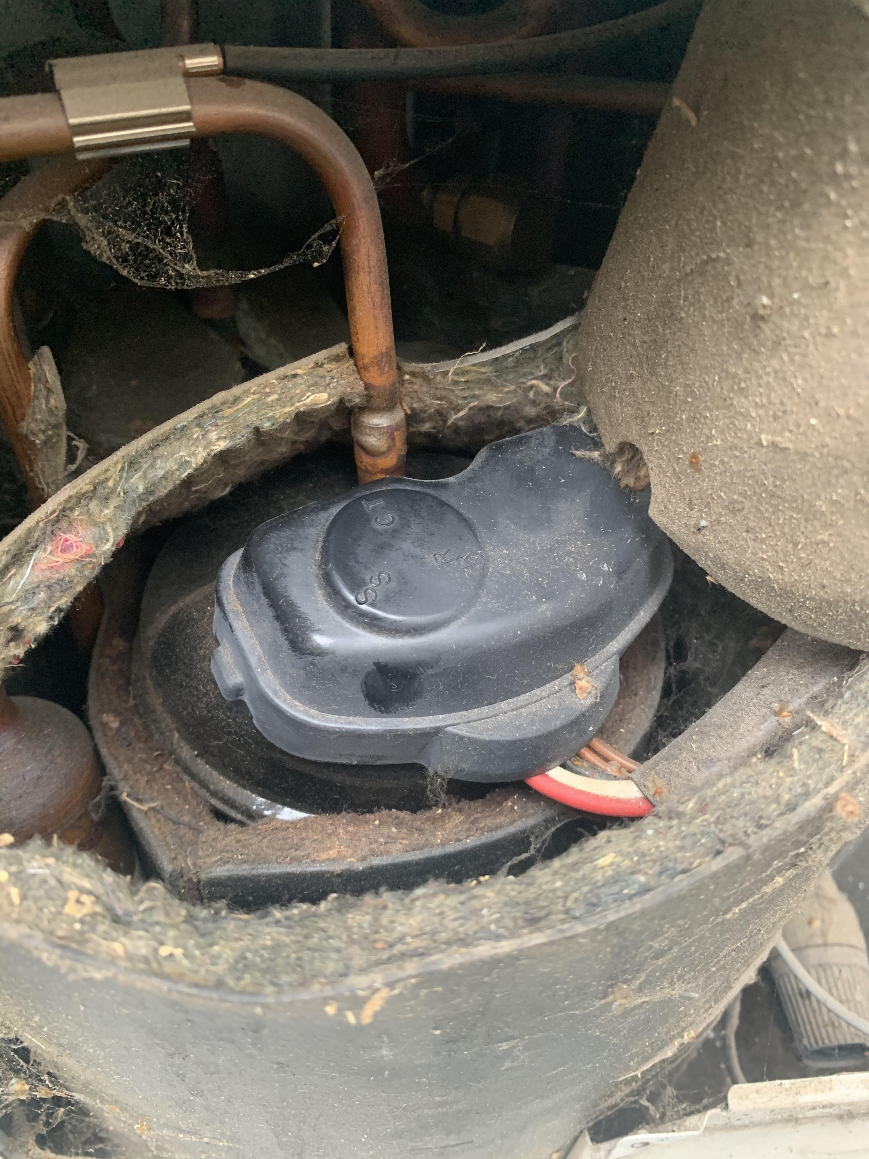

@joe90 yes we do thank goodness. All that is ok so at least we have hot water. Yeah today wasn’t ideal trying to sort the leak with the heavy rain etc. I’m quite willing to disconnect the unit and have a bash myself once I’ve taken the casing off etc exposing it properly. Thanks for the video link. @ProDave yeah he reckons the aluminum fins vibrate on the copper and wear over time. ??♂️ It certainly looked to be coming out of there, but like I say conditions weren’t ideal. I will definitely get a picture for you once I remove the unit, which I think will be after Christmas now. Yeah good idea, I’ve seen him strip down etc and quite happy to have a go etc, so I might just give your theory a test. He did say if it’s a case of re-gassing he’s more than happy to come and sort. -

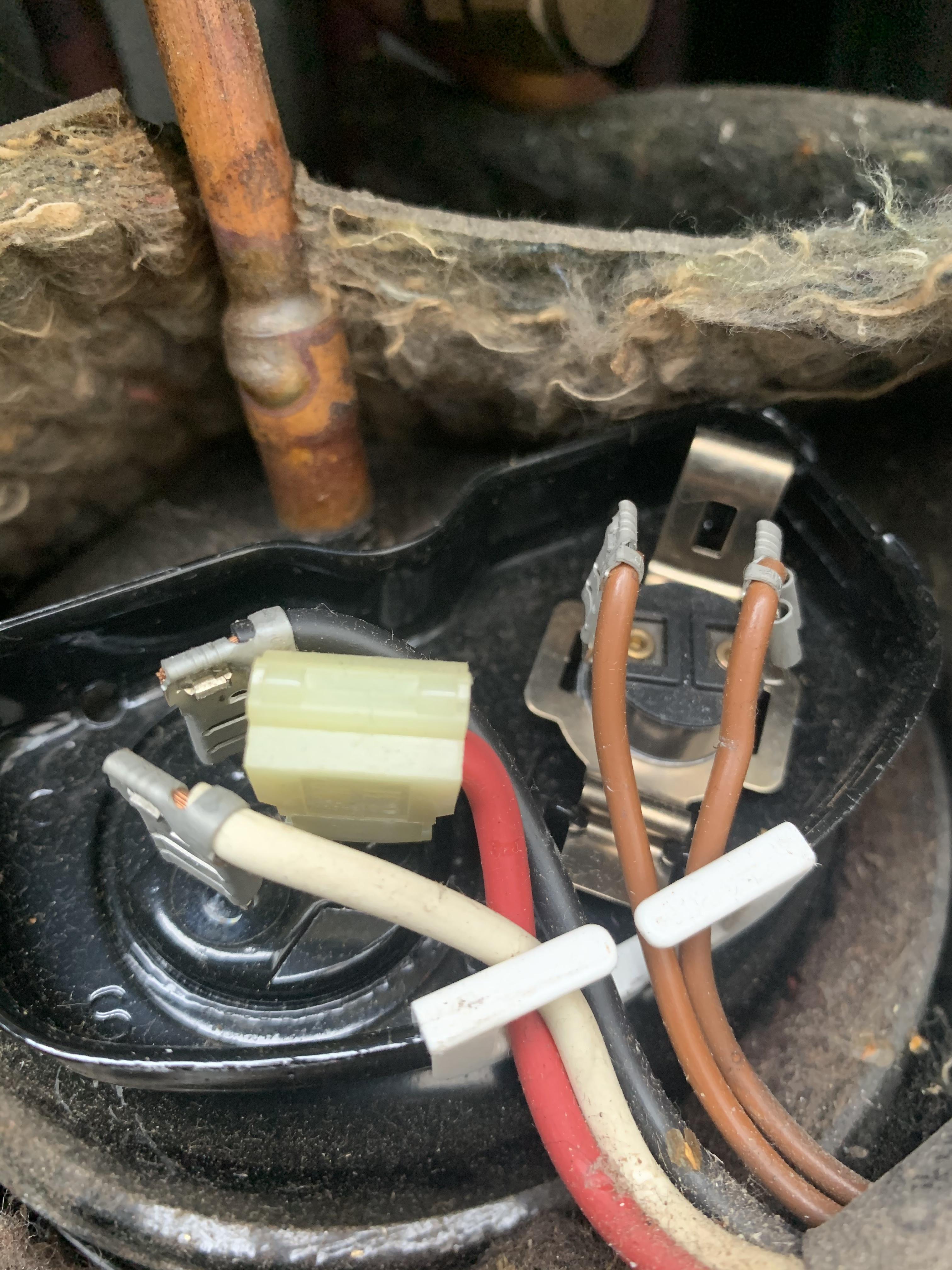

Hi, So just to give you an update. I’ve had a A/C engineer out this morning to look at it. He found there was absolutely no refrigerant gas in the unit. On further inspection he found the leak at the back of the unit on the heat exchange coil where the copper meets the aluminum. After trying to repair it by brazing it, it’s still leaking..... So unfortunately still no heating, but it’s not for lack of trying. So potentially now looking at another unit.... -

Thanks guys....so I’ve done what @ProDave has suggested and called for heat. It started this way last night, but now the error code 14 flashes straight away and no fan starting today now. Last night there was a clicking sound upon ASHP starting could this be the compressor? @Gav_P i can have a look at this now, I’m guessing I’m looking for anything obvious. -

Hi guys, I’m Ross. First of all just like to thank everybody for commenting and helping people in previous ASHP threads. I’ve used these over the last few days to try and pin point what is wrong with my system. Unfortunately I now find myself in unfamiliar territory and seeking help from the experts. Please excuse the lack of knowledge I have and I will do my best to answer any questions. I am currently running a Kingspan aeromax plus ASHP with a Kingspan Aerocyl (single coil) cylinder. Last week we lost all the heating and hot water, a friend of mine who is an electrician came to have a look at the cylinder. Quickly he found the immersion heater had gone and so we replaced with a new immersion heater. This has now given us hot water once again. I filled the cylinder, bled the radiators, topped up the pressure on the expansion vessel, got rid of any air locks in the hot water. (I believe this is all that needs to be done) I have checked the two thermostats and when calling for heat, the pump kicks in and the ASHP starts up no problem. After 25/30 mins of running the pump stops and the error code flashes once then off for 2 seconds and flashes 4 times. Am I right in thinking this is error code 14? Ive also taken the front panel off the ASHP to reveal the led and this is flashing the same sequence. I have tried to find a command unit to try and give me more information, but I haven’t found one. So last night I took the 3 way valve off and made sure the valve was operating as it should and I can’t see any blockages etc so I have now re-fitted this. I’m really struggling now as I’m fearing I’m out of my comfort zone if the problem lies in the ASHP. I’ve spoken to a few local companies, but they are only available at the end of January to come and look at it. Obviously Christmas is approaching, so any help or advice is most grateful. Thank you, Ross IMG_7255.MOV IMG_7255.MOV IMG_7213.MOV
