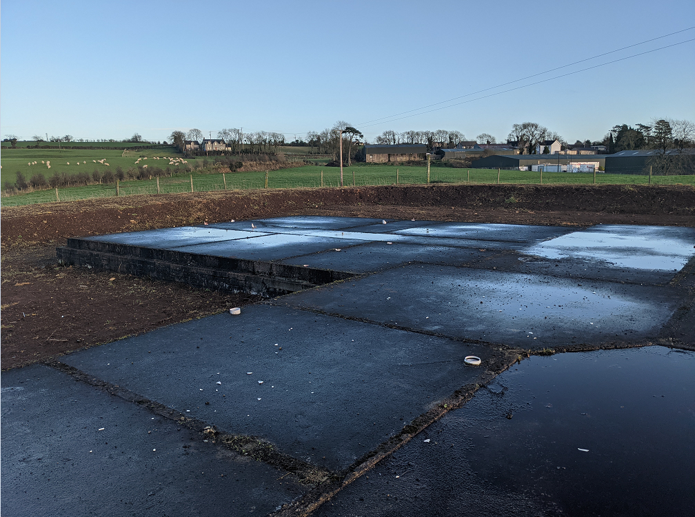

  12. Hey, I can answer some of these questions. I do have the drawings and it looks correct - If you can see in the picture there is several soil stacks and they all lead out to the ground outside. The excavated land was to meet the reasons of PP which said The depth of any underbuilding between finished floor level and existing ground level shall not exceed 0.45 meters at any point. @dpmiller I have contacted building control at the start of the week who gave me spiel about Data Protection under GDPR and they as such cannot give me the info I require - I have asked the Estate Agent to Confirm with the Vendor that they have a building control 'Pass' certificate and that the property was built within the PP time limit of 5 years. @Declan52 You are correct that is a space for the garage but I would probably not use to keep costs down. @Declan52 Whats the deal with the moss growing - Is that just an acid wash job to get that off. In your opinion is the founds OK. Finally the land is smaller than your traditional 0.5 acre but the view is over Lough Neigh from a considerable height. Land Owner wants between 60k and 70k - I have spoken to surveyors and architects who say to put in a much lower amount of 45k. The last question I have is if I wanted the footprint slightly smaller so that its a rectangle rather than the 'L' shape.is it possible to demo the back part of the house .e.g where the garage void is and bring it in so that its a rectangle. In effect building a new foundation strip + wall. If I wanted to inspect the foundations would the vendor allow this?

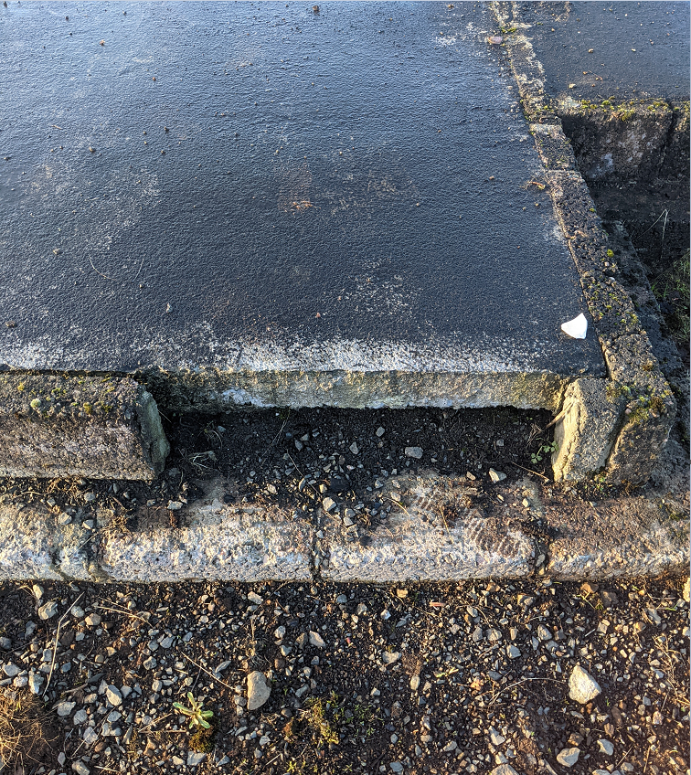

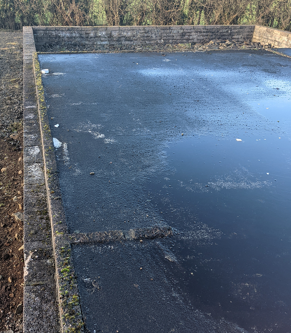

  13. I include pictures of the foundations. As you can see there is moss growing and the floor looks strange not like any concrete ive seen usually concrete is grey not a blackish colour? Also what type of foundation is this and why is it stepped like this. Is the lower step effectively were you start the outer skin / insulation. Can I salvage this site?
  14. Hey folks,. I'm looking at purchasing a site to build a bungalow the local land owner bought up fields and put PP on them prior to Planning Permission in NI stopping the practice. As a result to keep the PP active many owners built the foundation. The property I'm looking at has a foundation that was put in 10 years ago, would this be at all usable there's moss growing on the outer bricks but the concrete subfloor has no cracks etc. The foundations are trench fill the using builders blocks upto ground level. There is one parameter brick removed and below is what appears to be type1 stone and on top is 100mm solid concrete in each room. Presumably this is the sub structure that would then have a DPM then insulation. Given the age I'm not sure what to do is it possible to reuse old founds or is it a demo and if so can the strip foundation below still be used. I find it odd them selling the land with pp and foundations for such a high price. Given no one has bought it in 10 years. Also the footprint for the bungalow is way too large and since it's an L shape would be costly so I'd be looking to get plans drawn to utilise one rectangle and then just turn the rest into a patio or drive. Is this possible or is it better to start again?
