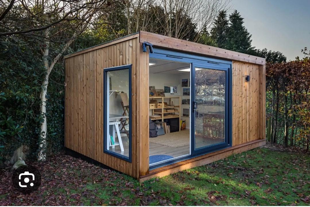

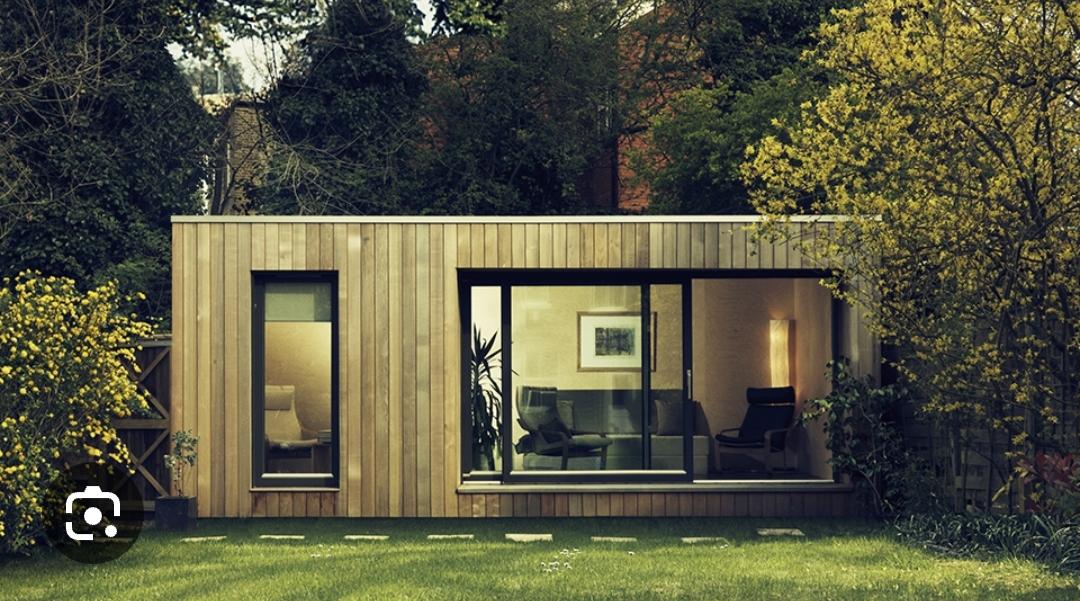

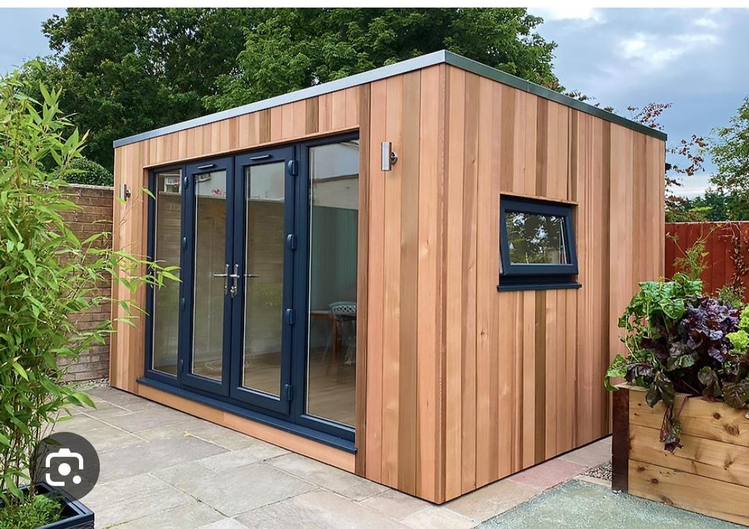

  6. Hello folks, I'm waiting on the delivery of my SIPS garden room kit (4.8m x 3.6m), with my foundation and sub-frame now complete. I'm looking into cladding details and we are keen for a contemporary style with no roof overhang around the building, and the cladding running to the top of the walls on all 4 sides. I've added some photos to give an idea of what we're after. We will be wrapping the sips panels in tyvek breather membrane and adding vertical and then horizontal battens to form an air gap before fixing the vertical timber cladding. My question is, what is the best way to vent the air gap at the top, considering we will have no overhang? 1. Is the EPDM roof covering that I'm using breathable, and will therefore let moisture escape? If so do I just lap it over the cladding at the top and fix my facia board? 2. Is my only option to run a horizontal wooden trim across the top of the cladding at the top to form a pathway for the moist air, as per photo 2? 3. Do I need to lap the EPDM over the cladding and then drill vent holes in the cladding near the top (not preferred) 4. Anything else I've not considered? I've been searching the web for a definitive answer to this but I'm struggling to find anything. All comments or suggestions (or criticism!) welcome in my search for something I can build that works. Many thanks.
