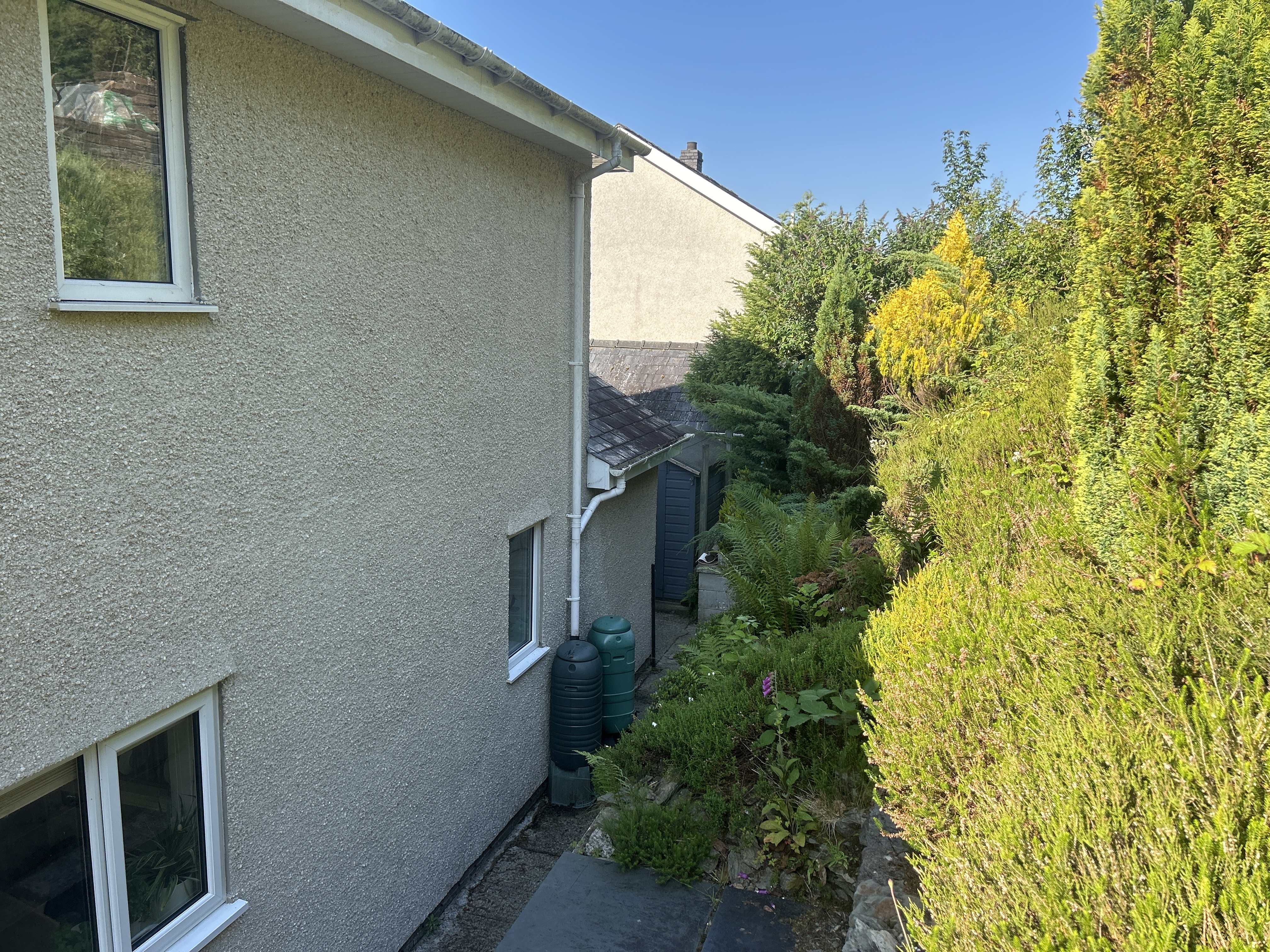

  1. I was thinking of - remove render to allow better purchase / friction against block - use hilti mesh inserts and epoxy bolt into hollow blocks I am wondering if off the shelf galvanised angle 200x100x10 would be adequate, though agree fabricating a z profile in stainless would be a more elegant solution. The 200mm side would be bearing the beams. I am not sure that goal posts would be suitable due to the kitchen window below (there would be a post directly in front if I am understanding correctly). I may look at tripling the beams and using something a little lighter and easier to handle (larch,oak?) though durability is key, hence initial thought of jarrah. Would also allow me to use slightly longer lengths if needed. thanks for the input!
  2. Photos not the best, but it’s 2.6m from the external wall to the dry stone dwarf wall you can see in 2nd pic. So I figured 3m would allow a decent bearing both ends. Was planning on replacing a section of the dry stone wall with a (substantial) concrete plinth, and casting in “sockets” for the sleeper ends. i hadn’t thought about a steel plate but i like that idea as less intrusive and as you say removes cold bridges etc. I’m sure I can find a fabricator to knock something up. Only possible issue is fixing to the wall as house is built from 100mm thick hollow blocks, I’m not sure that expansion bolts / thunder bolts would be secure enough? wondering if the additional load is likely to cause any issues with the window below? im assuming this has a box section type lintel like the other windows in the house. in terms of edge protection I had in mind full railings with spindles as would be lethal to kids otherwise! Thankfully it is very private and invisible to neighbouring properties.

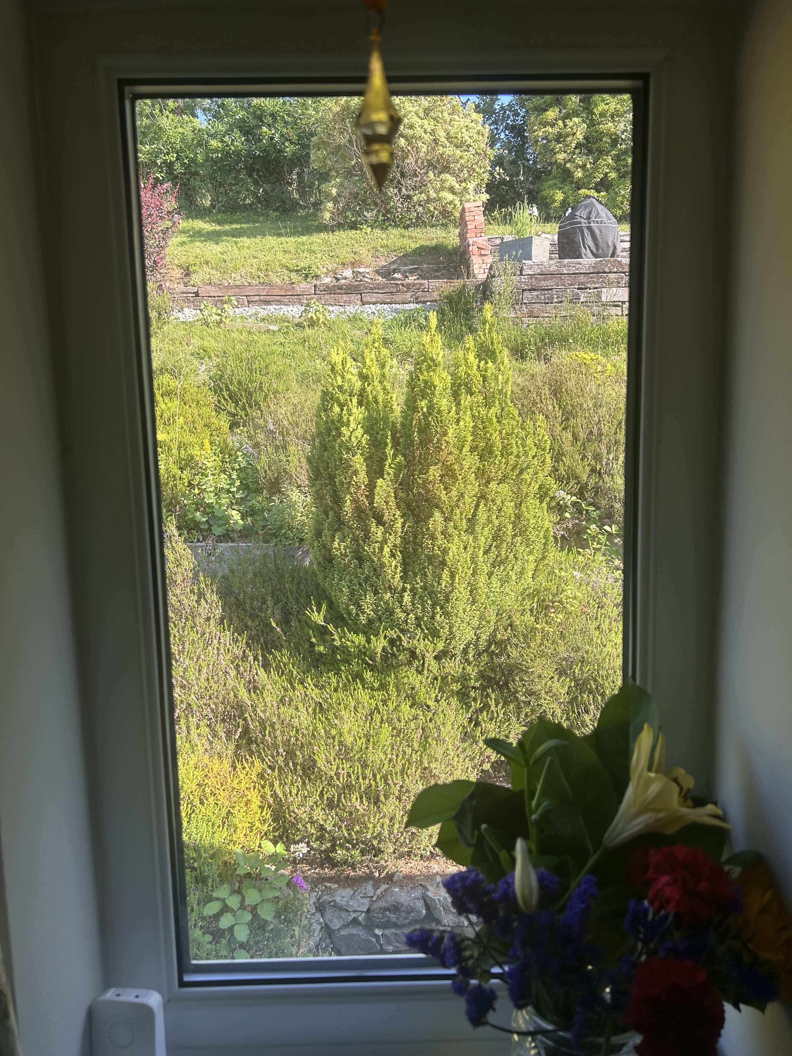

  3. Here is photo from inside of property through window which am proposing to turn into doorway.
  4. Our garden rises steeply from the back from our property via a series of retaining walls / steep slopes to a terrace area at the top. It’s about 6m height difference from the back door to the terrace. Access is a bit long winded as the only steps up are round the side of the house by the road at the front. I’d like to make access to the garden from the house easier and try and tie the two together a bit more. Im considering replacing a first floor window on the landing with a door, and building a walkway / bridge which will mean the garden can be entered at a higher level, much quicker and easier. My initial thought is to form a circa 0.9m wide walkway using a pair of 3m x 0.3m x 0.125m hardwood (jarrah) sleepers inserted into the outer leaf of the house, bearing on a stone foundation I will build into the slope. Then use planked jarrah sleepers for walkway treads and adding handrails both sides. Will need to build a couple of new steps to tie into existing garden path. The look will be somewhat rustic but ties into the rest of the garden and terrace which uses similar sleepers. Would appreciate thoughts on viability of this project and whether this is likely to work! Was hoping to avoid use of structural engineer as load seems relatively low - 3-400kg for structure plus pedestrian use? photo of window and outdoor area here Cheers RD
