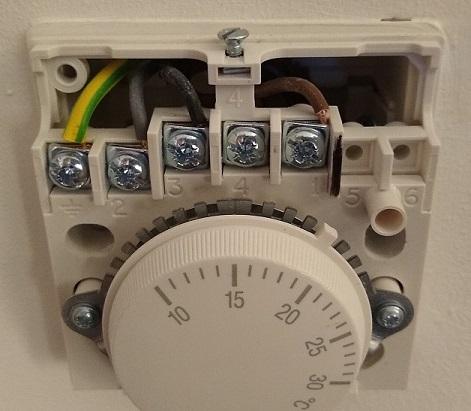

  4. Thanks ProDave. The current wiring on the stats is in the attached picture - spoken to the electrician who wired them in yesterday, brown is live, black is the switched wire, grey is neutral and the earth wire is on the left. Does this look right? When you say 2 wire operation, does that mean that the thermostat is battery operated as far as display and controls goes, with the switching done using the live and switched wires? I'm not a fan of having to go around replacing batteries - isn't there an option for mains powered thermostats?
  5. Hi there! I've got currently got 6 Honeywell T6360 dial thermostats that were installed as part of water UFH system (Daikin heatpump with DHW cylinder, and the usual manifold with actuators for each loop) and none of them appear to be working right, in that they appear to be set to switch on anywhere between 1 and 3 degrees below the temperature the of the room (i.e. with the room at 21 degrees C, the stat clicks on anywhere between 20 and 18 degrees), meaning they're driving the temperature up, unless I make a mental note of the individual offsets and compensate each room by setting the temperature lower. I don't have the mental capacity to do this - not because it's not there, but because I CBA to to this... Does anyone have any suggestions for good quality replacements that are not going to cost the earth? I've had a root around on the internet but there's so much choice and different makes/non-makes that it's kind of making my mind boggle! Thanks Marcel

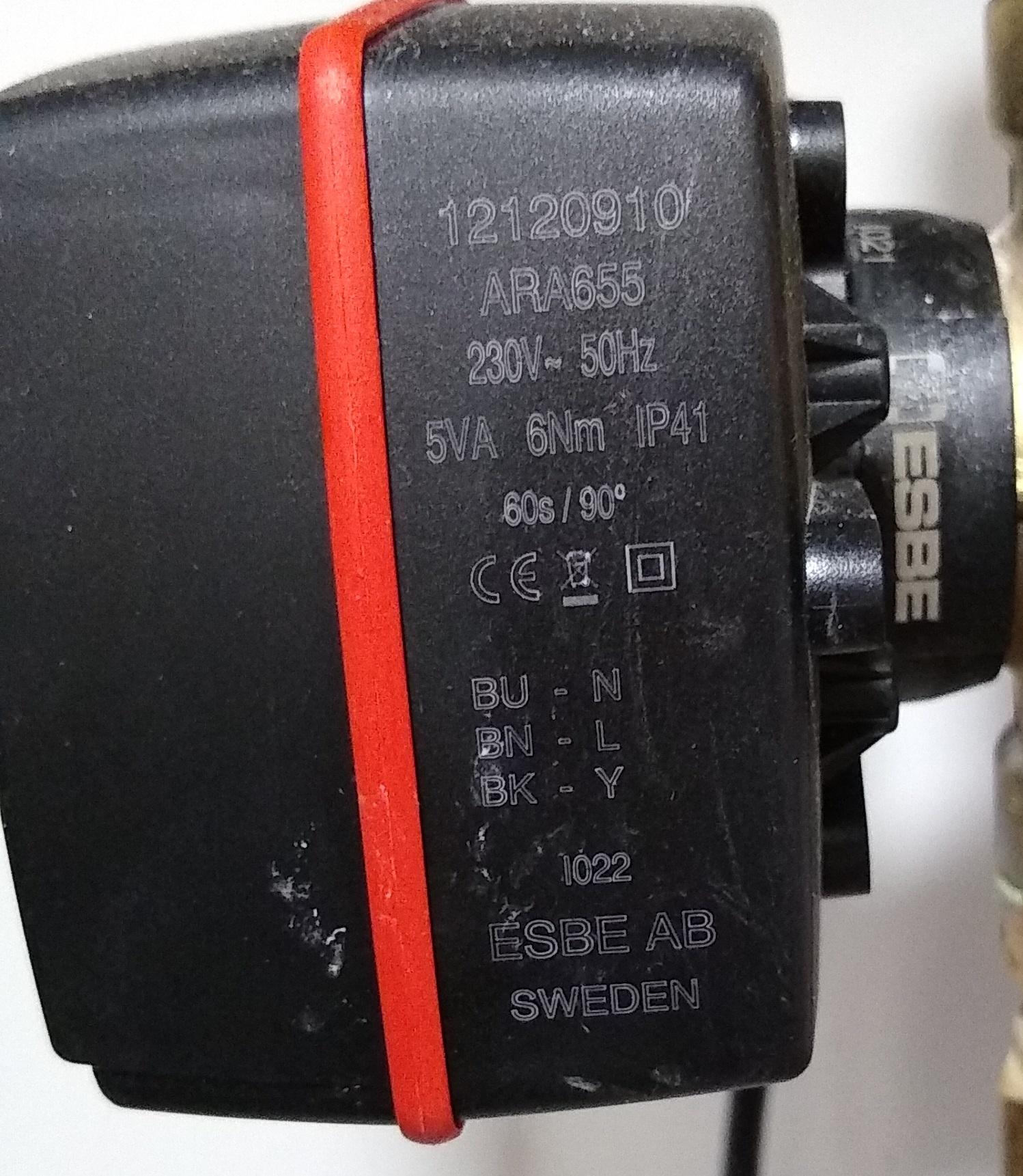

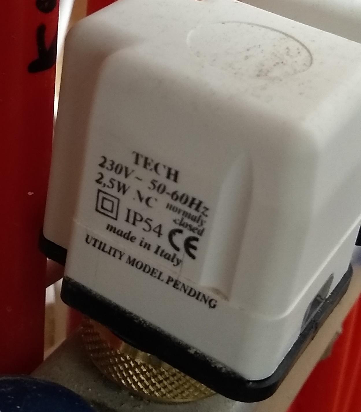

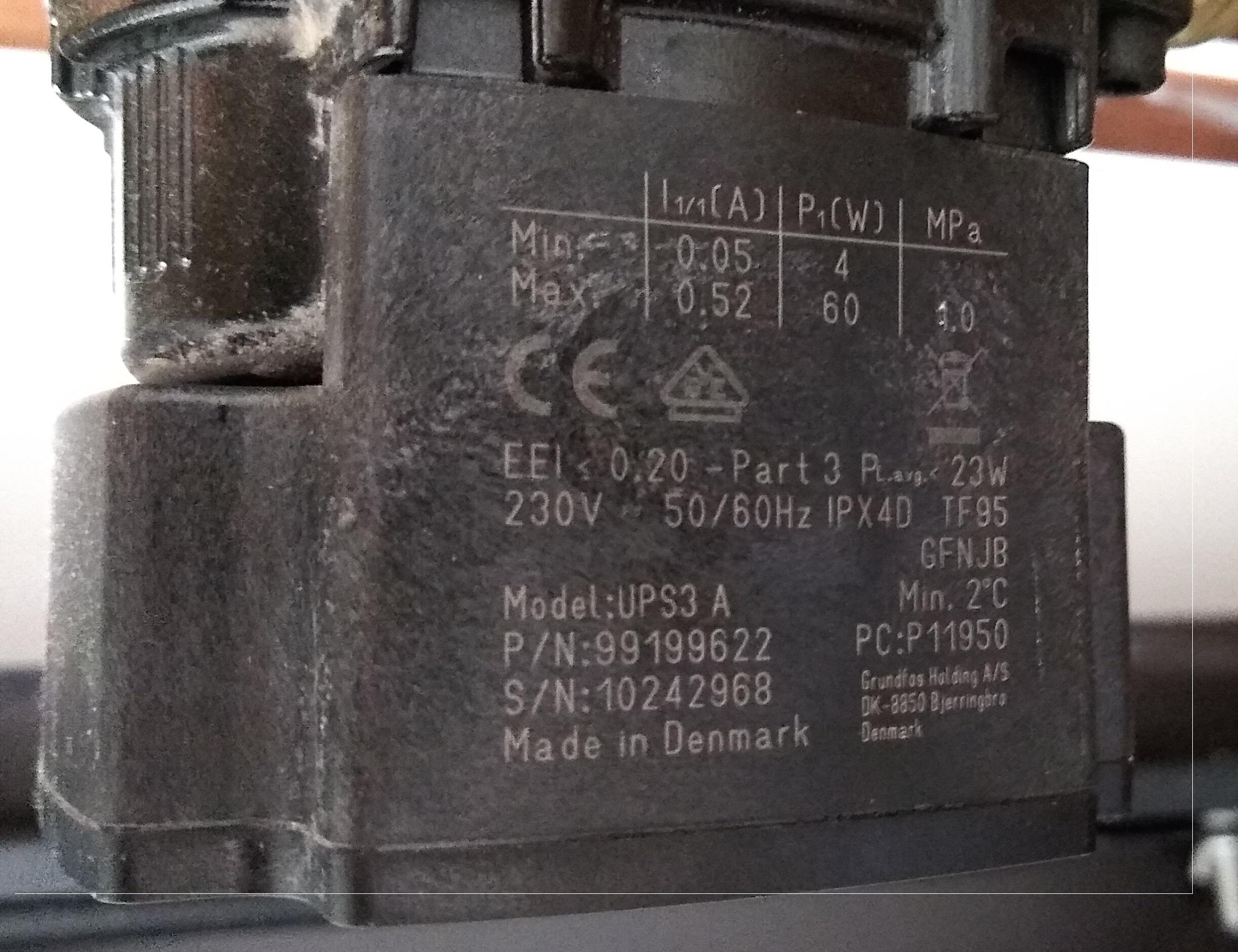

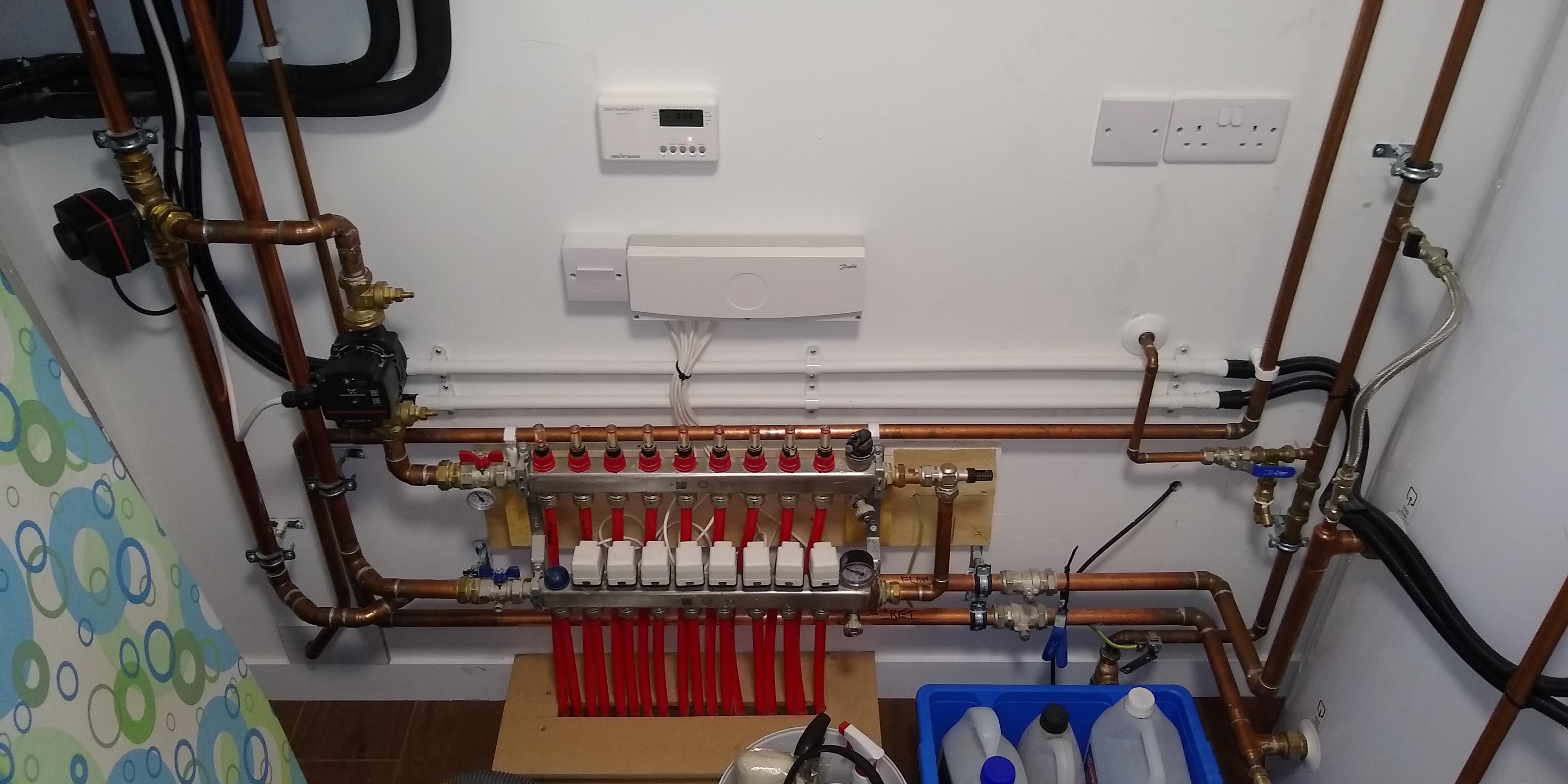

  21. ASHP has got temperature setting - nothing fancy, just a simple, single temperature - it looks like any advanced methods of controlling UFH temp have been switched off by the installer Images of diverter valve (red line, on the left), UFH circulation pump (middle) and actuator valves on manifold (right). The loop on the left (blue cap) is an open loop to the main bathroom - if there's a bypass, I'm not enirely sure why this would be there. The installer said that your bathroom is usually the hottest room in the house, and that there would normally always be an open loop into there... I've got a pic of all the destinations on the manifold pipes somewhere, but I'd need to have a look for that and post that later, 'cos I'm at work at the moment...
  22. This is our setup, internal ASHP is on the left, DHW tank on the right. I know the left hand black unit on the pipes diverts water either to the UFH od DHW, with the one attached to the manifold being the UFH circulation pump, but other than that, can you tell I'm fully clued up? ?
