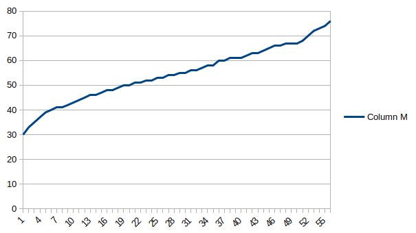

Thanks for your replies! @Nickfromwales; I wasn't aware of Jeremy Harris's neon issue; I'll dm him and ask what happened in the end, thanks. The new SA box with LEDs strikes me as huge improvement, but of course no help to me since I have an older control box! Back to my original question; sorry, I don't have much experience of using forums and I now realise I should've been more specific in what I was asking. So... Here's a graph showing the 3 measurements from the 3 cells of our Uniq 12 as it charges up (from the immersion heater) from empty at 16:00 until the controller switches off the heater at approx. 21:30. (After that it's just sporadically discharging as we have showers and wash up etc.) The yellow line also shows an average of the three. I expected to see, as @SteamyTea suggests, a fairly quick heat up to 58°C, hovering around that temp for the majority of the time then a short time above that up to 75 or so before turning off. As you see, that's not what happens at all. I'd like to understand what's happening as I want to use this data to compute an accurate charge level. (It's further complicated by the fact that when you monitor the current consumption, it's clear that the SA is 'pulsing' rather than supplying a steady current. I need to look at his some more, but I don't think its very significant except when the store is pretty nearly empty.) So; cell 1 zooms straight up to 90°C in the first half hour. Since by this time its only consumed about 1.2kWh, this can't possible by the actual temp of the cell 'overall', so I figure the sensor must be very near to the heater element. Unless there's actually more than 1 heater element? The others then slowly catch up, presumably by conduction. The other cells also don't do anything particularly non-linear at 58°C. I'm baffled. Maybe the three readings the Sunamp outputs aren't temperatures at all! Answers anyone? I Someone must know than I do about this? Please?
When we got a Sunamp Uniq heat battery last year we were a bit surprised to discover that it had no lights, switches or user interface of any kind. You can't tell whether it's charging or not, how much charge it has in it at any time (i.e. can you have a bath or not) and you can't tell it to start or stop charging. It just sits there doing what it's configured to do (It does that very well and we're very pleased with it.). So to cut a long story short I made a little box that displays charging status and the state of charge and also has a little web server so I can see graphs of temp, charge state, kWh used etc. It works just fine and is very useful. BUT computing an accurate state of charge from just the reported temperatures is difficult I’m hoping someone here might know more about it than I do? Happy to provide more info as to how I do it at the mo. if anyone’s interested.

Very happy to… Basically, I’m trying to get it to report the charge state as a percentage. I ran all the hot water out of my sunamp uniq12, then set it charging at a slow current and had the logger monitor the 3 cell temp. readings. In the graph the x-axis is time, y-axis is °C. The series shown is average temp of the 3 sensors. As you see, its non-linear but not half as much as you’d expect. (I expected the temp to stay at or around 58° for ages.) However; if you look at the temps of the individual cells, they do show a much greater non-linearity around the phase change temp. The relatively sane average graph results from the fact that the cells heat up at different rates so they’re not all phase changing at the same time. So this makes the logger able to calculate the charge reasonably accurately for the 3 cell sunamp, while it’s charging or discharging (similar things happen during a constant discharge). However, my brother has a small sunamp which I think has only 1 cell (or maybe 2), so my simple algorithm which works out the charge % based on an average isn’t going to work so well for his. Also, in real life the temps seldom hit empty and/or full, and the cells are are constantly charging and discharging every time you turn the hot tap on or a radiator comes on, so it doesn’t work so well then either. So in practice, the logger can report the actual “charge” with some accuracy only in the top and bottom 20% or so. BUT, at least where you have multiple cells, I can’t help feeling that the differences between their temperatures must be telling me something useful about the charge state. I just can’t work out what. Does anyone know more about this than I do? Happy to post more graphs etc if anyone's interested. -
