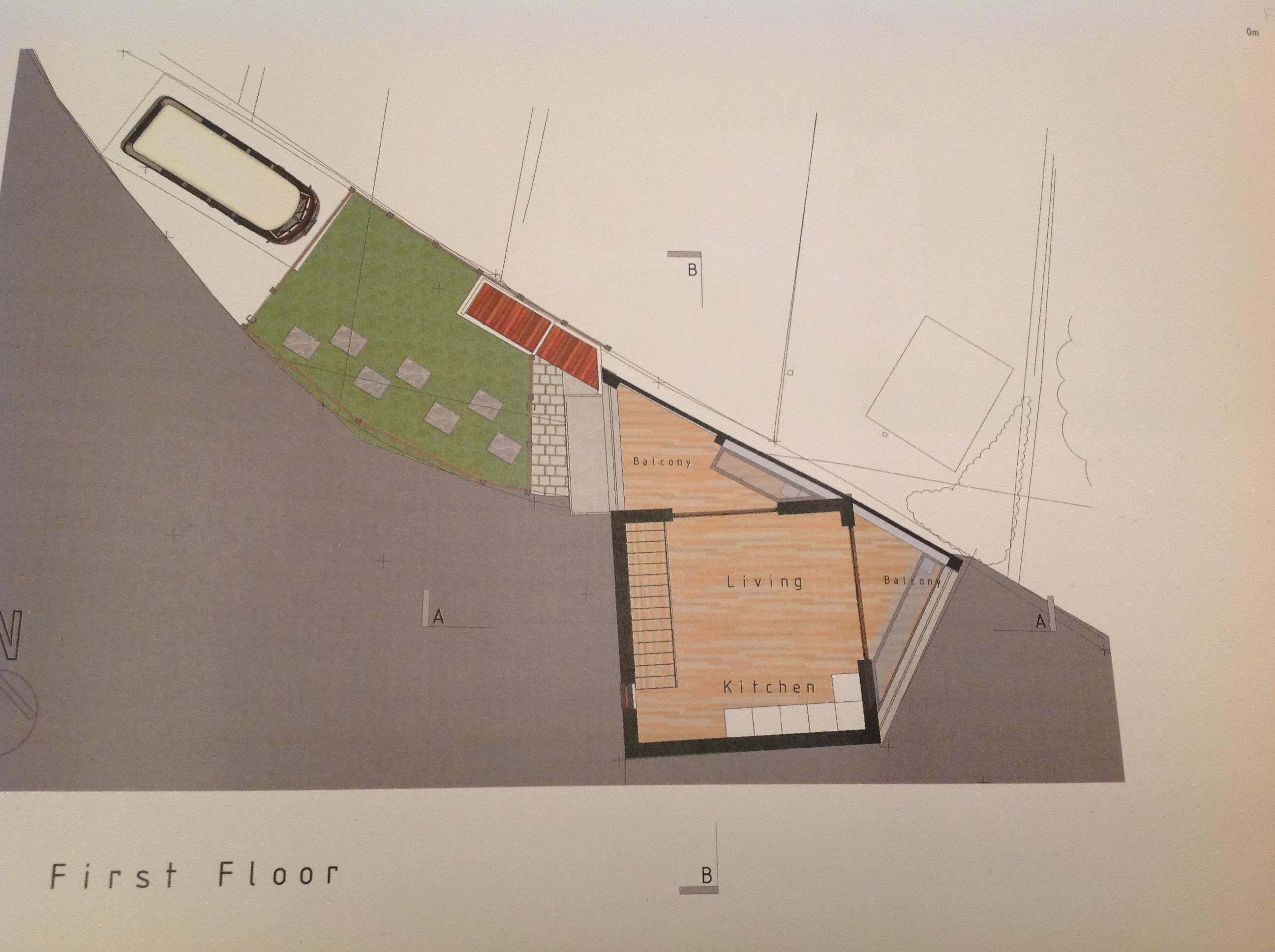

Height of ground floor 3m plus height of screening wall 1.8m.Total 4.8 Main body of living space 6.2m and small section finishes on the boundary -

It's a screening wall to stop overlooking to the north when on the balconies. -

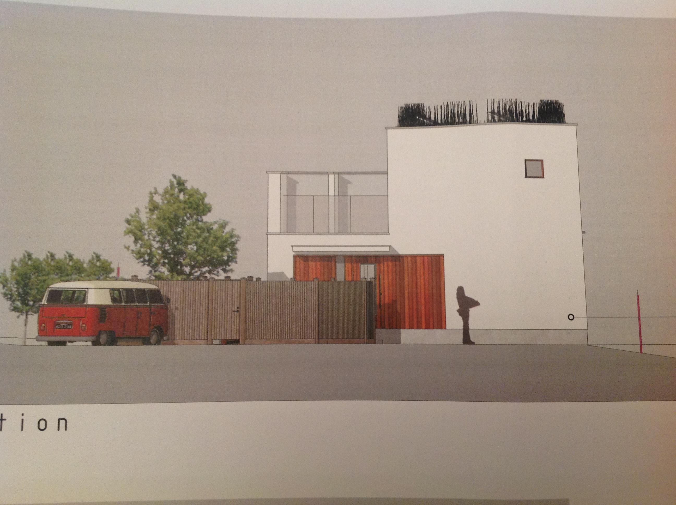

Our planning application recently went before the planning committee with recommendation for approval but was unanimously refused. Here is the refusal statement. It is considered that the proposed development by virtue of its scale, dominance and overdevelopment of the site would result in a loss of daylight and sunlight to the adjacent residential gardens to the north detrimentally impacting on the occupiers amenity, contrary to Policy DM25 and DM30 of the *******District Plan Part 2.” The boundary wall to the north and the one in question was presented to the committee in the councils written and verbal presentation as being 11m long and 6.2 meters high along its entire length. The fact is the wall is 11m long but only 2m of its length is 6.2m high and the remaing 9m is only 4.8m high. This crucial and misleading inaccuracies could of had a very detrimental influence on the committees decision to approve or refuse especially as the refusal was due to overshadowing of the neighbors garden. We have paid a considerable sum to a planning consultant from inception up to the refusal. The planning department posted there written appraisal that would be presented to the committee well in advance and the consultant and I had a long discussion on how positive it sounded.I the applicant did not notice the mistakes regarding the height of the wall but maybe the consultant should of. Or should my concerns be taken up with the planning department?Would there be any sort of redress? I mentioned my concerns to the consultant who in my view fobbed me off by saying the planning departments error could form part of my argument if I go to Appeal. I was well aware that the committee could make up there own mind but for the committee to be presented with the wrong information is surely unfair. Your comments would be most welcome.

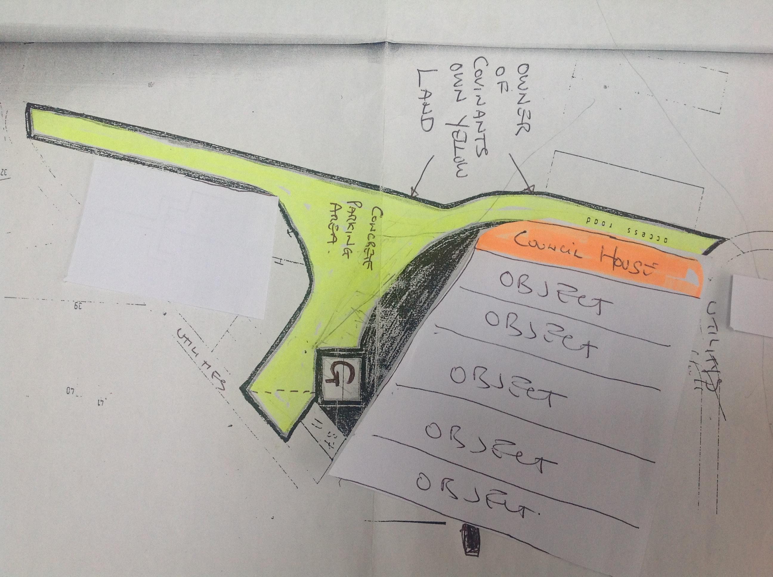

Plan attatched.My plot is labelled G and shaded black.Nearest utility's to rear of G about 6 m.Yellow owned by owner of covenants. Utilitys also in front of council house ORANGE.I have right of way over yellow access road.
All of the other houses are privately owned and have robustly objected to the application.The council tenants or council have made no objections.Parish council voted to remain neutral.
Thanks for the reply.Good point regarding moling.I have right of way over the access road but it is also owned by the land owner from whom I require a easement and the distance to the utility's is about 30 m along the road.The owner of the road is so far unaware of my application. What your opinion regarding the council house?The garden has a wide grass area running from my boundary directly to the pavement containing all utility's about 15 m.

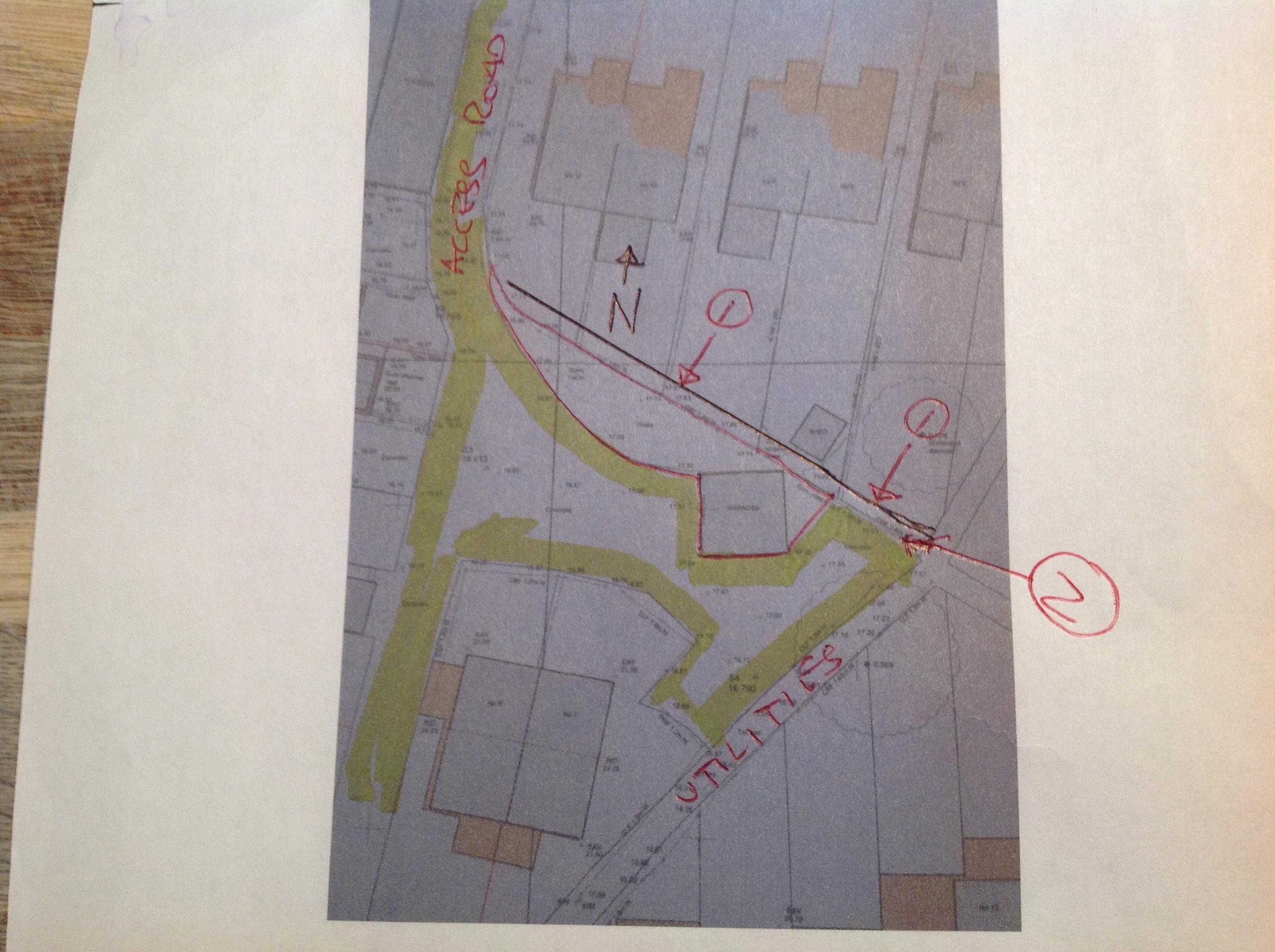

Width of gap is 35cm. On the attached plan my plot is out lined in red.The area outlined in yellow/green is a paved area with access to all. The black line at arrows 1 is where my neighbours garden originally ended but now they butt up to my northern boundary. I hope to get permission to reach the utilities over the yellow/green area. The 35cm gap which is part of the original footpath that my neighbours have encroached on can be seen at arrow 2.(If you look closely the 35cm can be seen. Thank you all for taking the time.
