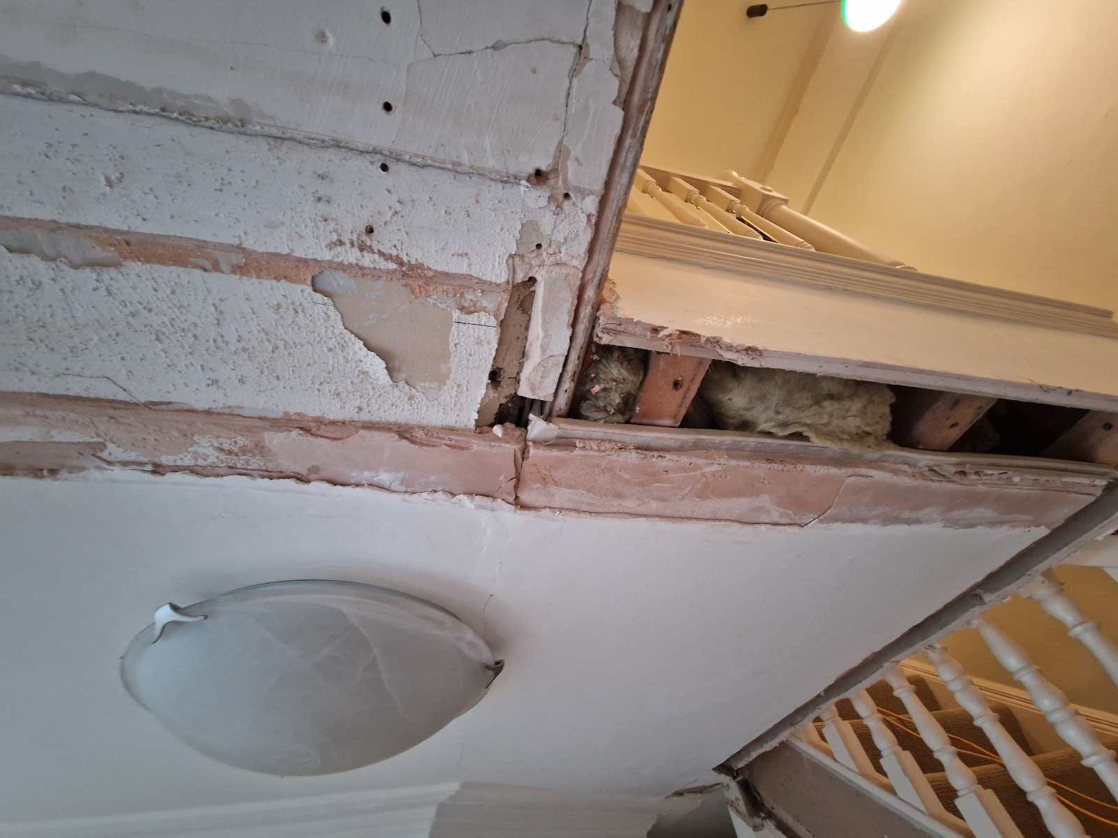

My partner pulled up the carpet and ply and discovered it appears to have been added later, so held up by the post in the stud wall that was removed. It seems it was added to accommodate a radiator. Wouldn't a builder usually check all this before removing walls and posts? You can see in the pic the old boards, which matches the original ceiling under it. -

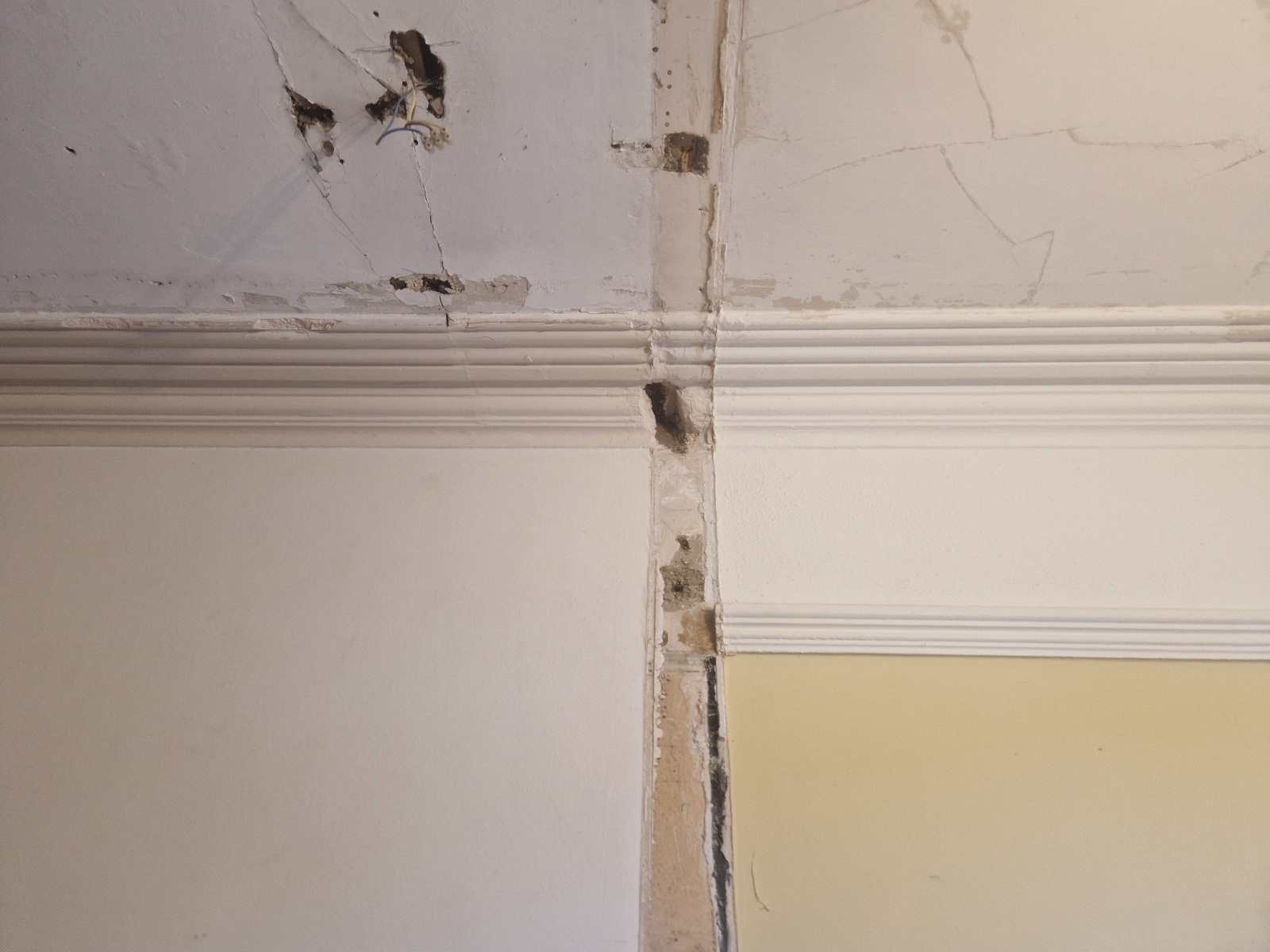

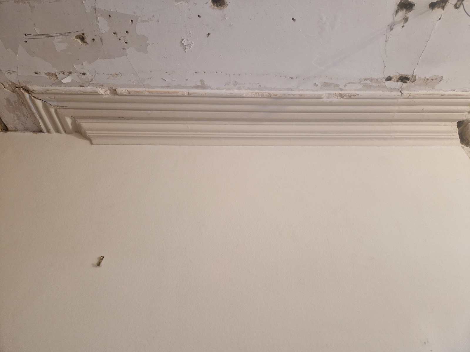

Hi, We have an early 1900's house in London, which was two flats and we are converting back to one house. The stud wall has been removed Itin the hall and a plasterboard removed from part of the ceiling, revealing the badly damaged original ceiling above. It's a bit of a mess with some of the ceiling still plasterboard and some the original. One idea is to remove the whole ceiling but after a google I see that lime plaster should be used. Is that correct? As said part of the ceiling has been plasterboard and skim since the 80's and then badly joined to the original lime plaster ceiling, the bad join hidden by the stud wall (shown in photo) Ideally I wouldn't have to replace the whole thing, as it also means we have to get the cornice all replicated. We are trying to restore rather than remove. Any advice would be appreciated.

Yes, thats how I look at it. The problem I think we have is working out what was changed and was original. So it's a bit of a puzzle at times. I go by original architrave and cornice for the most part. They did a good with changing it into flats that sometimes it hard to see what was added, but also exciting. It's rather genius how that 'floats' there without anything under it. Hopefully we are not the first people in 120 years to fall through it. -

Thank you. Yes we are lucky the original floor is still there, we were fortunate that despite turning it into flats they left most of the original features. Yes the triangle fill is not original, part might be, but they brought it forward to align with the stud wall. I was worried about that landing so great to know it's self supporting, which I thought it must be. I have seen one neighbours house and originally it looked like ours where you can see all the spindles. I think my builder is being careful. -
Apologies if this is a really obvious question but we have a 1900's house which was two flats and we are turning it back into one. The upstairs was one flat and down the other. We have removed the hallway stud wall but originally you would also see the stair rails going up the turn. In the pic you can see the wooden frame from the studd wall, they also extended the sloped ceiling part under the stairs, that should be further back. The wooden post making up the frame of the stud wall obviously wasn't there originally, so what holds up the small landing jutting out on the turn on the left of the stair rail? I hope that makes sense.
