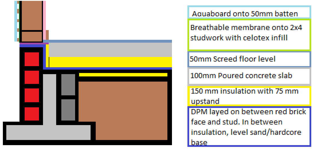

  11. So lose the top red brick, get the insulating block level with the floor insulation so that there is no masonry “contact” from outside to in?
  12. So if i am understanding you both then something along these lines would be more appropriate? With the maroon being the Marmox insulating block
  13. Hi Mr Punter, so you are suggesting, cold bridging aside, the above would be fine without the inner block. Using just the brick to retain the compacted type 1 and presumably only the footing for the brick as the concrete infill between courses would no longer be required either? It needs to pass a building regs check as the front door will be moved into the porch from the existing position. Russell, struggling to find anything that makes sense to me regarding the sole plate and cold bridging could you elaborate a little more please? Would you suggest the use of something like this between the DPC and the sole plate? Or is there a simpler solution I’m not aware of thanks
  14. Thanks for the reply Russell, will look into the cold bridge issue. Are you suggesting that there may be too much insulation across the flooring?

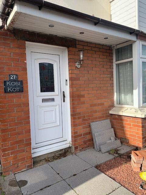

  15. I have also just realised i may have posted in the wrong section if i have apologies feel free to move the post into the foundation section
