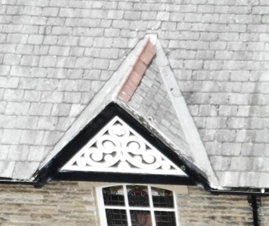

  2. Yup a flat roof from the inside, hard to see from the pic but basically behind the wood work is just the vertical stone wall extended to the apex of the dormer ie no ventilation the fireplaces themselves are seal. 3 of the 4 chimneys are capped and when I get this roof work done I will be capping the fourth (just using anti-downdraft cowls, i.e. allow some ventilation but blocks the rain)

  8. There is an ensuite with an extractor, another bathroom with an extractor and a utility room with an extractor. All light switch activated with no overun timer and given the ensuite/other bathroom aren't renovated yet, those extractors are rarely used. I'm starting to think that the way forward is to change the utility extractor to the one Iceverge recommends and to set it continuosly running and eventually to upgrade the ensuite/other bathroom extractors to either have 60 min overun or be continuously running as well. Hopefully between those 4 that's house ventilation taken care of. Yes, basically the roof nearest in that picture is part of a 2010 extension to the 1906 original building. The extension has openings to the original on both the ground and first floor i.e. I view them as one from a ventilation perspective. The extension roof is properly insulated and uninhabited whereas the orginal is the one in question here and has the loft conversion. Was messing around with some of these U-value calculators and it looks as though I could meet the target values with 75mm insulation between the rafters and 100m on top of the rafters. Throw cross battons then yes I can't see me raising it by more than 150mm and hopefully as you say, their desires seem to be focused on energy saving that this dominates their thought process.

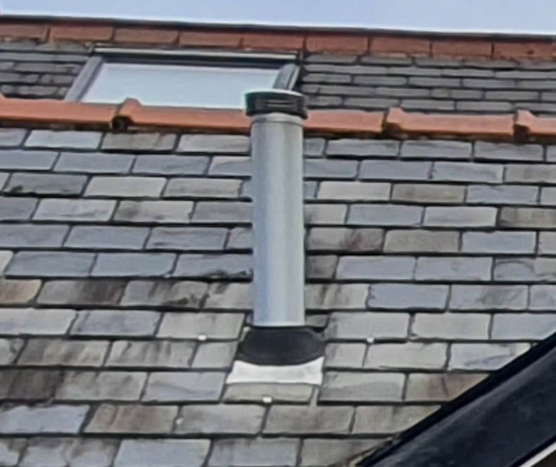

  10. I don't know too much about it as was fitted by previous owners but I know there is a pipe on the Aga that has its own dedicated external inlet as per photo

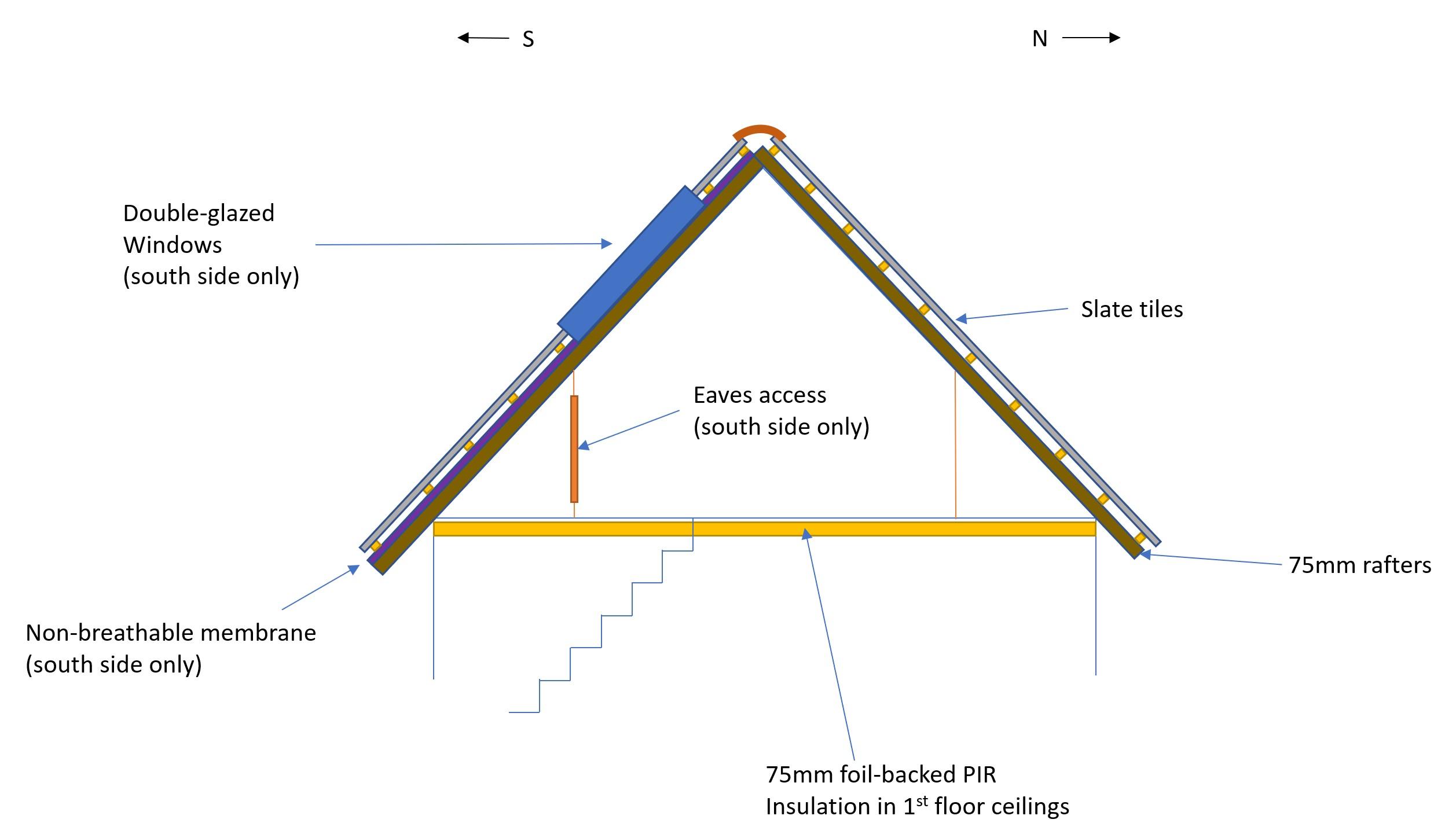

  11. Thank you so much for that, I've tried to address the points above. In the interim I'm doing more research on the insulation element, certainly feels like between and over rafters is the best solution when it comes to comfort/heating (although I don't believe it addresses the ventilation issue). I will play around with calculators but I'm guessing a flexible insulation between the 75mm rafters followed by 150mm PIR on top of the rafters will get me in the right U-value ballpark for building control whilst not being shot down by planning permission for excessive roof height increase.

  14. No cavity to the walls (c1906 building) The side with the plastic sheet has this sheet on top of the rafters (fairly tight ie not much of a sag) then the roof batons and slates on top of this. No OSB. Definitely think adding a few slate vent tiles will show a decent improvement Re vapour barrier, the main walls are uninsulated, just plaster onto stonework. In the loft there is plasterboard to box in the eves area but standard plasterboard, no foil backed/vapour barrier on them in the roof. I think you're on the right track, get some PIR in between the rafters (allowing enough of air flow gap) but also take down the old plasterboard and fit foil backed insulated plasterboard to lose a bit of room space but should make big difference re comfort and humidity From the access I have, hard to sell if slates on counter battons as the ridge board covers the view from the side and the plastic sheet stops me seeing whats happening above it. I'm in a deep valley in Yorkshire so probably not far off the winds you've got up there Will do some more digging on cold/warm roofs but you're giving me a few good bits to think about and research Cheers John
