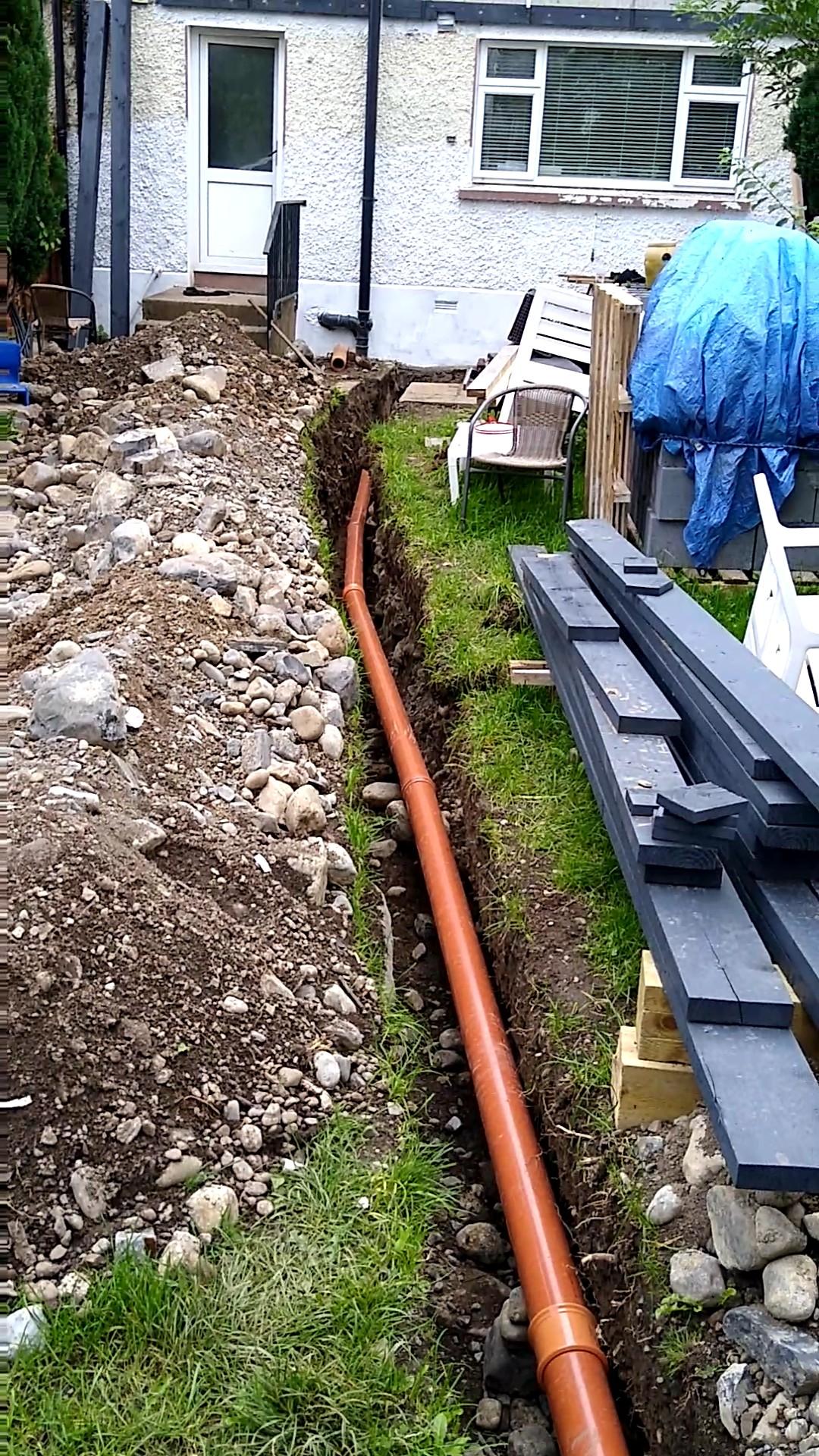

  4. Cheers lad, pretty chuffed with it having never done any ground work before. Yeah, pick and spade job, great fun was had. There is a trench filling party on Friday, bring a friend ?

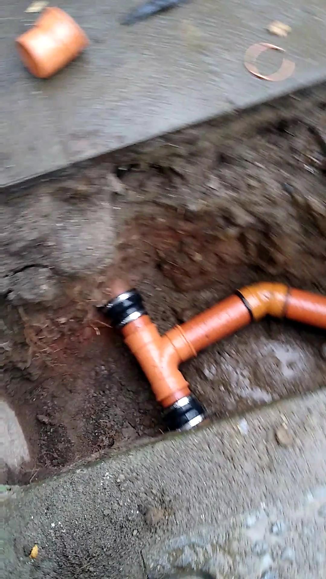

  5. Got it done, thanks for the input lads.

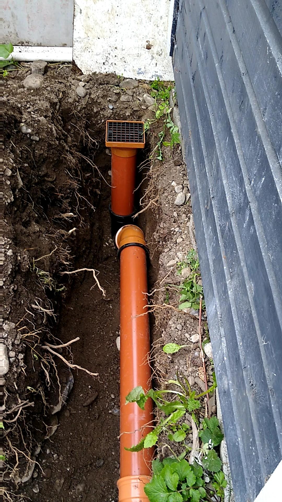

  6. thanks for the input lads, I hear ya loud and clear, 110mm pipe it is so. back when i was on the sites some 20 years back an inch fall per yard was recommended, does that still hold true or is there an new take on whats needed?
  7. Hi all I'll be digging a trench to the shed to get electricity out there and thought if I add a water drain while I'm at it I would be able to use the shed for my home-brewing. I checked with the sparks and he had no issue with the water and electricity sharing trench ,as long as they are in separate pipes all is good according to him. I've 20m to dig so I'm happy I don't have to do two trenches. My question is about the waste pipe, do I need a 110mm waste pipe for what is essentially just going to be used for water and grain bits or can I get away with a normal 32 mm white pipe? I know the pipe is able for it, I just don't know if it's ok to use it underground I was going to connect it to the existing waste pipe that is on the house, I've a manhole just outside the backdoor that o was hoping to get the pipe to
