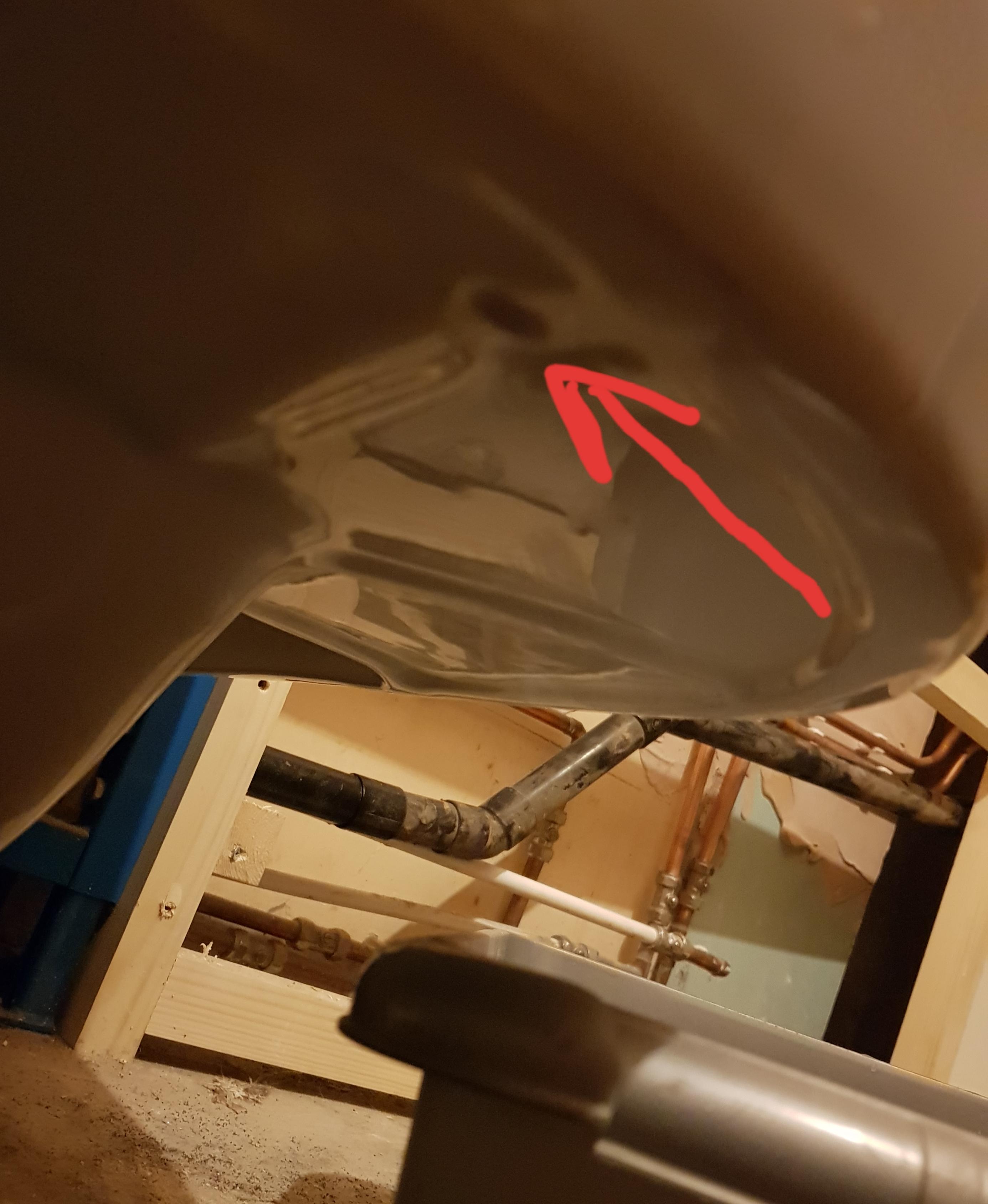

Thanks Markc. I have actually bunged the hole temporarily and will flush it several times just to see how much water accumulates in there. I suppose it's going to get heavier if it completely fills but that's about it. Be a bit of a mess if the bung fails mind but the water does slow to just a drip once that void is empty. We really need to get the house on the market asap and have no spare cash for another loo so we're desperately looking for a solution. Thanks again -

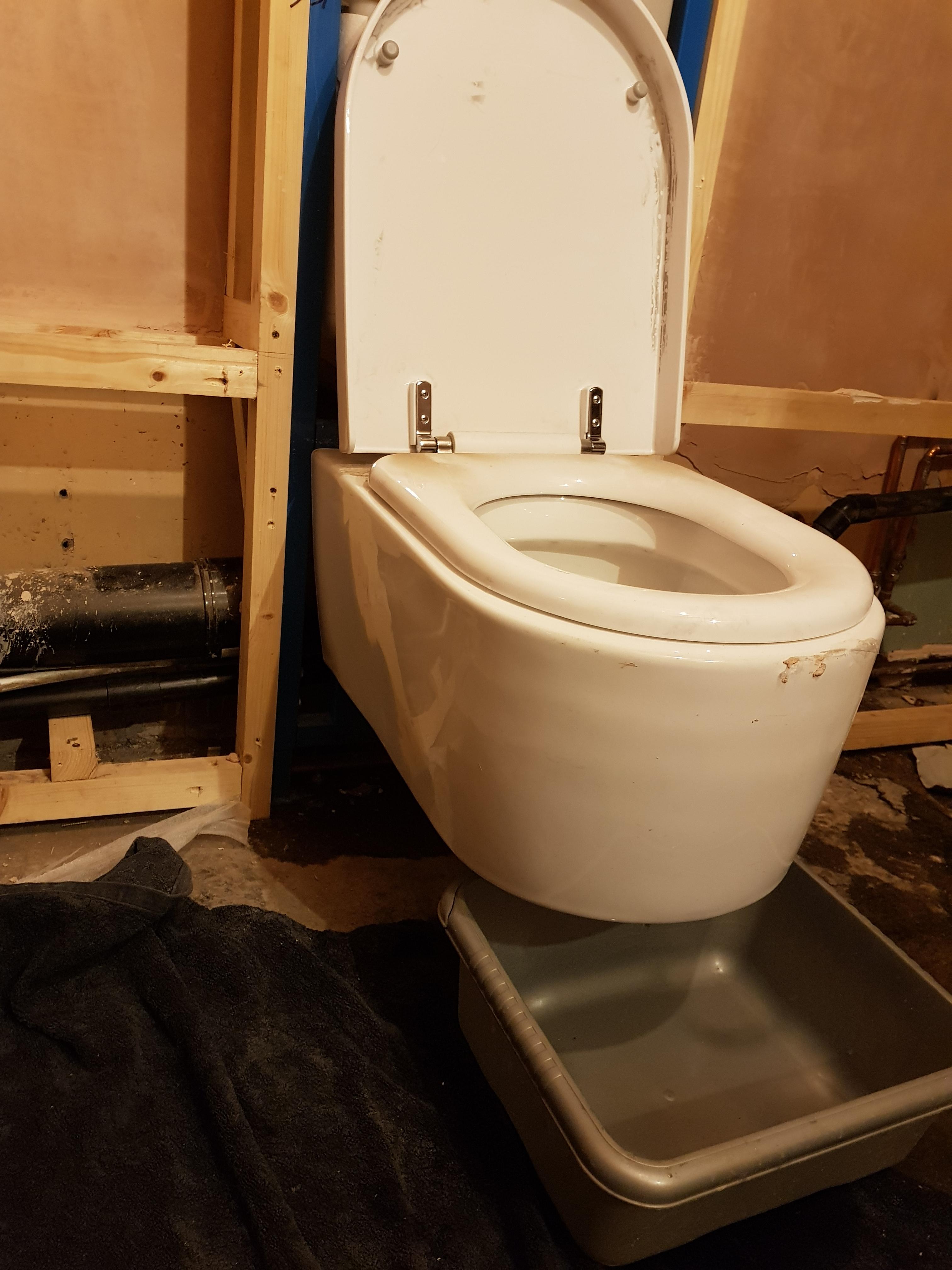

FYI We've also noticed that the pan tilts forward. It's about 7/8" lower at the front than back. It's fitted flush to its frame and that frame is perfectly vertical but should it really be level? I'm wondering (desperately) whether that may help the LEAK ? Thanks -

Oh god! 12 years that thing has been hanging on the wall. Because we've never plumbed it in we've never known it was faulty all along. ? Is there any way the hole can be filled or bunged do you know? Thank you for your reply Timedout, it's much appreciated. -
Hi We had this wall hung loo fitted years ago but the project was halted for one reason or another and never completed. Finally got it plumbed in today but it pours water out a hole in the underside right at the front when it refills after a flush. The hole is part of the moulding so looks purposeful but for what purpose exactly and how do we stop it from leaking? Thanks
