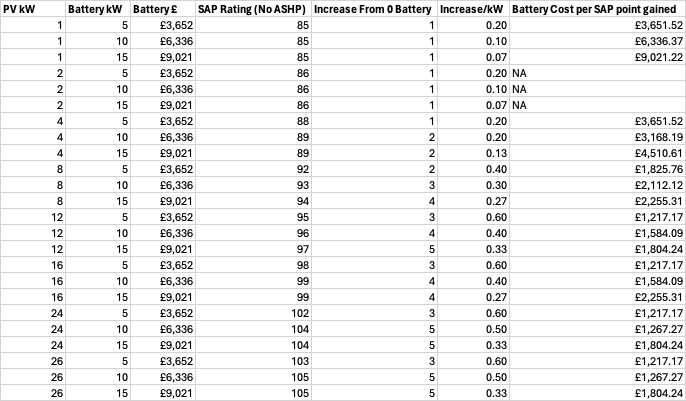

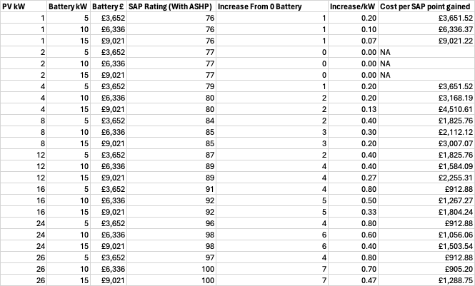

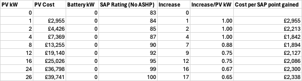

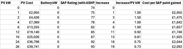

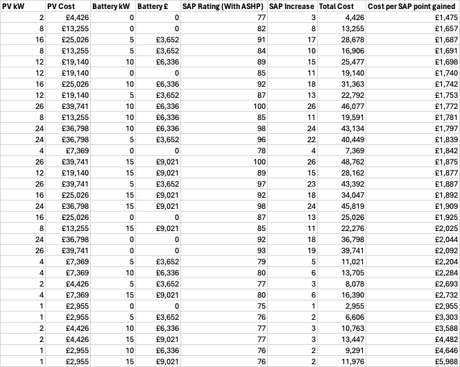

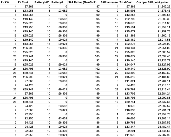

I spent some time putting together the differences battery size makes when paired with different PV systems. It varies quite a lot on the PV kWp and also whether or not you have an ASHP. Figures used for PV/Battery costs are from here 1. This shows the gain from PV with no battery and no ASHP 2. PV, no battery, with ASHP 3. Battery sizes (5, 10 and 15 kW) paired with different PV kWp. No ASHP 4. Battery sizes (5, 10 and 15 kW) paired with different PV kWp. With ASHP 5. Ranked by cheapest cost (total cost of PV + Battery) per SAP point gained. No ASHP 6. Ranked by cheapest cost (total cost of PV + Battery) per SAP point gained. With ASHP -

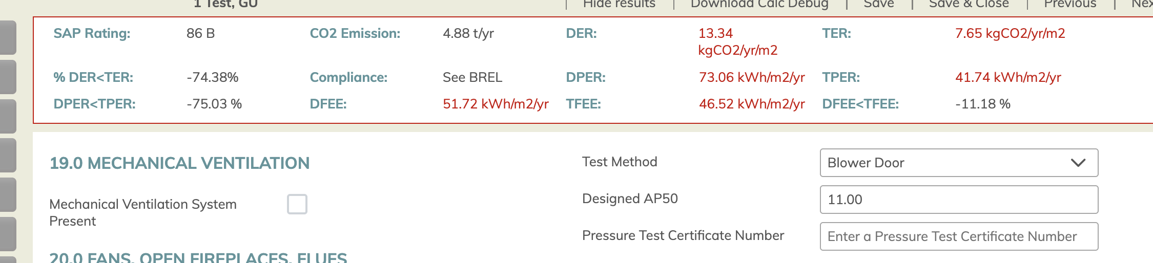

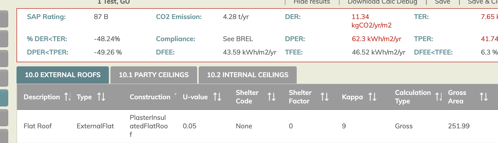

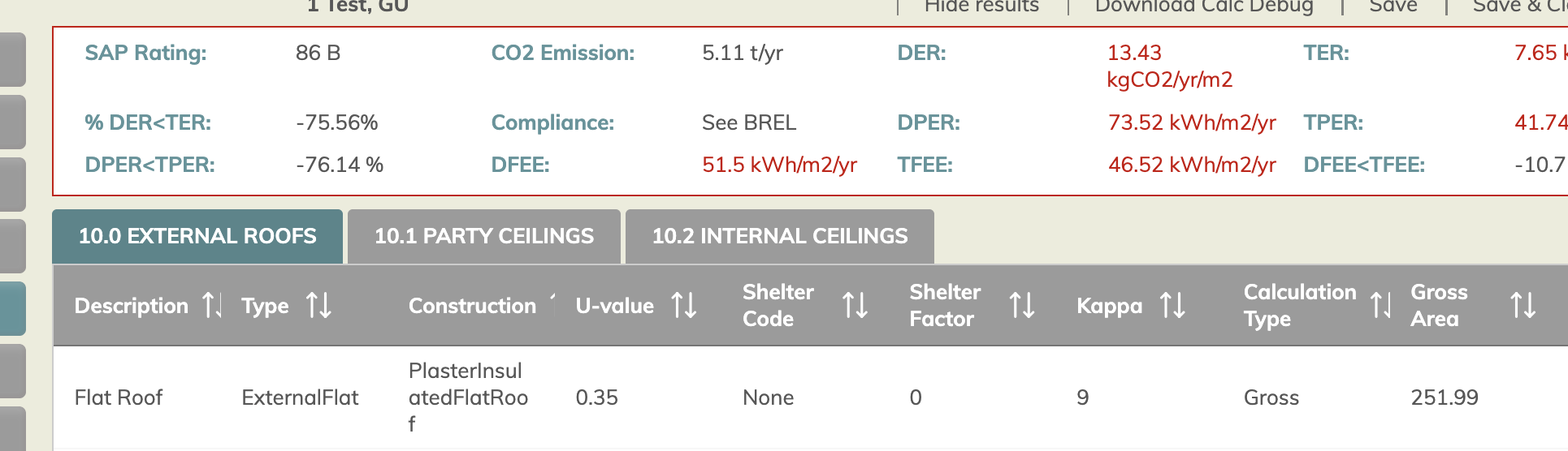

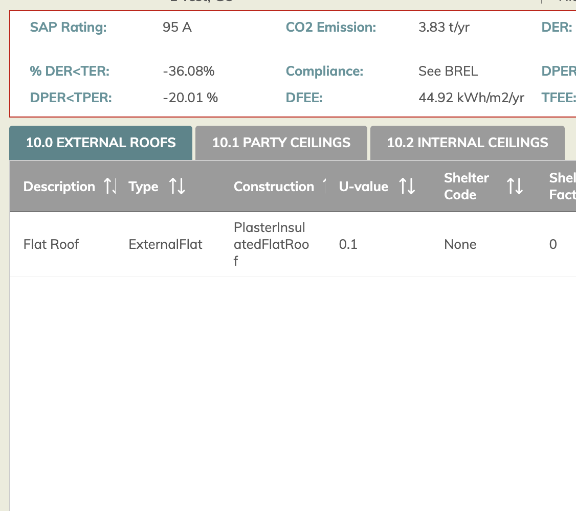

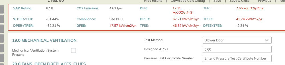

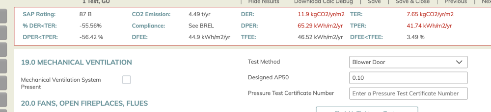

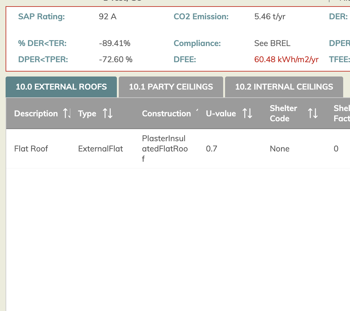

This is all done on the latest SAP 10 standards. I've attached some screenshots showing the score change from making one alteration to the spec, leaving all else the same. I reset the spec to the original before changing a new data field. I start on 87 B with no ASHP or MVHR, 0.15 u for roof and 0.1 u for walls. Air Tightness - no change in score between 6.60 and 0.10 Roof u-value (251m2 gross area) - 1 point change between 0.35 u value and 0.05 Adding MVHR - 5 point reduction to 82 Adding 6kW PV + 12 kWh battery - increase of 8 points to 95 Changes to data but keeping the PV and battery in the spec: Main heating source changed from mains gas to ASHP - 12 point reduction to 83 Flat roof u-value - improving u-value from 0.15 to 0.1 has no effect. Worsening the u-value to 0.7 drops the score by 3 points to 92 -
My design SAP used a lot of standard assumed data, such as double glazed windows, no MVHR, gas boiler, numerous openings for air extraction etc. It had a score of 87 B. The actual build used significantly more insulation, 3G windows, MVHR, ASHP. The costs of the upgrades would be in the tens of £ks. After submitting all this info, my energy performance was downgraded to a C with an 8 point drop to 79. I thought the assessor must be entering something wrong so I got access to a trial version of SAP assessment program and re-did the info myself. Nope, it somehow actually gave me an even lower score of 73. I removed the MVHR and added vents, changed the ASHP to a mains gas boiler and straight back to 87. I understand how these can drop a SAP score because it focuses on electricity costs and these are electric devices, but it was interesting to see that none of the other improvements moved the needle by a single point. Out of curiosity, I started playing with some of the data and gave it an air tightness score of just above 0 and boosted the u-values of all the materials - I managed to get 1 additional point. The only thing that made any real difference was adding PV and a battery, which took it from between 93 to 100, depending on the kWh inputted. The lesson seems to be, if you want an A rating, is to keep everything standard, no 'eco' heating or ventilation systems, minimum insulation for building regs, and then just add a bit of PV. Might be useful for anyone needing to qualify for an Ecology mortgage.
