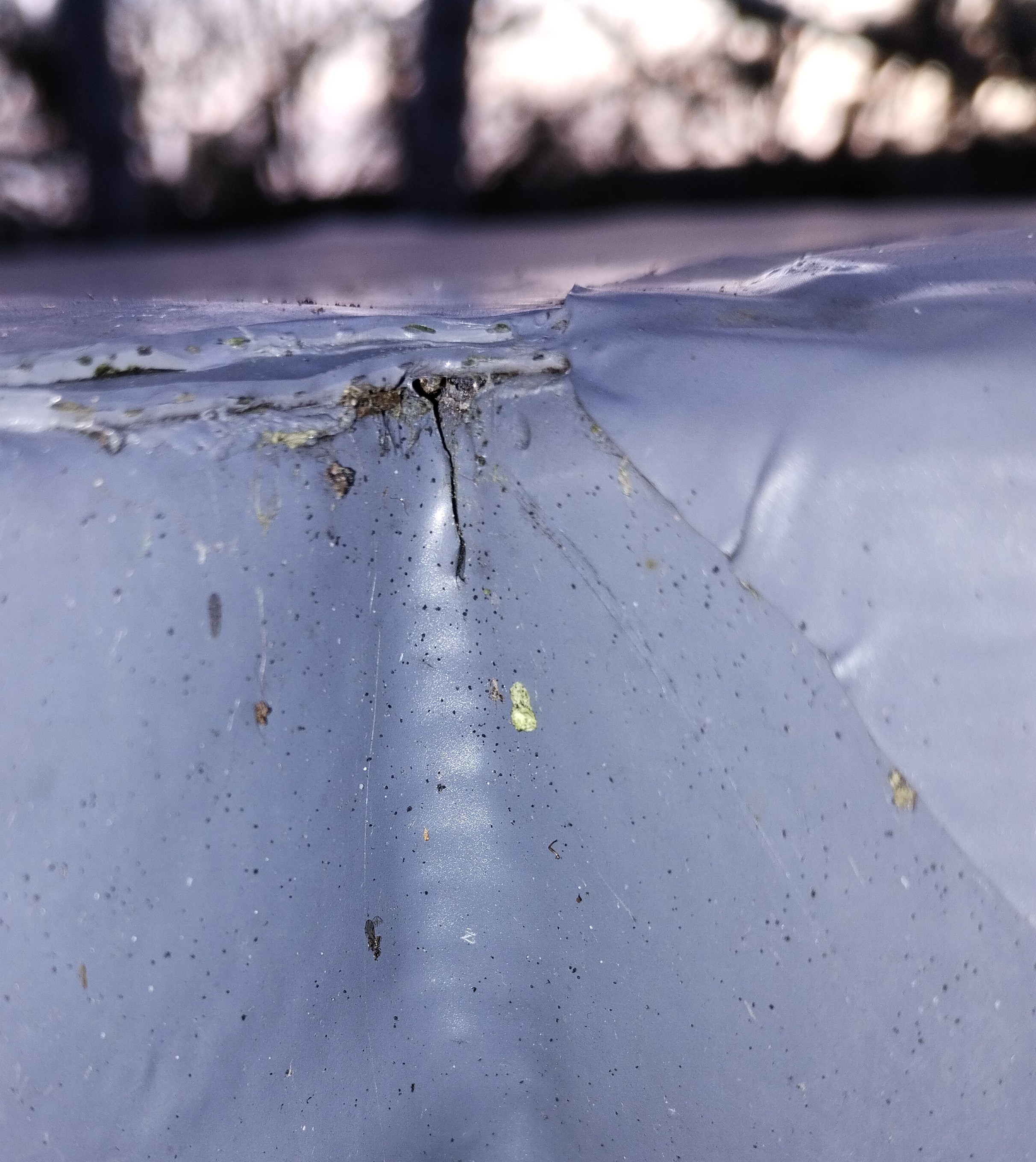

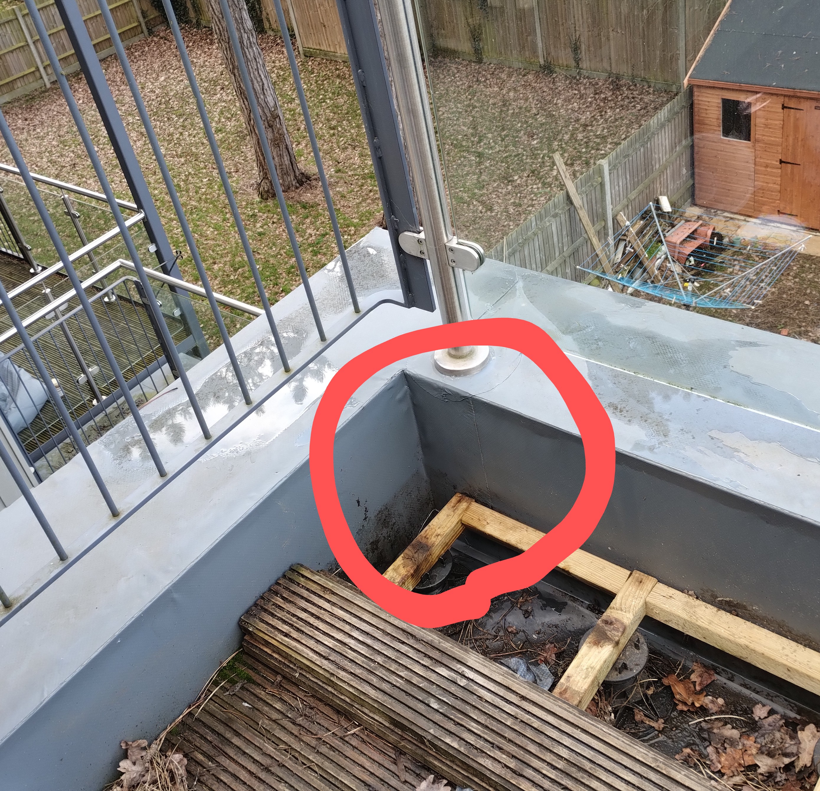

  5. Hello After a couple of days of heavy rain and high winds I notice a brown stain on a ceiling below a balcony. It's right in the corner so I took a couple of decking planks up and saw a couple of possible problem areas (photos attached) I'm obviously going to have it looked at but in the short term I was going to try and fill these areas and see what happens. Pulling all the decking and framing up will be a nightmare. Where would you guys being looking at being the main problem area? The roof is a pvc/tpo welded membrane.

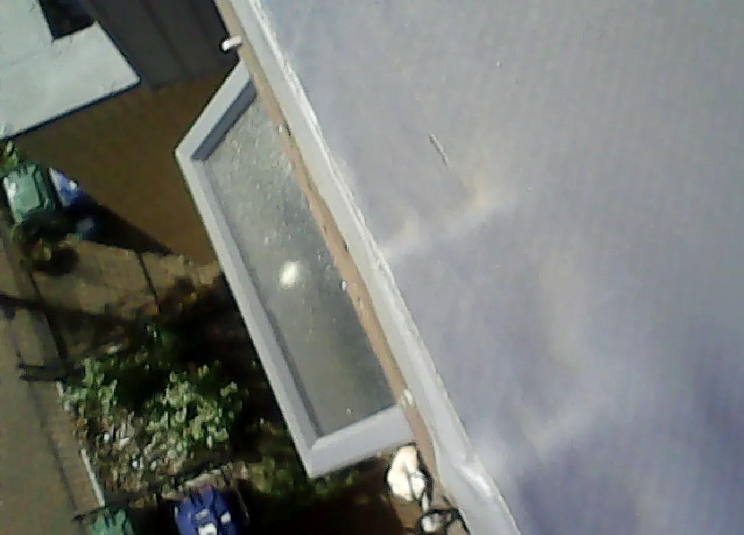

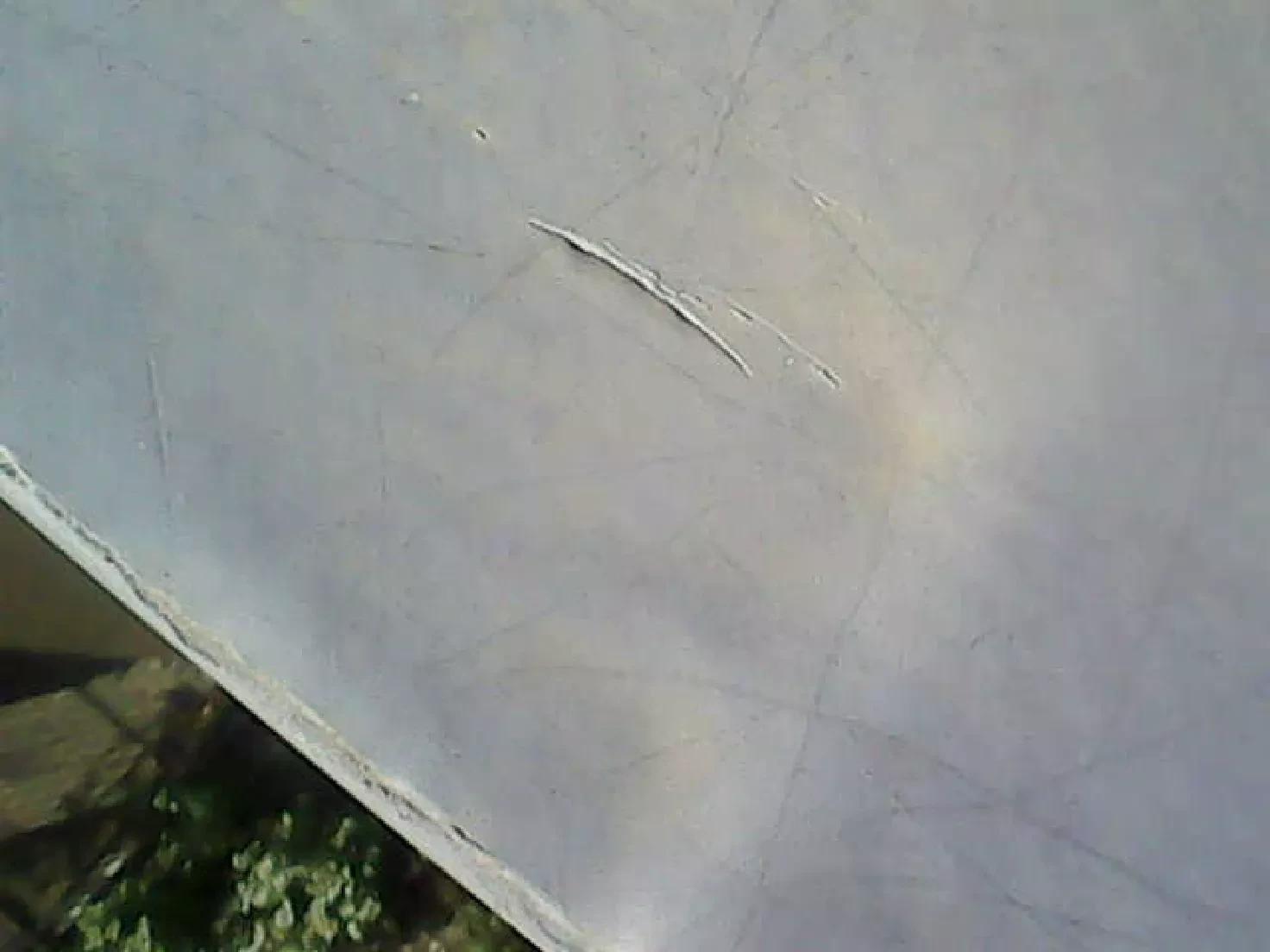

  6. Had this small brown water mark at the ceiling wall junction for about 6 months, it's not got worse since and is about 7cm X 1cm. Took some photos today of the top of the flat roof and only think I can see is this...(photo attached) This mark is about 1 meter away from the mark. Does this look like a hole? I'm not convinced the mark goes all the way through the rubber but can't get better access as it's a 3 story house.

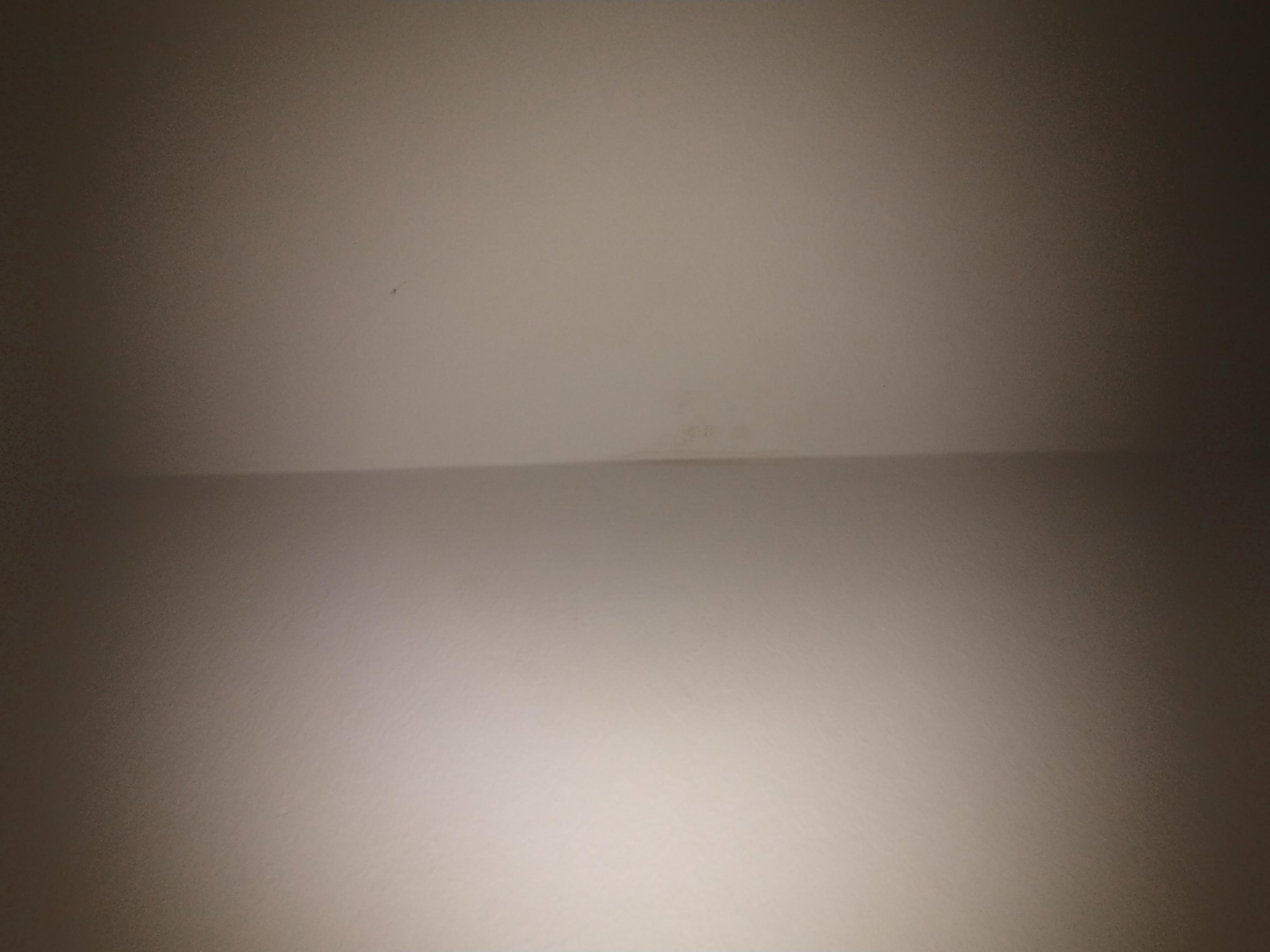

  7. I'm not sure either, it looks old to me. The white stuff on top is powdery so I'm assuming it's to do with when the plaster boarding was done in the cupboard. It's more the green stains on the side that I'm concerned with. Looks like some kind of overspill at some point. It's Probably nothing just thought I'd get an opinion.

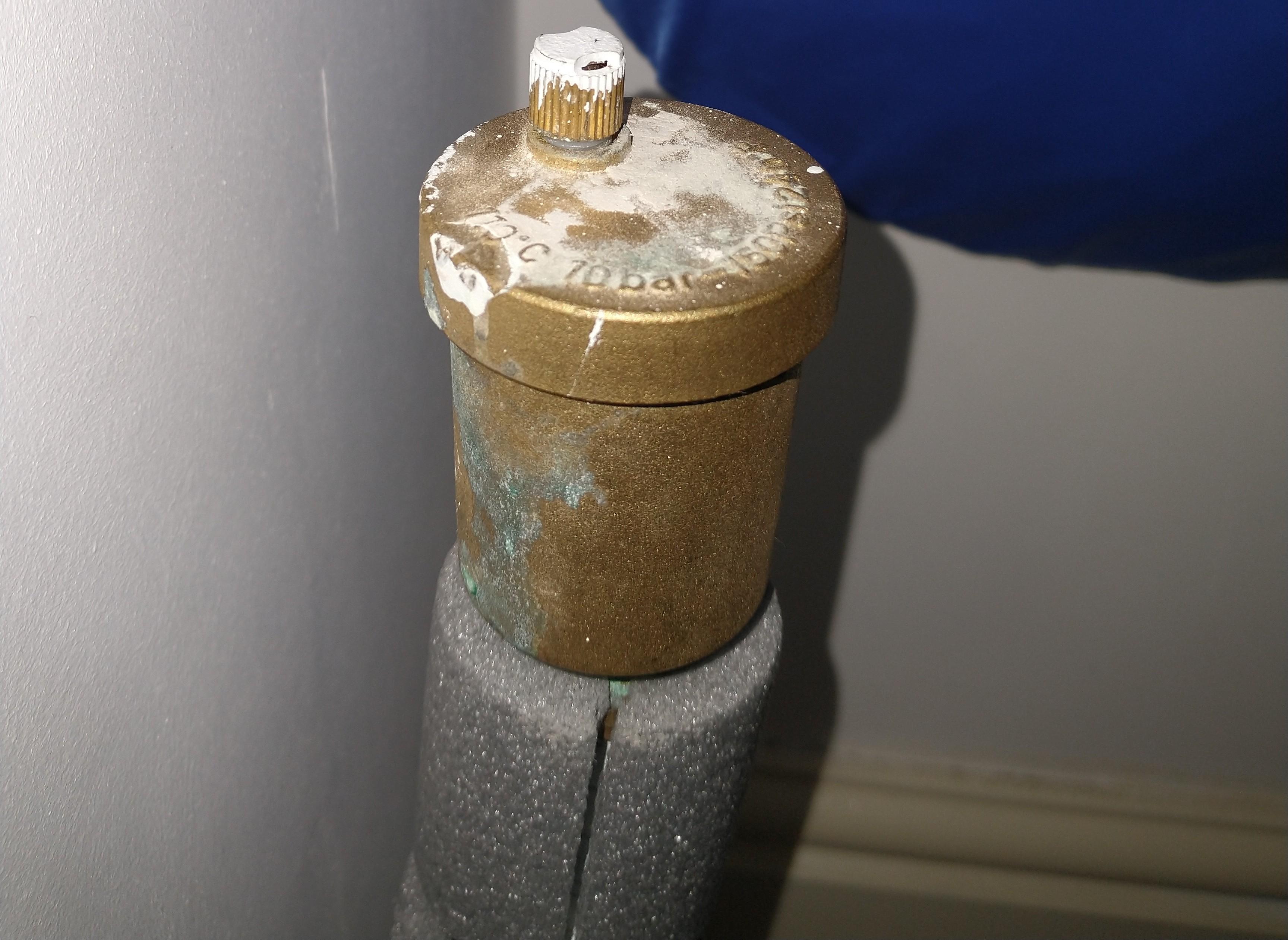

  8. The only sign of any leak I can find is this...I have no idea if this is a leak from when the system was Installed as the building is only 5 years old but does this seem like a continuous leak... enough to lower pressure every 2-3 months? Not sure.
