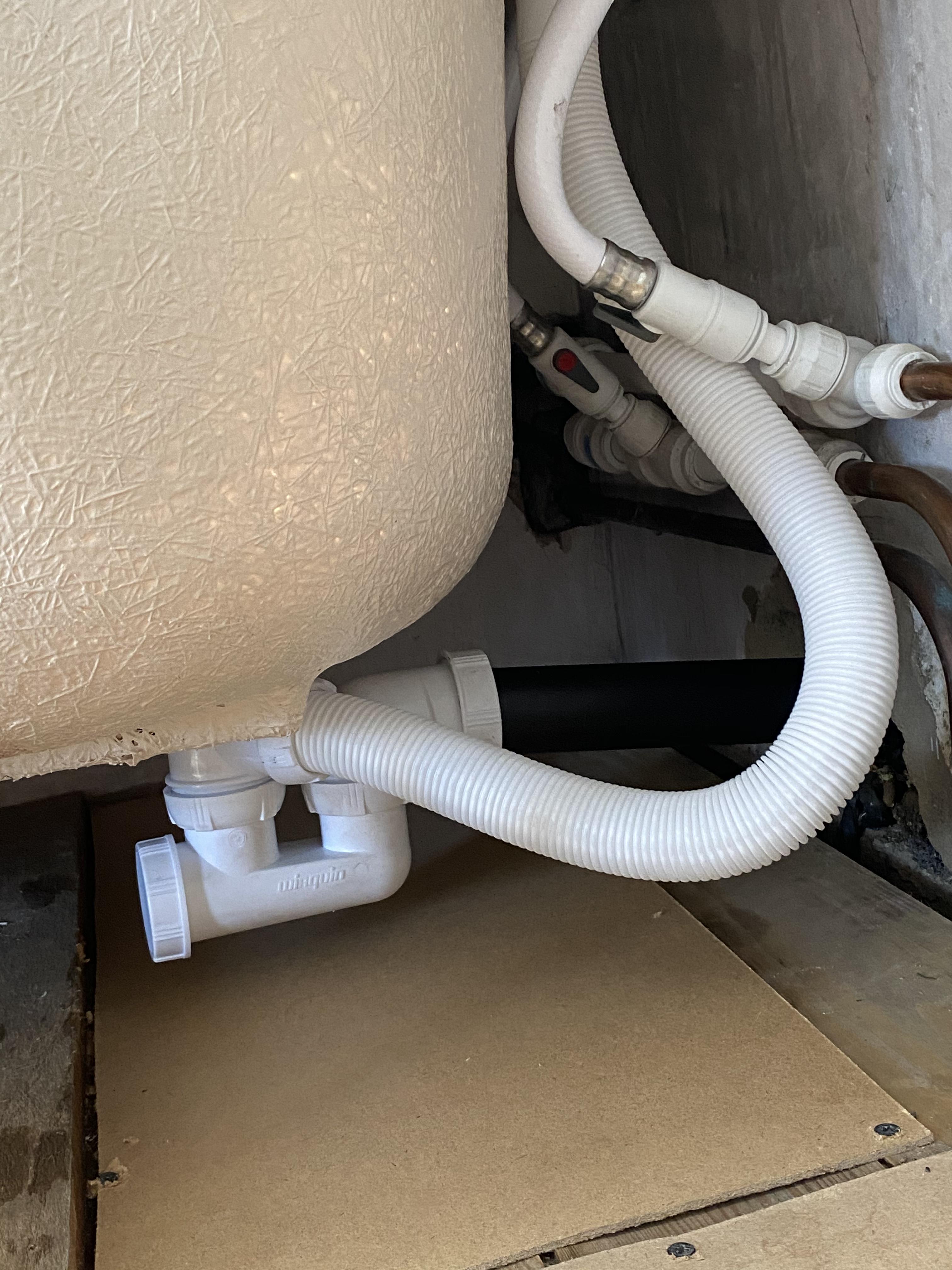

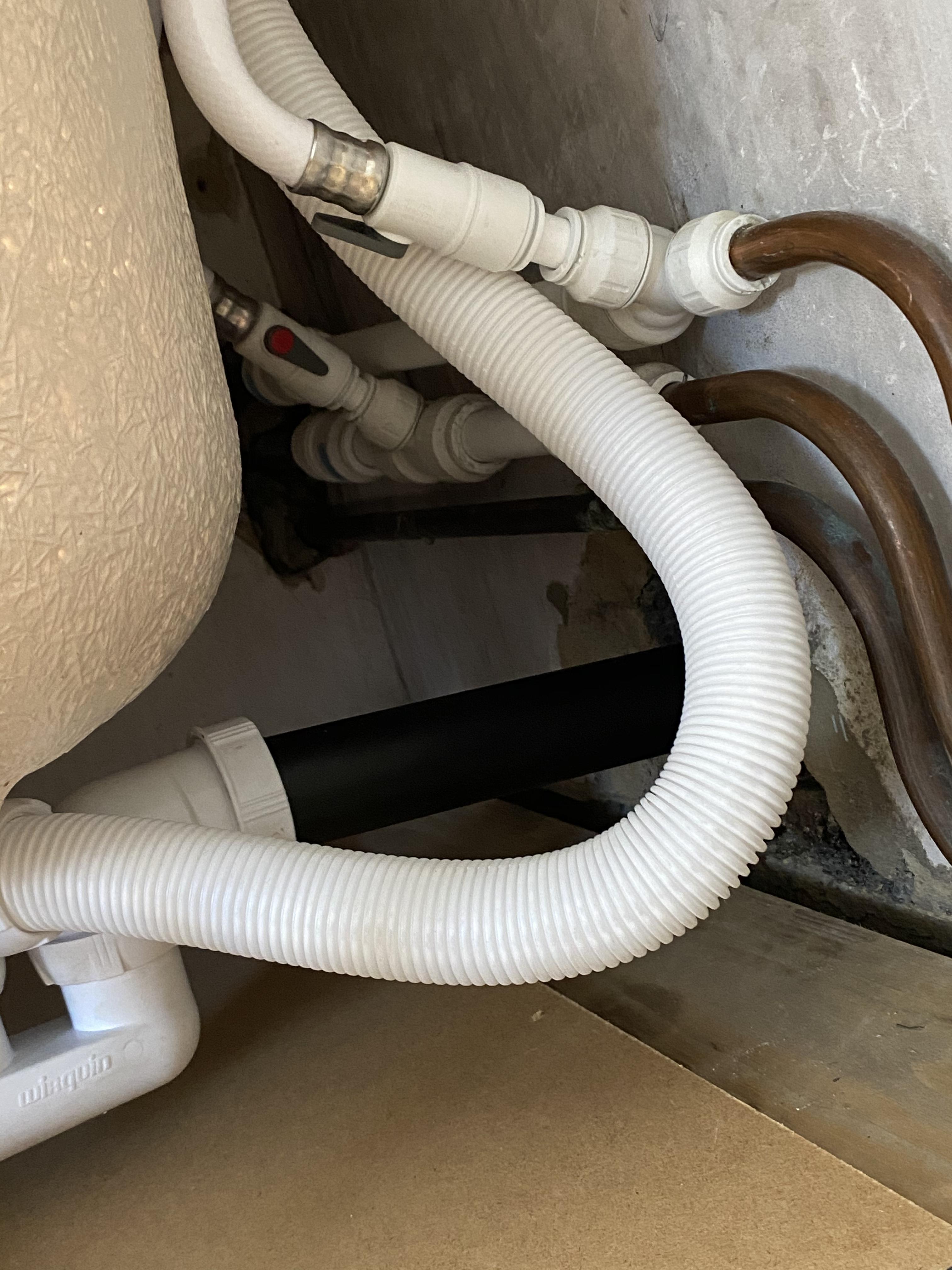

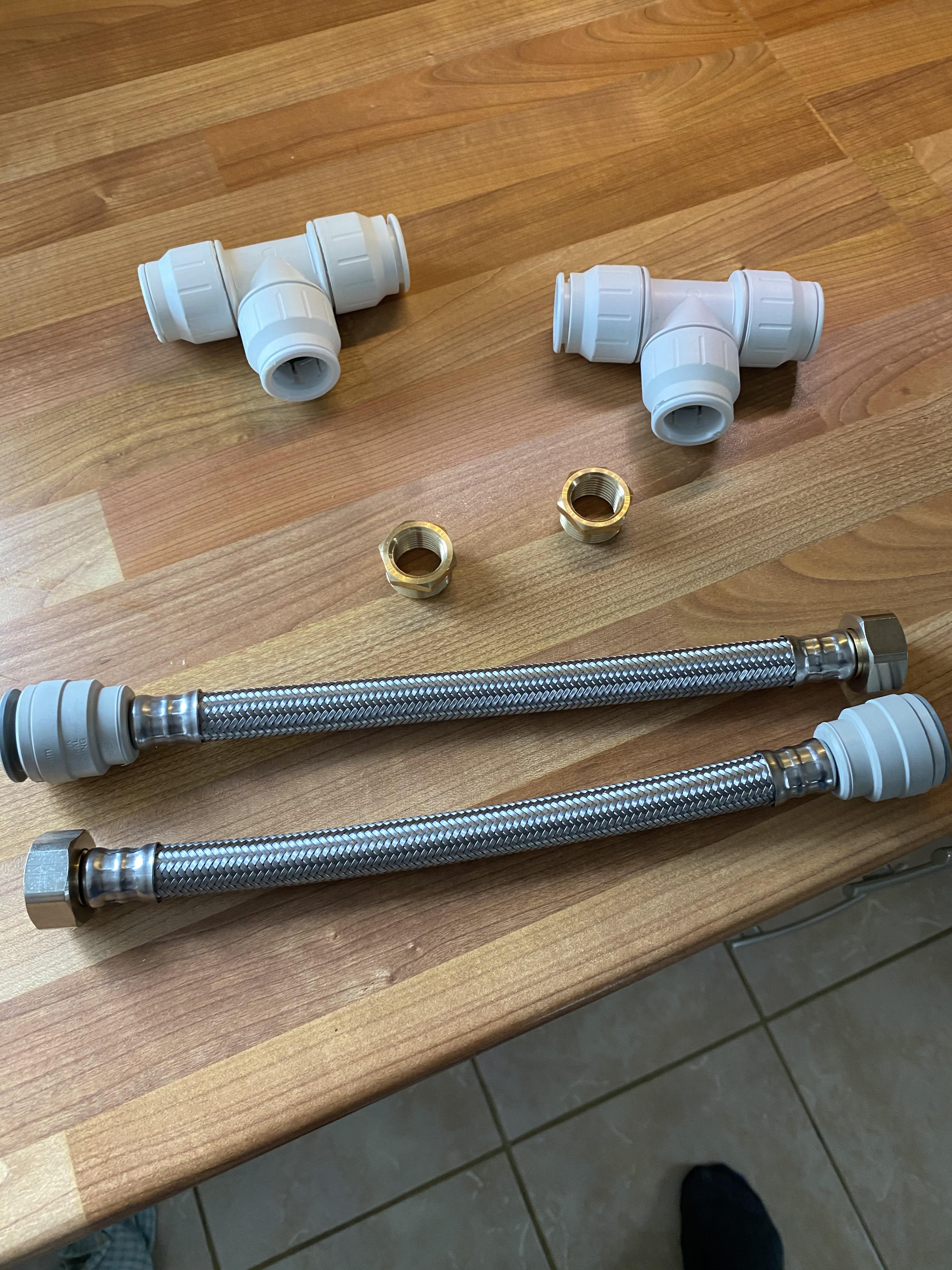

  5. Trying my best to do as much myself as possible so excuse the silly mistakes I’ll be making along the way. Just fitted a new bath and am mid bathroom renovation. The bath Taps the wife chose upon fitting had 1/2 bsp tails, all I could get was 15mm to 1/2bsp tap pipe adapters not 22 to 1/2 bsp, so changed my pipe work accordingly (see pic) possibly not to my advantage. Anyway now, and probably obviously got lower pressure at the bath taps. Apart from buying new taps, re drilling the bath tap holes and replacing the pipes to 22 and 22 to 3/4 bsp fittings are there any other solutions or advice? Added some pictures but please don’t be to harsh, I thought I did well lol.. I can live with the slower taps but maybe do it now in case it annoys me..

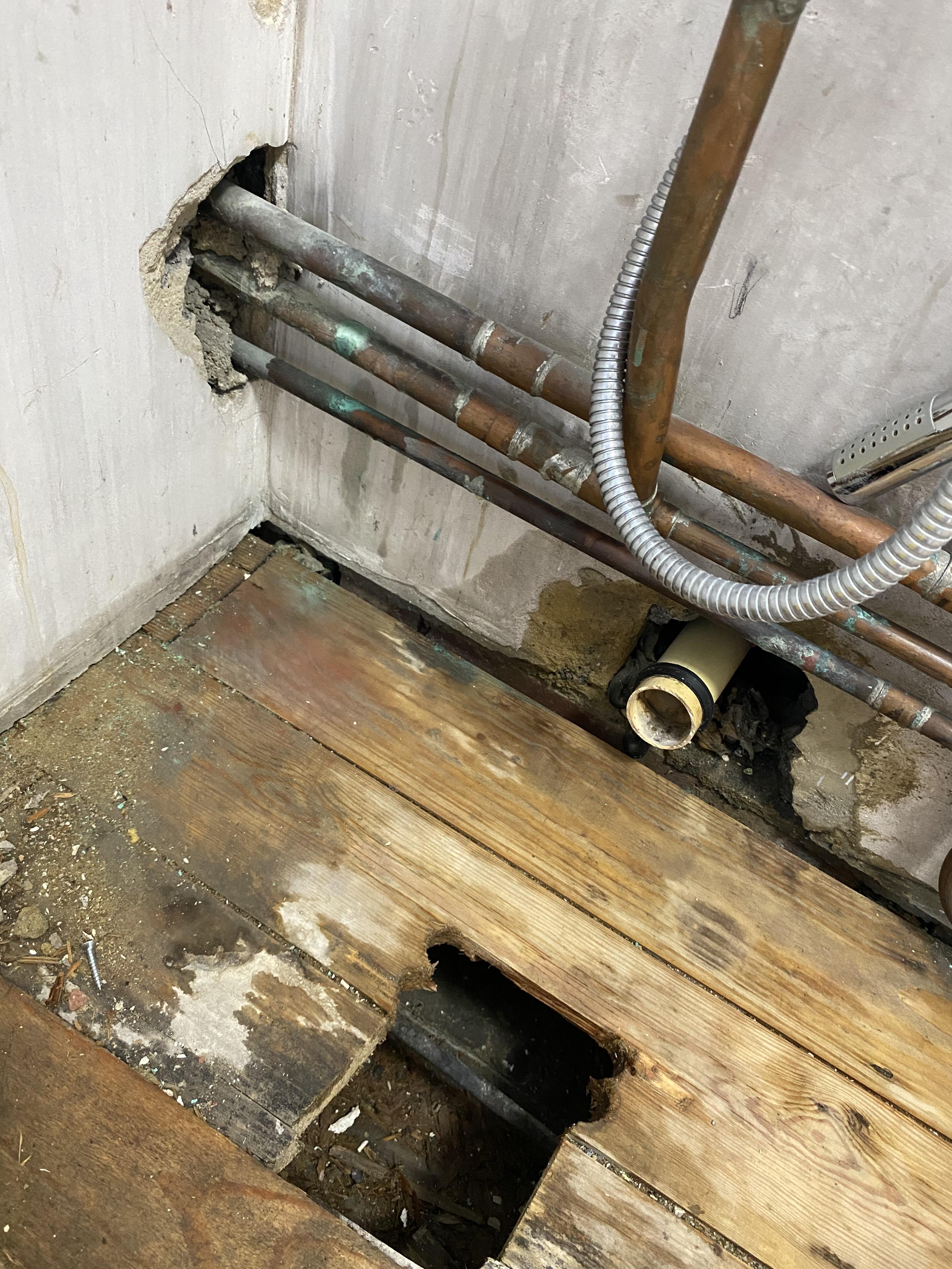

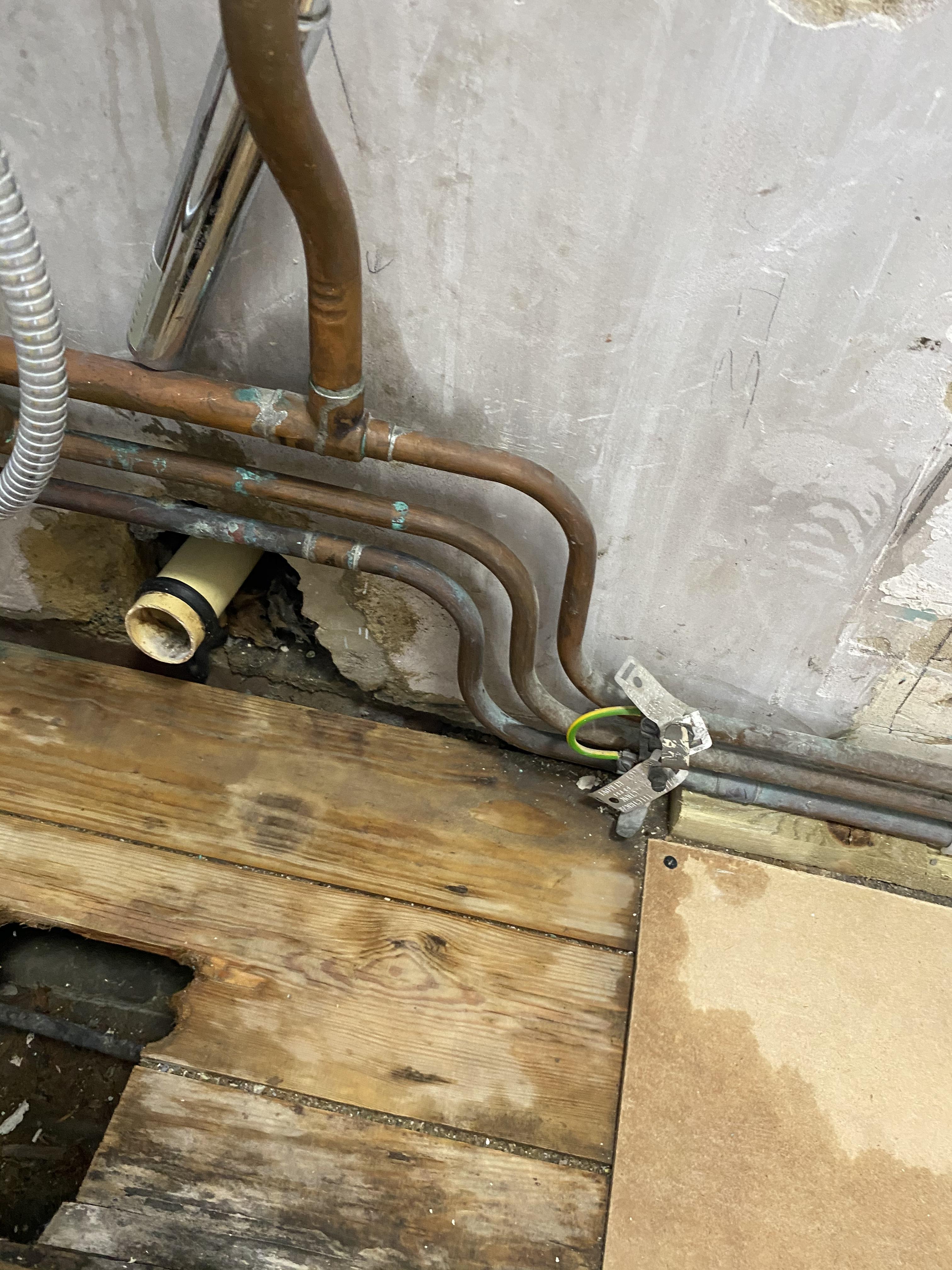

  7. Edited to correct spelling errors!! My internal soil stack collapsed under the concrete kitchen floor. Long story short decided to add new one from directly out the bathroom wall. Had the hole core drilled to accept waste pipe size and a little more, although the push fit junction fitting does not fit into this hole, only issue I have is that the soil pipe brackets are to short to meet the wall, do they do longer ones? Am happy for it to be away from the wall. Any other ideas?
  8. Think the stand offs Is a good idea.
  9. A plumber came and cut the hole for me and said it would be fine, it’s 5”. Perfect for pipe and was told collar shouldn’t go into wall, hindsight I’d have had it cut bigger but it’s a neat hole and really would like to avoid enlarging it. Zoom in on picture to see hole
