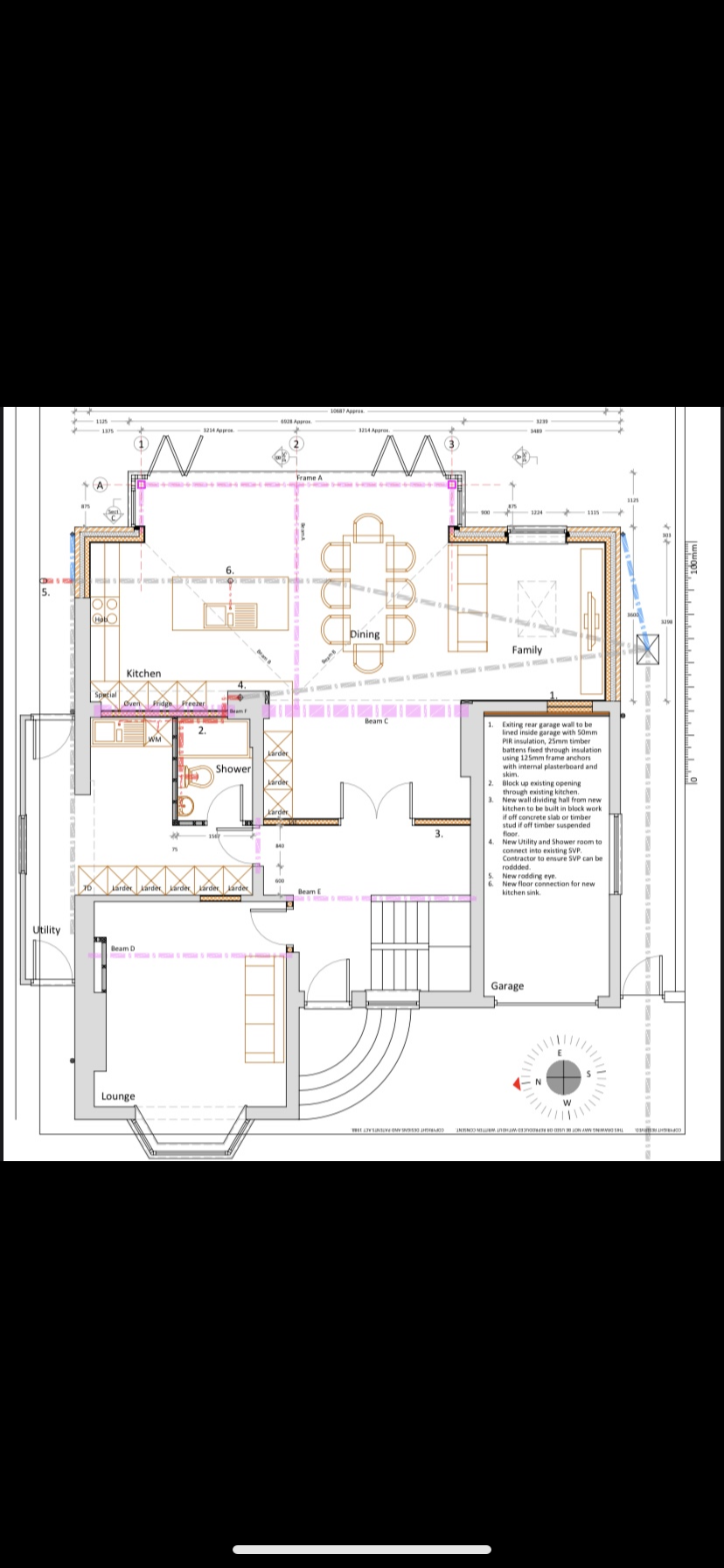

I’m not sure re the current extension as we have only lived there a few years and think the extension was built around 15yrs ago. We went through planning as changing the front & upstairs in phase 2. the bifolds will be almost 6.5mtrs.....I’ve attached a pic of the proposed new floor plan. as mentioned previously, the architect did plan for 15deg roof but when I chalked it out, felt we wasn’t gaining that much more to what we have now. I think the velux on the vaulted roof section should be ok hopefully but might need to do something with the one spanning out from the house. we currently have dreadnaught clay tiles on the house and ideally would like something similar if not the same but obviously I need to check they can cope with the 12.5 deg pitch -
Hi all, we are planning to have a rear pitched roof extension with centre vaulted ceiling & bifold doors. as I’ve never done this before, I’m trying to understand the steelworks; we already have 2 steels in the original house as a smaller flat roof extension has been added (which will be demolished and replaced by above) so our structural engineer has put the onus back on the builder to check they are adequate. At what point does the steel goalpost frame get built!? If we/the builder opts to do the traditional strip & fill footings, do the steels have to be set in these footings or is it a case of once they go off, build the steels off of them and then basically brick up around them? ive attaches a pic of the structural drawing as you can see a bit more detail of what we plan to do!

Thanks for the reply mate. The honest answer is I’m not sure regarding ground conditions; next door have recently done a flat roof rear extension and they used the traditional strip/trench fill foundations. It will be a solid concrete slab as is the current extension with the air bricks being sleeved through to the original suspended timber floor reference to door and window config; we are planning to have an 7 leaf bifold and 3 velux roof lights.....3 of the quotes we had didn’t include these! originally our architect spec’d a 15deg roof tile but we requested that it was changed to the min 12.5deg in order for us to be able to take it out a little further. -

All internals (plastering, flooring, tiling, electrics, gas etc) I plan to do myself-only thing I can’t do good is lay bricks. I don’t mind putting footings in but am a bit unsure about when/how to put the goal post steels in!? I live in the West Midlands. The budget of £30k is what I roughly guesstimated based on material costs etc. I appreciate there is some work involved in the steels etc but am more than willing to get stuck in and dig footings etc -
Good afternoon all, Newbie here - I stumbled across the website last night and have been looking on it since-lol I live in a 1950’s 3 bed detached house and have had an architect and structural engineer draw up plans for a 2 phase extension; the first being a rear single storey pitched roof with vaulted ceiling + bifold doors, and the second being upstairs above garage and double bay oak/oak clad (?) front bay. The plan is to start at downstairs internals then work our way up - phase 1 (downstairs) is the above mentioned rear (consisting of goal post style steels & 2 internal steels (8 in total)....n.b already have 2 steels in place in the house as it is as is already a flat roof extension!) the measurements of the new pitched roof extension is just over 12mtrs across & 5 mtrs out. I have had 5 quotes now for building the shell of the extension (up to sub floor & water tight-no internals) fitting 2 internal steels & building 1 internal wall.....not sure if I am being a bit delusional here but I was budgeting roughly 30k for this work but the quotes I’ve had back range from 52k up to 86k!! Does the 30k sound like I was being a bit apprehensive?? Because the quotes vary so much I now have no idea as to what is a sensible quote! Just to confirm; the biggest steel in phase 1 is 203x102x19kg Thabks in advance for your help and feedback
