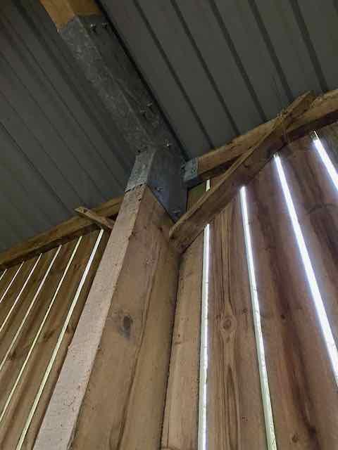

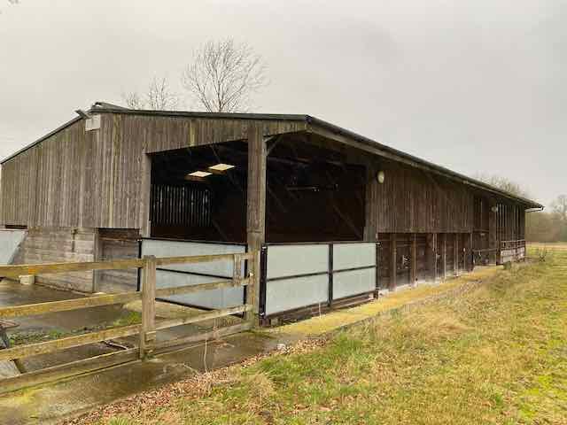

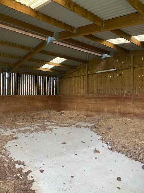

  6. Hi all, looking for some advice. We have bought a 27m x 10m x 4m timber framed steel roofed cattle shed that we need to take down to make way for a new self build. We have some big quotes north of 10k and 6 weeks effort to demolish. Actually I should say disassemble as I want to try and reuse as much of the timber in other project as I can. I've never demolished anything before so the answers are probably going to be don't be stupid, but looking at ways of saving money here, so perhaps there's something I can do to reduce the cost. My thinking is that I could remove the cladding from the outside that should be pretty simple, and remove the steel roof, they're in 5.5m by 1m (or so) sheets and are all screwed down. Again I think I should be able to remove these by hand and a scaffold tower, unscrewing and lowering the sheets down. That would just leave the timber frame. My first question is - if I remove the cladding and roof - will the timber frame stay up, or does it rely on the cladding for rigidity? The frame looks like a giant meccano set with galvanised connectors bolted holding all of the timber together. The timbers are huge in the roof 5.5m by 300m by 100mm so pretty heavy I'm sure. Also not sure how they fit together as they all seem to be totally interlocked together. I'm wondering if using a telehandler and straps and then unbolting one at a time and lower would work? But as they're all interlocked together not sure how you'd go about lifting them out. Any thoughts on how to tackle this? Also I know people buy second hand steel portal building but is there any market for timeber framed ones, all of vertical timber frame is set in the concrete based so assume it would need to be chain sawed and therefore significantly lower if reassembled - but do you think there'd be interest and where might be the best place to advertise it? Thanks
