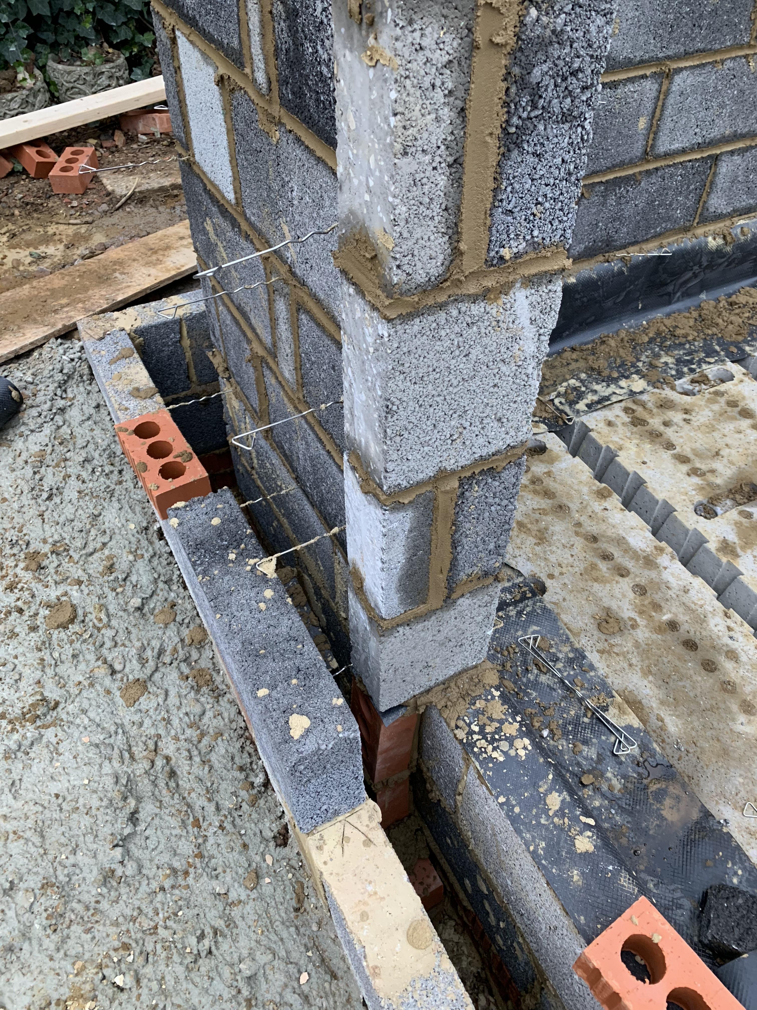

Cavity wall requirements around windows
Adamantium replied to Adamantium's topic in Building Regulations
There’s no wet plaster going on any surface on that picture. theres another layer of block work going on the inside which will be for and dabbed. as for the insulation, I gues they are making life harder for themselves but that’s their call. They seem to know what they are doing. -
Celotex I guess. why wouldn’t they joint the block work mortar? -
Builders decided to stick with architects plans and use NI design with a return. Cavity seems to have been dropped from 150 to 50 (might be 100 - I can’t tell). I’m happier with this as it gives the windows direct purchase on the block. Building control have confirmed they are happy. -

Hi all, Hopefully just a quick one here, but don't want to ask the officials yet. I have blockwork walls with a 150mm cavity. I am having sash windows fitted from the inside that butt up against the outer leaf whose opening is obviously slightly smaller. My windows are 126mm in profile so obviously the cavity extends beyond their depth. I believe 150mm cavity closers may be an option, but the architects have designed in a returning block that closes the cavity immediately adjacent the window down to 50mm. The architects are from NI, the builders on the mainland are concerned that this won't meet building regs requirement. I don't know if buildings regs are different in NI. Just want to know if anyone has seen a reduced cavity thickness around the windows for this purposes before? thanks in advance. Adam
